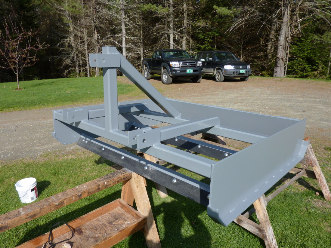

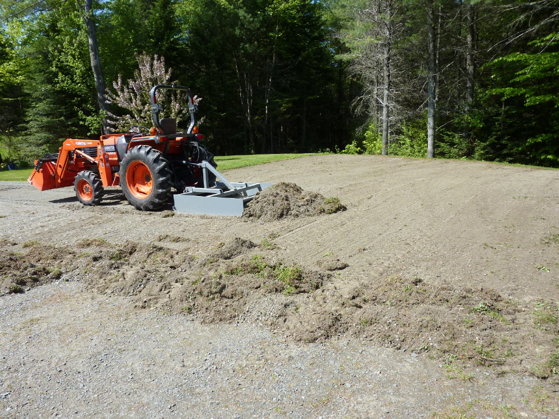

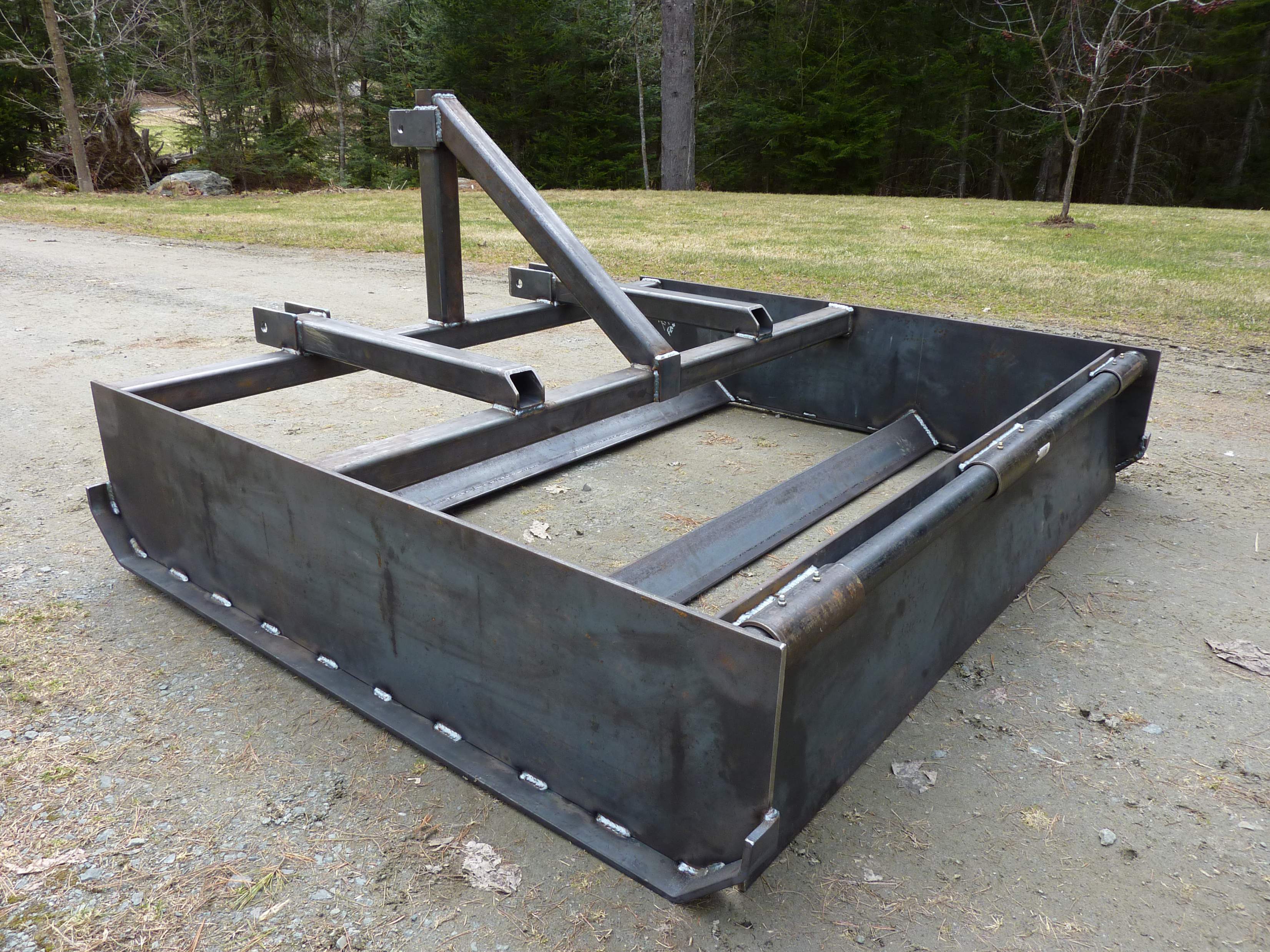

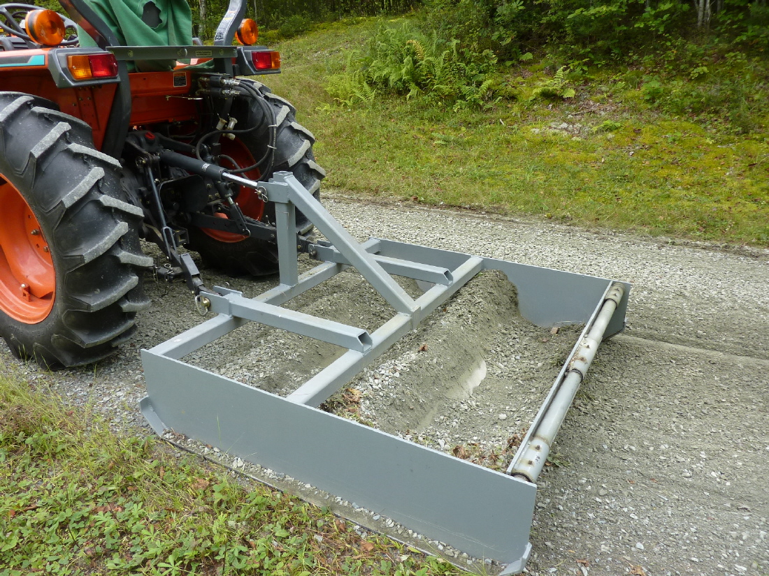

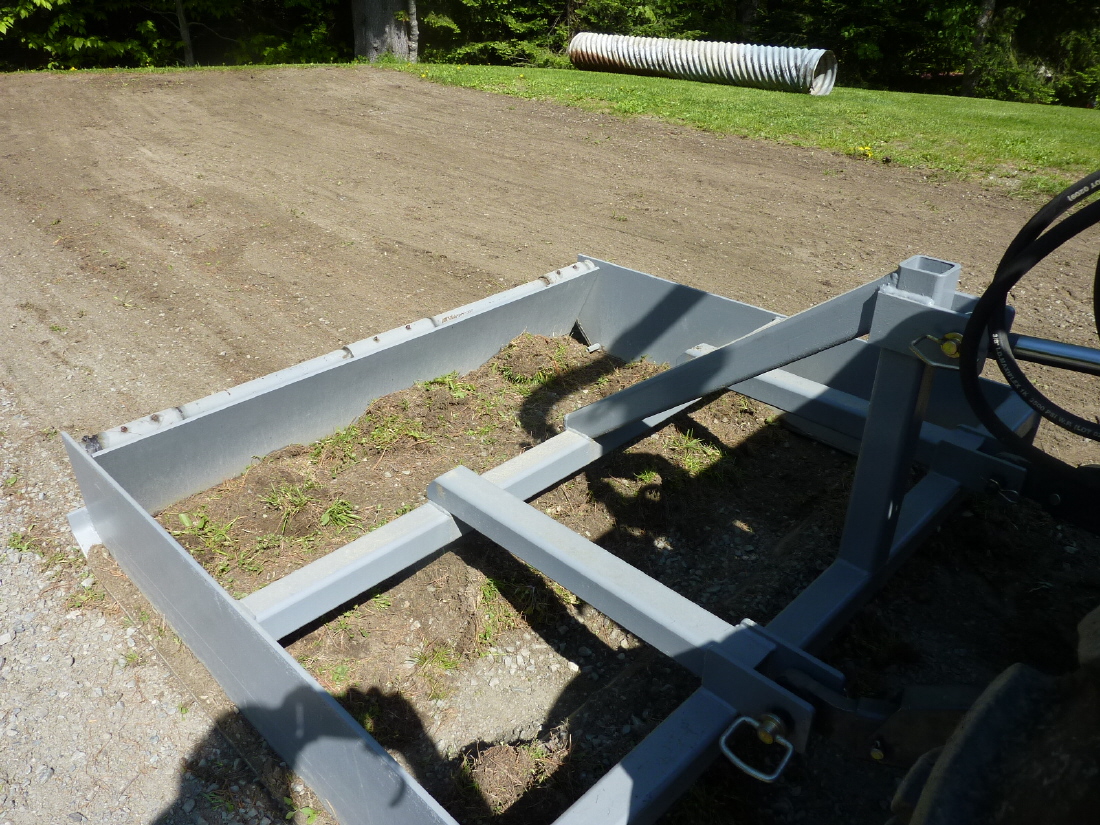

There is a set of stop pins the bottom of the gate hits against. The rear gate has three positions. I can have it up out of the way so material has clear passage. I can hang the gate behind the stops so it acts like a free drag but traps light material like sod. It also acts as a push blade in reverse. This is very useful.
Or I can hang the gate in front of the stops so I can collect material in the box and move it along the road like a box blade. I control the distribution with the hydraulic top link.

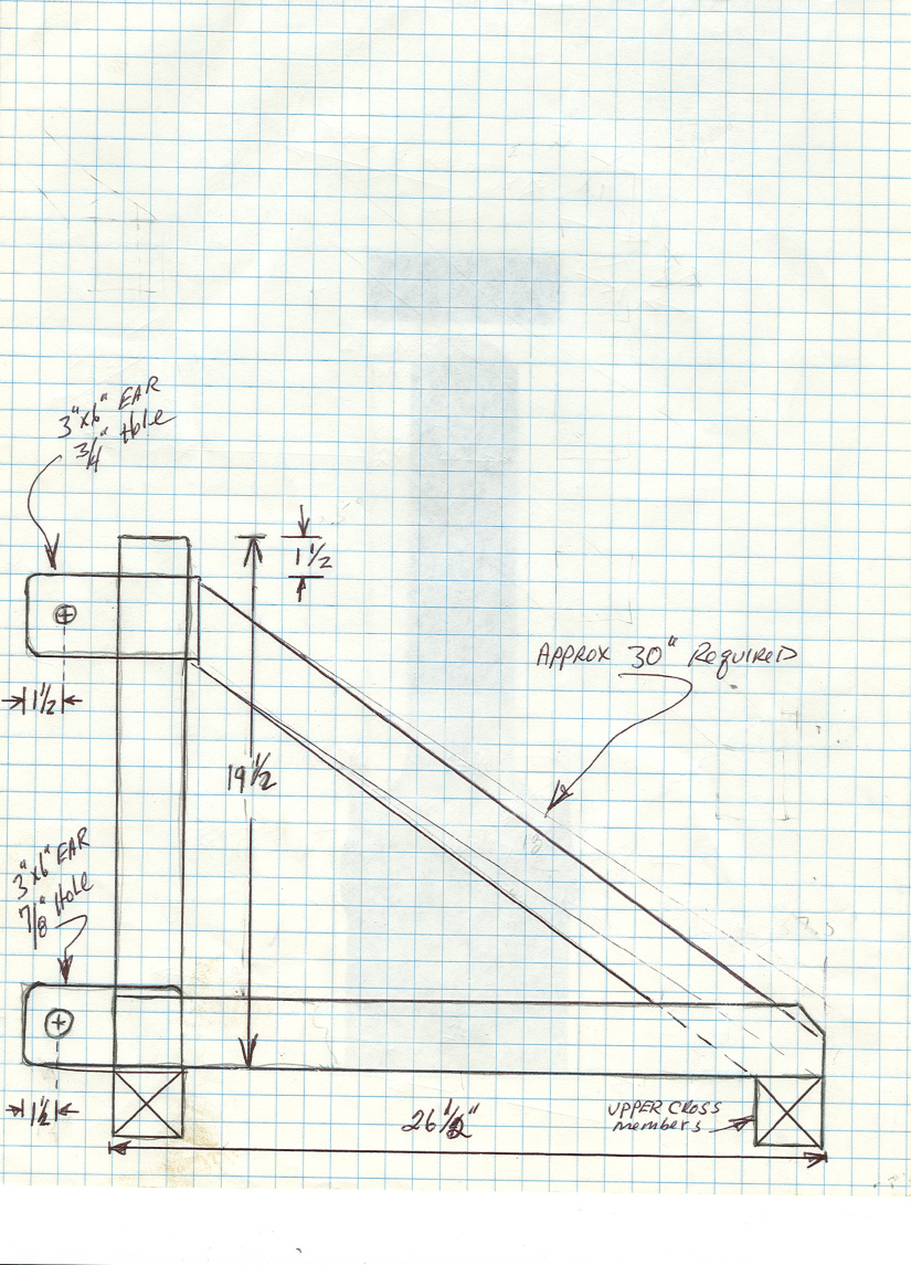

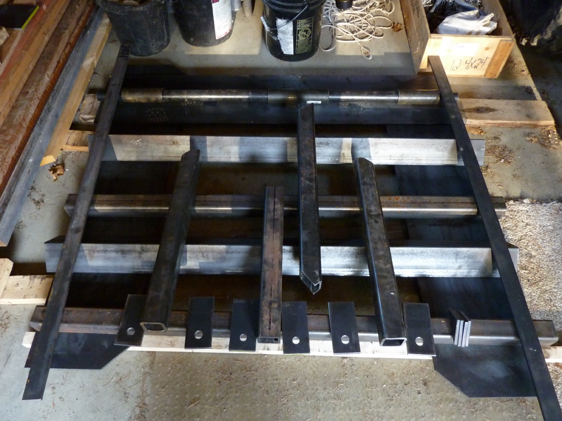

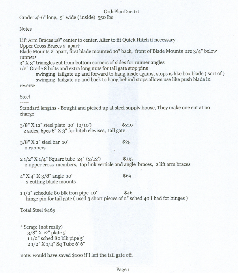

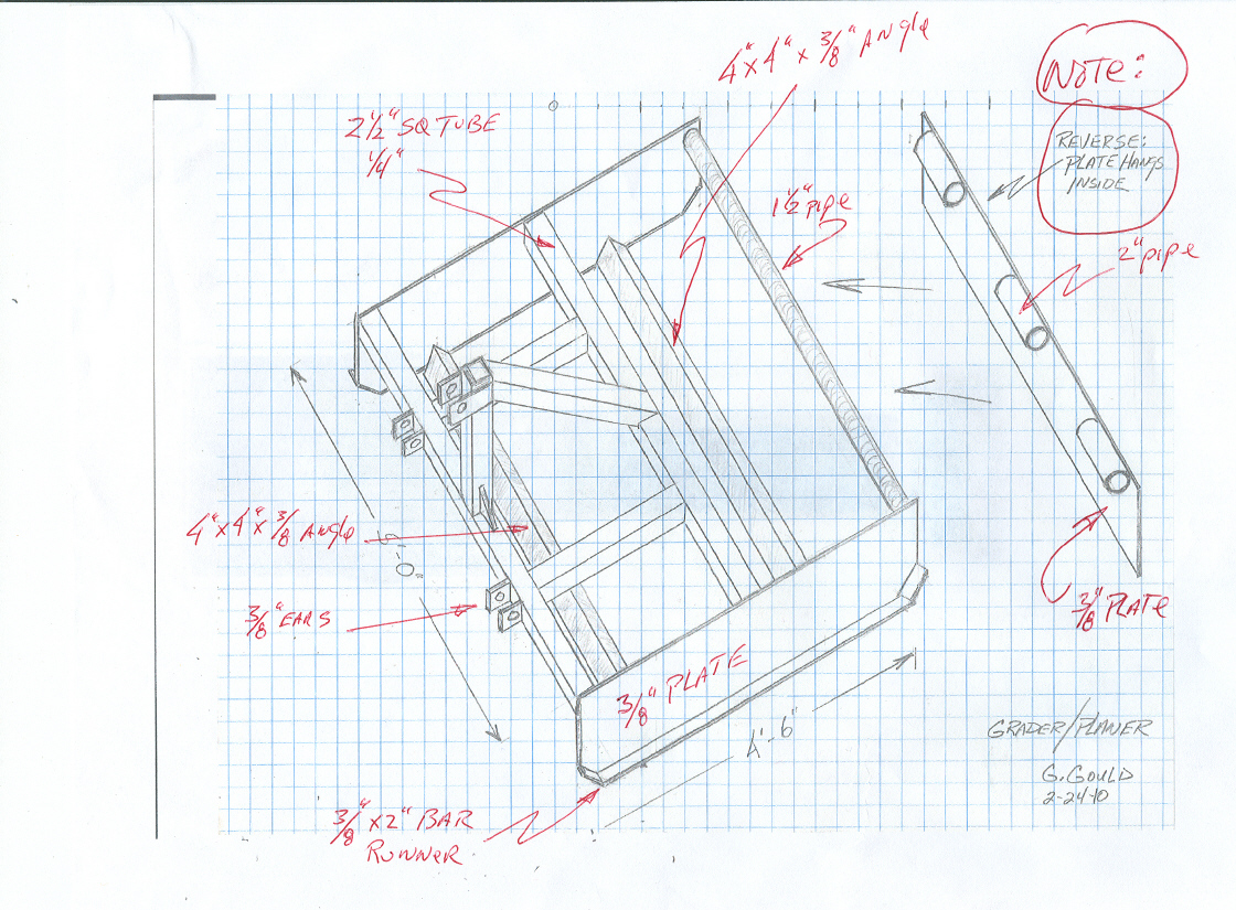

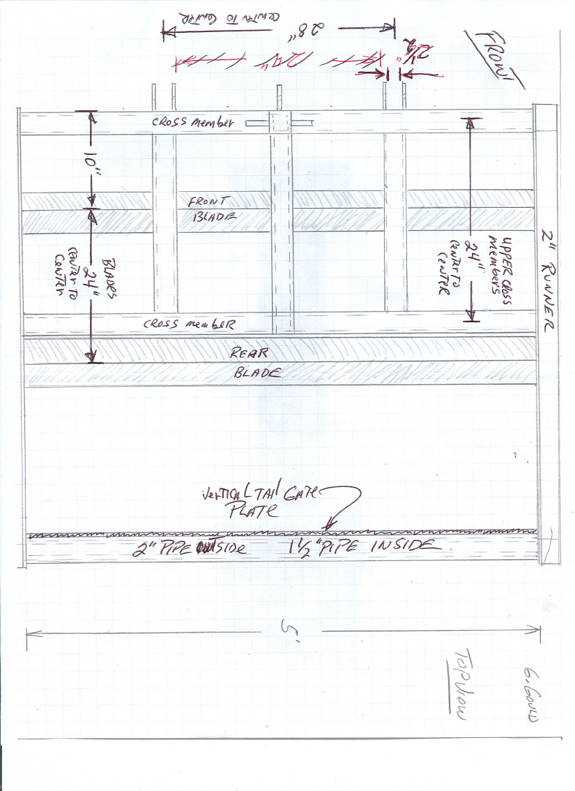

Here are my plans. I would look at others on here too. There are lots of good ones Look especially Jenkinsph (Steve's). He has some nice heavy builds. You need it to be heavy. Mine is 5' wide and 550 lbs plus the cutting edges - could be heavier.
Here are all the pieces after I cut them - ready to weld.
Basic plan. Note I did the lift arm attactments different from plan.
Side view
Top view

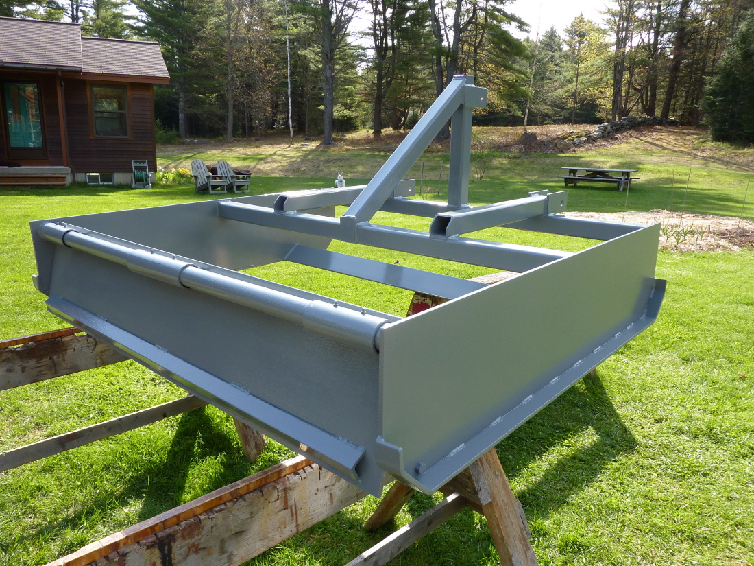

Finished job
After I typed all this I realized I should not have put this on the OP's thread. For that I apologize.
gg
Excellent job! Nice overall design. Are the skid shoes and cutting edges extra hard steel of a particular type?
Thank you. It is all mild steel except the cutting edges which are purchased cutting edges that would go on a blade. The runners are getting worn thinner. I will just weld on another layer when I need to I guess. Something harder would not hurt.

Top view
Finished job

Thanks for posting the plans .
Somehow the build $ will be much higher now I'm thinking.
