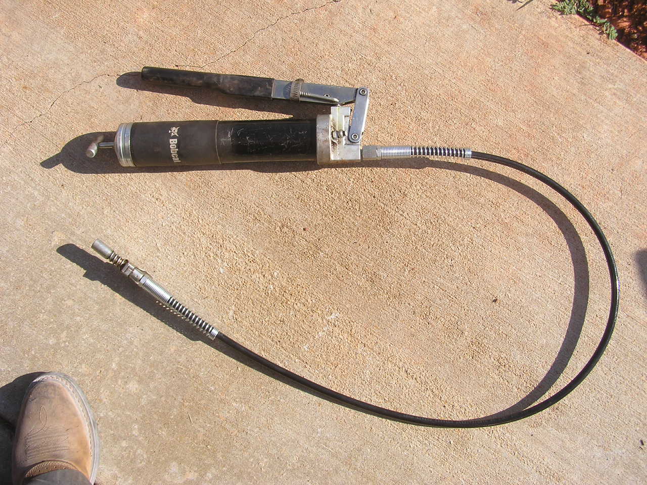

With a LockNLube you can put a hose on a lever gun.
Started short:
Went 4' long:
The advantage is that I can lock on the zerk, put the gun on my chest, both hands on the lever and pull to get the 10,000 psi output when needed.
   / Good grease gun needed!
#27
Crescent Tiger myself. Small world sometimes! :)

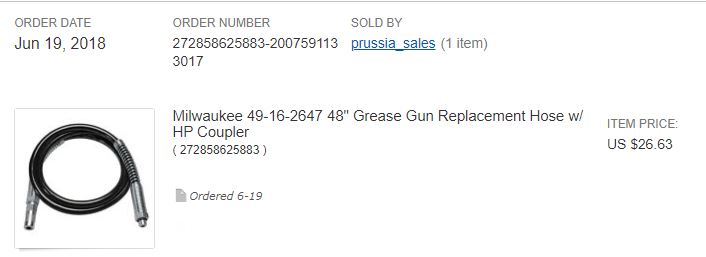

Must be a much better hose on that grease gun. The ones I used would 'swell' when I had a hard zerk. On the long one, I'd probably need one tube just for the hose!
   / Good grease gun needed! #28
Yep, small world. We used to live south of Cashion.
Don't remember where I ordered the hose from (probably eBay) but it was rated for high pressure grease guns.
Edit: Checked eBay order history:
It is a swell hose, but it does not swell. :D
