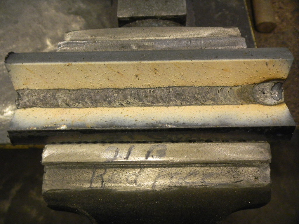

What happened to the "no slag" comment. Be gentle, just trying to understand. Thanks.
Well, Mig won't hardly give you any slag, but flux core wires will.
First picture Mig weld no brushing, (excuse the splatter, this was done with a 46 year old CC engine drive welding machine). Second pictures Flux Core self shielded.

Great - Pictures cleared things up. Both of those welds look awesome, might take me a few weeks to get that good :D
