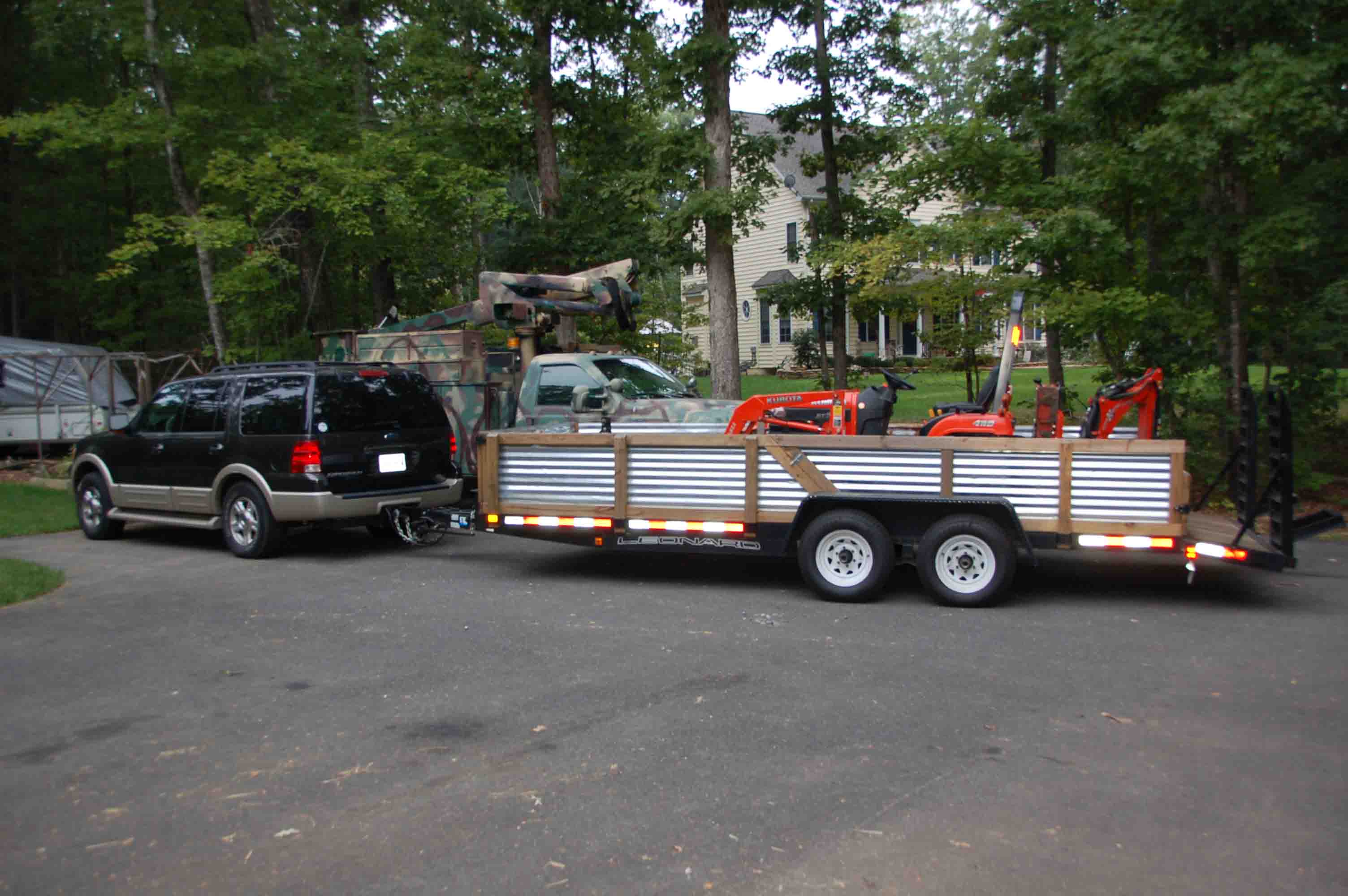

Pulling loaded trailers is serious business. Some folks just don't seem to get that.
In a good bit of planning on my part, my wife totally agrees that my next truck will need to be much more significant because of all the towing I do. Not that my Expedition is a bad truck for what I use it for, but a 3/4 ton Suburban would fit the bill a little better.
Nothing warms my heart more than a 1989 S-10 towing a 30' long travel trailer 70 MPH down the interstate without weight distribution or sway control. I get by him as quickly as possible...or let him stay WAY in front of me.

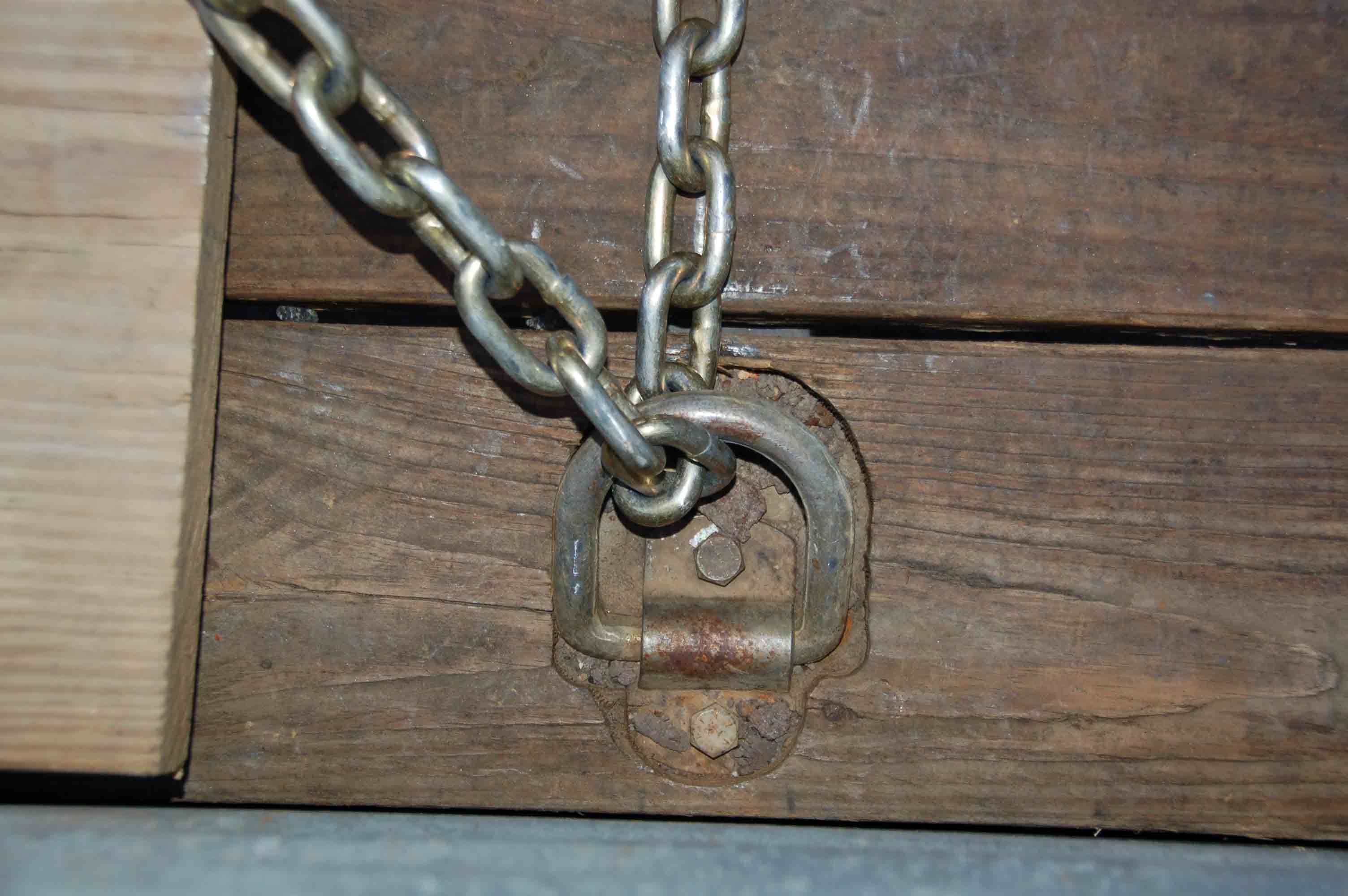

Looking at these pictures I can tell you that this guy has his tractor tied down better than most in Mississippi. I can't tell you how many times I have actually heard people say "The parking brake will be fine if you aren't going very far."
Not just Mississippi, I hear that around here as well.
Note, tie down rings into a wood floor ARE NOT to be used for equipment. Landscaper I know was telling me about getting a job because the previous bid winner had lost his skidsteer on a corner due to the tie down ripping out of the boards :eek:

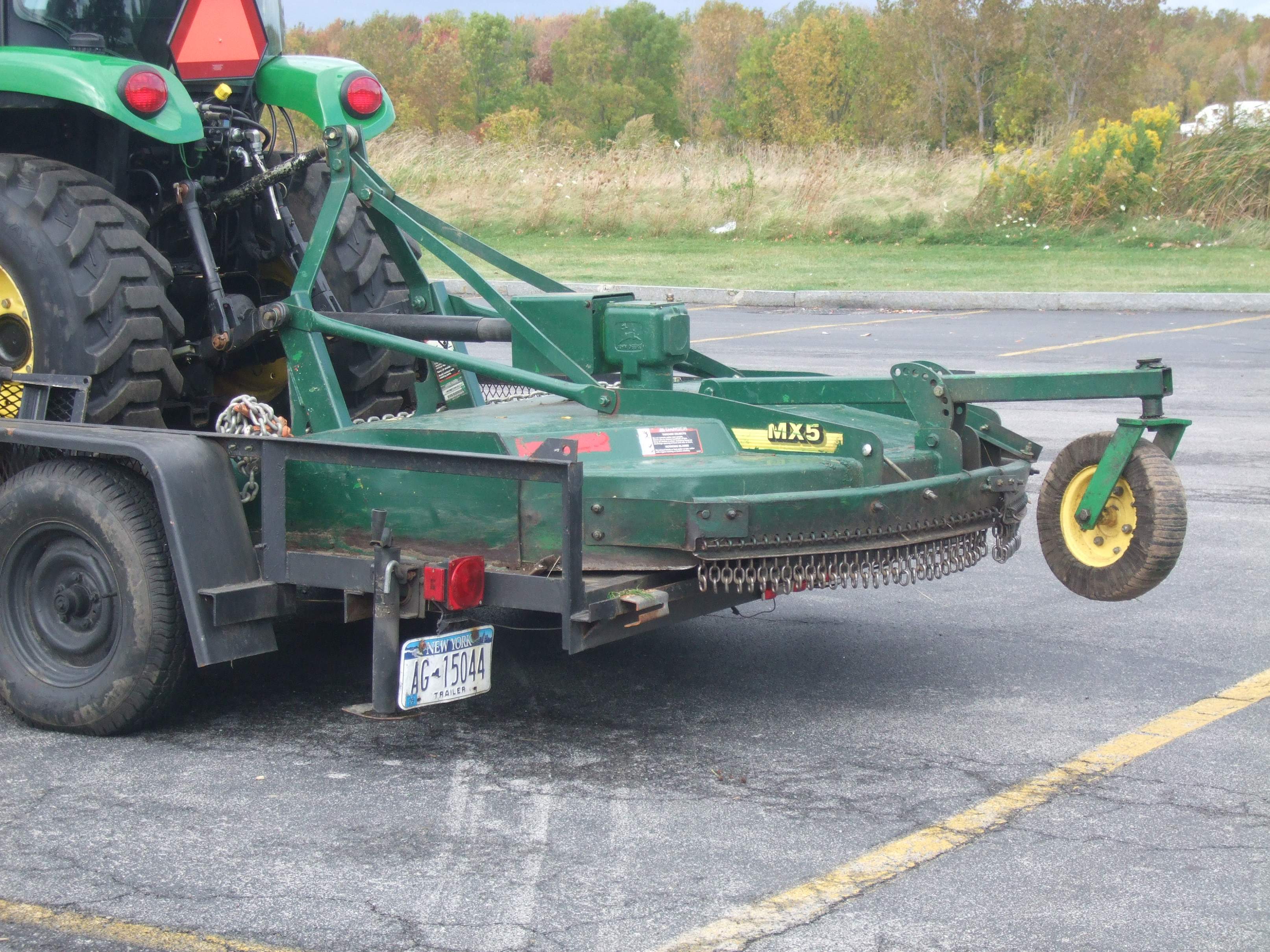

[A bigger issue is the way he has his ball mount flipped./QUOTE]
I fail to see what the problem is there. I have to do that on my trailer (5" up) and I'm normally over 1000lb tongue load.
BTW from your first post DP I realized you do actually fly a Diamond. I work for a large corpoated flight department as a mechanic.
   / Good job of chaining down your tractor? #38
X2.
If the ball was the other way, the trailer tongue would be practically scraping the pavement with the rear of the F-150 is sagging.
   / Good job of chaining down your tractor? #39
Oh, my mistake. I thought he was saying turning a ball mount over was unsafe. I'm of the mind they are the same rating either way.
   / Good job of chaining down your tractor? #40
Turning the ball over would help to level the trailer and reduce the chance of overloading the rear axle.
