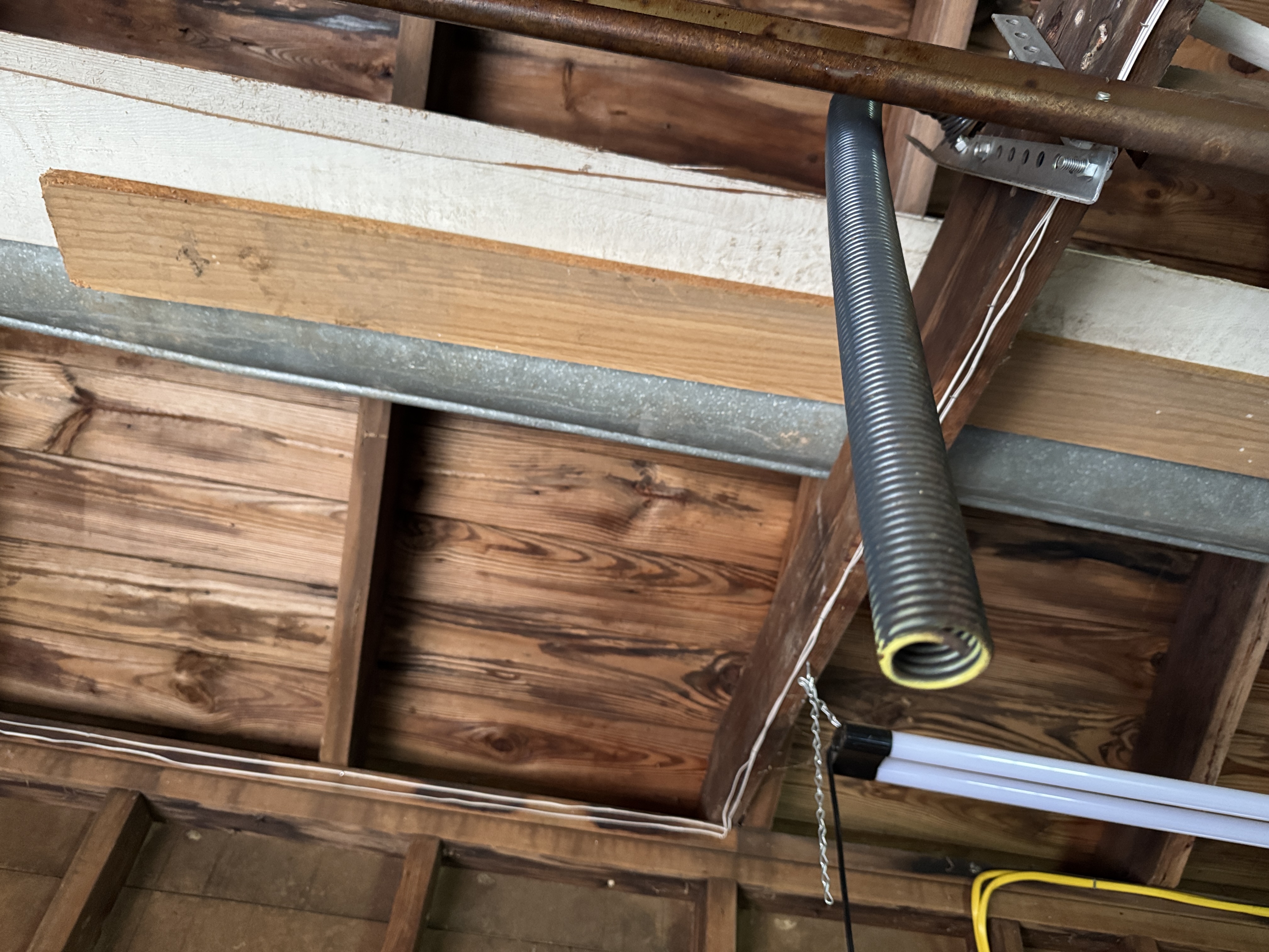

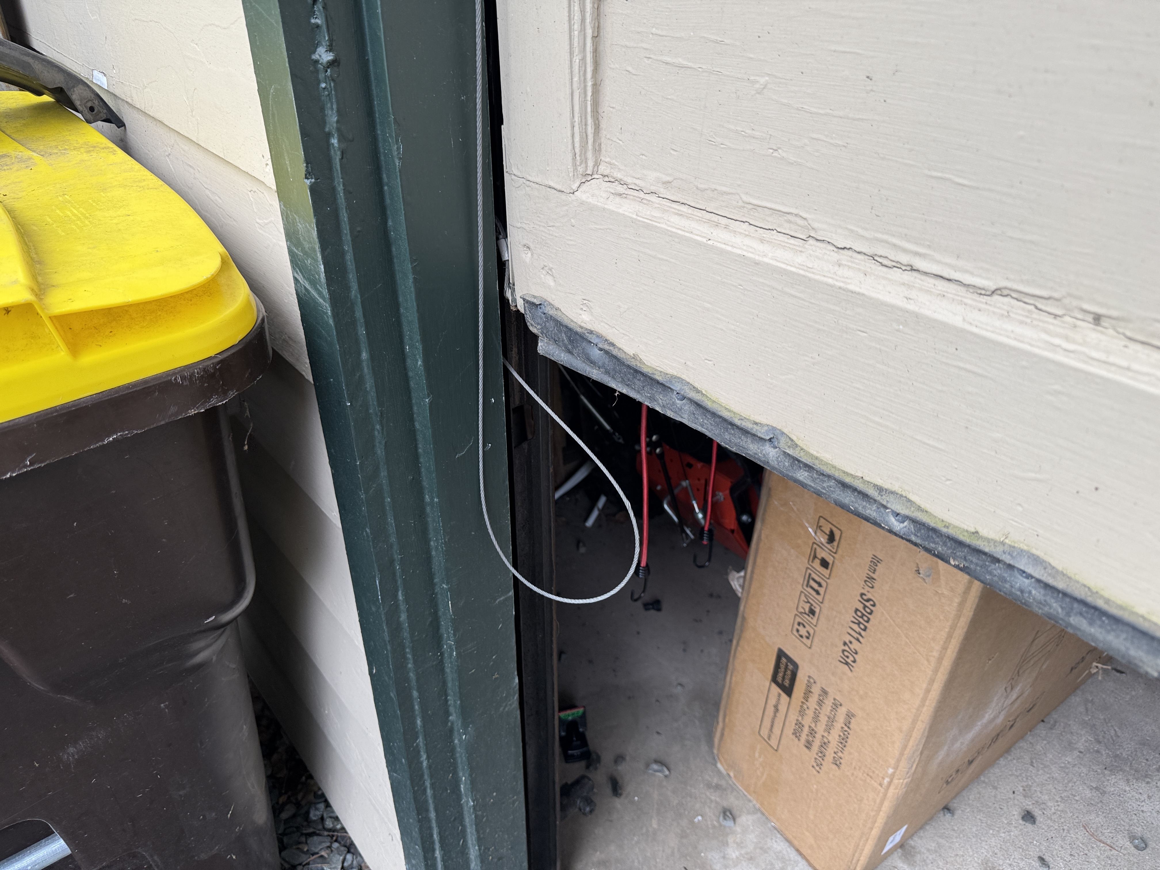

successful morning that did not end well, and it's only 9am......
garage took my air dam off, and then said no charge, just a little job.
joys of a small town...plus I buy gas there, and give them plenty of other work.
so happy about that I pull in to home and push button for garage door.
up it goes and huh? stopped a few feet up all cockeyed.
I took a closer look...hmmm, helper spring wire came undone, probably some kind of clip that holds wire
to the spring, I have no idea, never worked with this stuff.
guess I'll be calling the garage door place that installed it.
at least I was able to help it up half way to get in and see what was going on.
door then slid back down, guess I have it well oiled anyway.
not what I want to deal with today
because it's under tension, not sure I want to screw with it.

Drew, looks like your spring broke.

Drew, you just need a new pair of springs installed. Easy job.
Always replace both and do one at a time. Any garage guy can do this in 30 minutes or so, only took me that long to replace mine, and I'm slow.
Springs available on Amazon, yellow mark is the weight class for the spring.

That cable hanging in first pic is the cable that pulls the door open, with the assist of the spring, that is now broken. so one side broke, and the door is now cockeyed. the fix is make a phone call....

Be glad that door didn't come down while you were pulling in, Drew. I lost the windshield on a Porsche 912 that way long ago in my misspent youth. That was my first lesson on garage door springs, and threatening landlords with a lawsuite for maintaining an unsafe condition.
