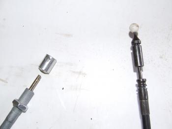

1st problem the Nimco joystick cable balls, see attached photo, will not slide into the metal block at the bottom of joystick, it seems like the ball is too large.
Cables are marked 4K 5049 5060
Should the cables be forced?
Do cables have protective plastic cap over steel ball that needs to be removed?
Any words of wisdom?

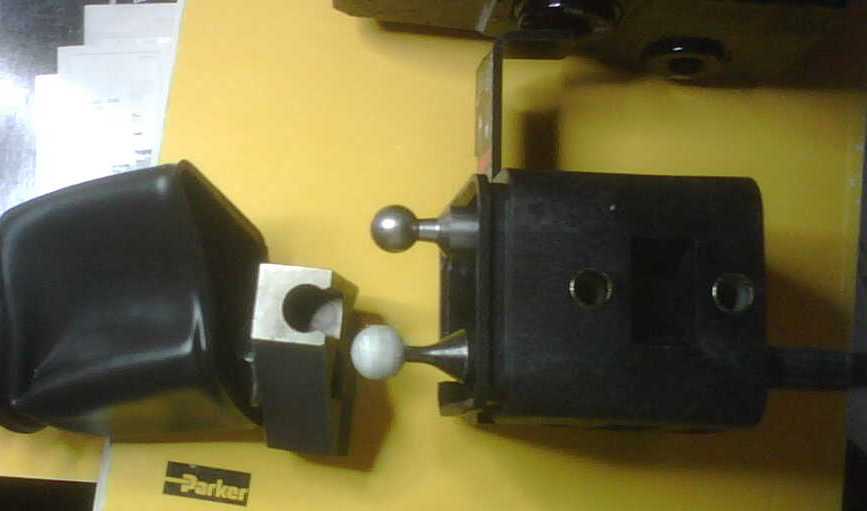

Attached is a photo of the cable to joystick connection.
The steel ball fits, the white plastic one doesnt....
