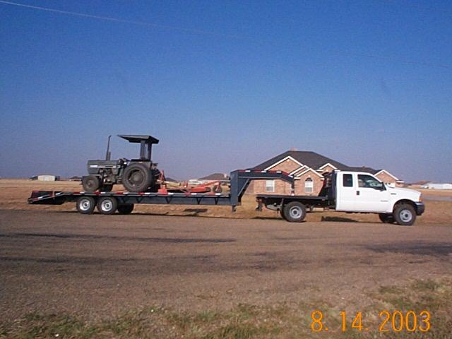

Hi Dave-
</font><font color="blue" class="small">( If I was to get a deck over gooseneck, will I have trouble loading my tractor with the bushhog attached?
)</font>
I don't think that you'd have any problem. Like so many other things, bigger is often better. I really like the deck over the wheels also. There are some things (like round bales of hay) that just don't fit between frame rails of low boy trailers.
The attached picture is the trailer I use to do some occasional mowing for friends. If I raise the bush hog, it does not hit the trailer as I back up the ramps. I back up so I can put the weight of the tractor over the trailer axles instead of over the truck bed. The trailer bed is 27' (22' + 5' flip ramps).
Mark
