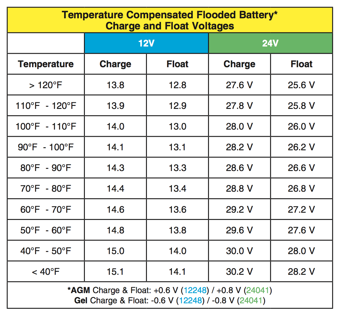

Actually, most brands of AGM batteries recommend charging and float voltages a little higher than conventional flooded lead-acid batteries. Gel batteries need charging and float voltages slightly lower than flooded lead-acid. The ideal charging and float voltages also vary with temperature.
Charging voltages from one of my favorite charger manufacturers:

charging(intermittent, short term) Yes, but NOT float voltages, look at an AGM battery for the recommendations.. 13.8 Volts float voltage, which means long term charging, like an automobile tractor etc. would charge the battery at for a long term.. Normal charging voltage for a car is about 13.9v to 14.4v
