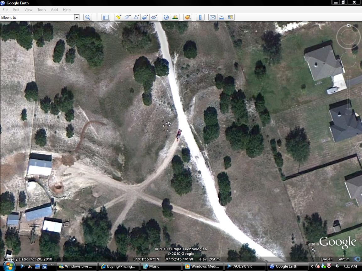

Don't download the 7 day trial of Google Earth Pro until you have some heavy lifting to do, because when the seventh day ends and your screen goes blank, you'll feel like Aladdin when they took away his magic carpet. It costs $400. to get it back for a year.
So why am I mentioning this on a tractor site? In the last week I mapped every field on the farm, calculated the acreage of each, and wrote a legal description from point to point using bearings and Lat and Long points, correct to 1'. I also generated a 25.5 Meg Photoshop map to illustrate the property for years to come, and all in a couple hours. When I got down to work with it, having those GPS points on tap was like having access to that other great mythical tool, the sky hook.
Work that would have taken a survey crew quite a while and cost a lot of money was completed for free in an evening in the kitchen. I dictated the property description to my wife as I ran the boundary lines and noted the heading and length of each.
So if you want to do some mapping of the back 40, you might want to try Earth Pro on a 7-day trial.

My son set me straight on the software. Turns out the free version of Google Earth will do the same things I value in the commercial version. So I get to keep my magic carpet/sky hook. Cool.
