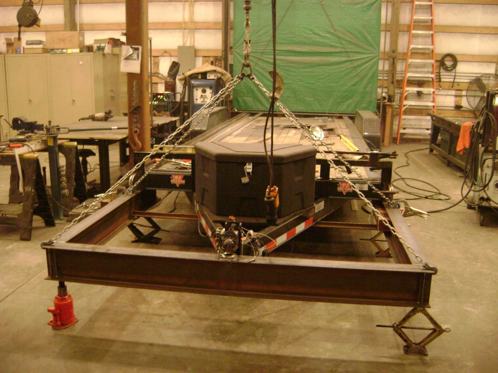

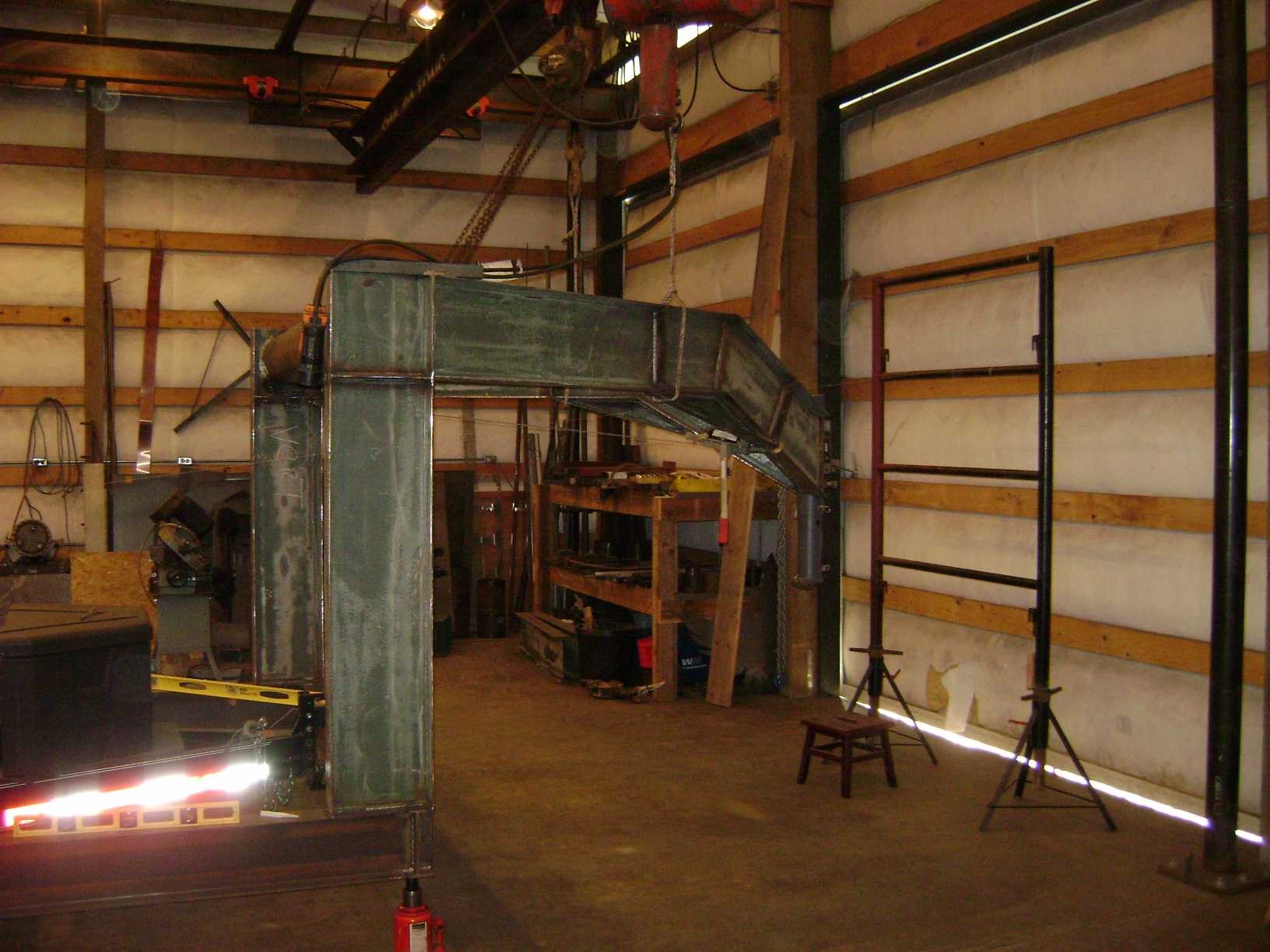

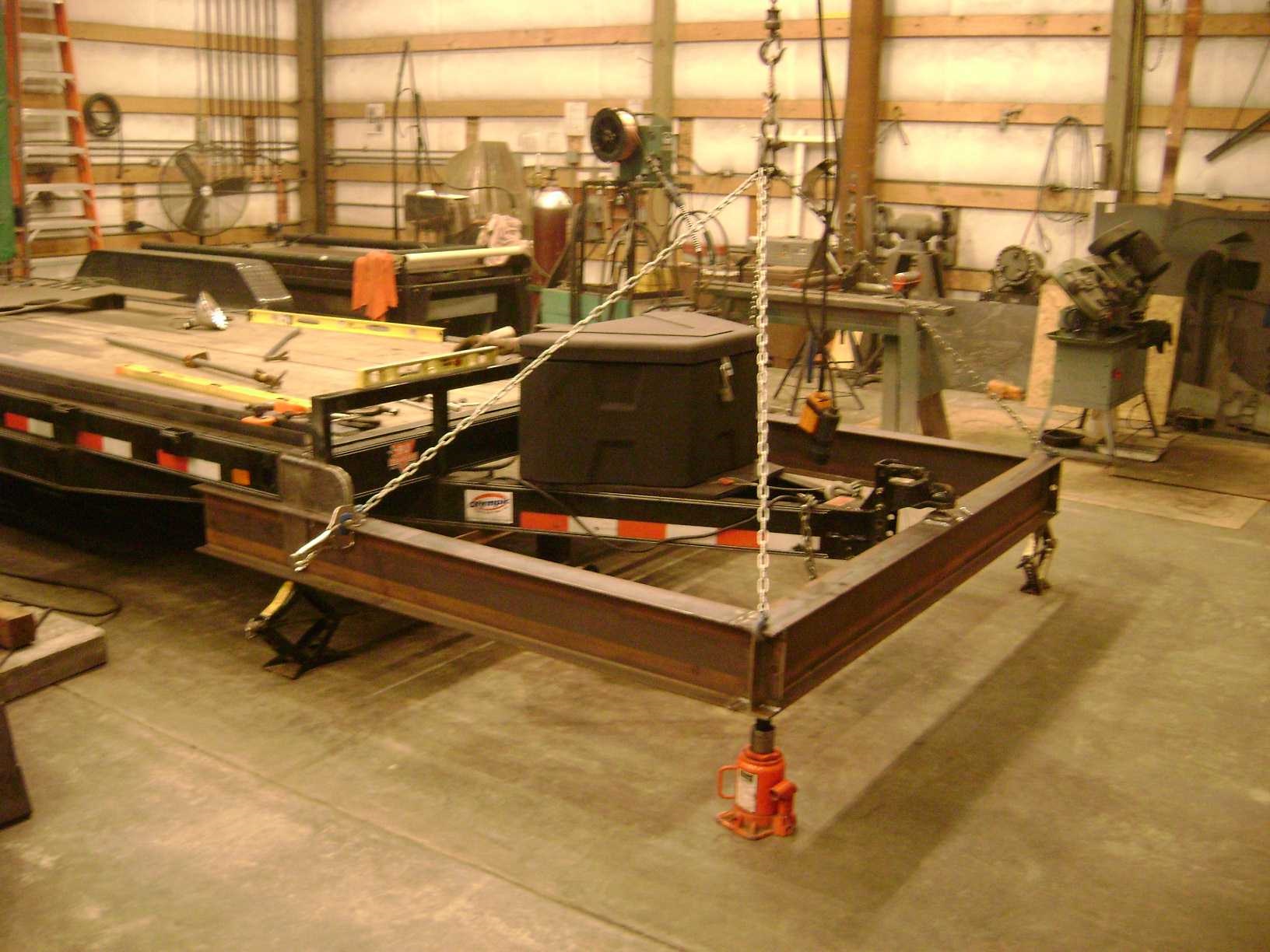

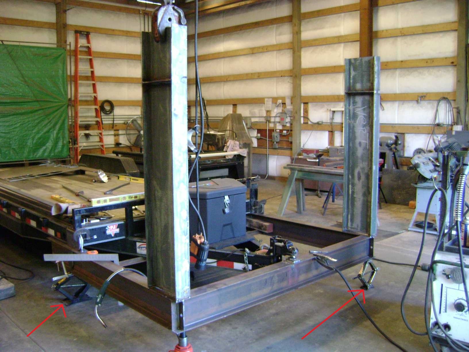

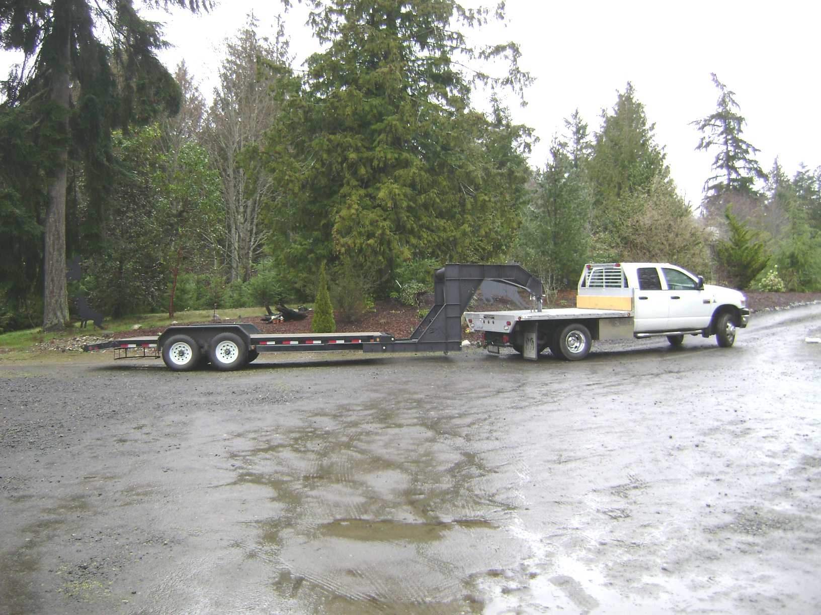

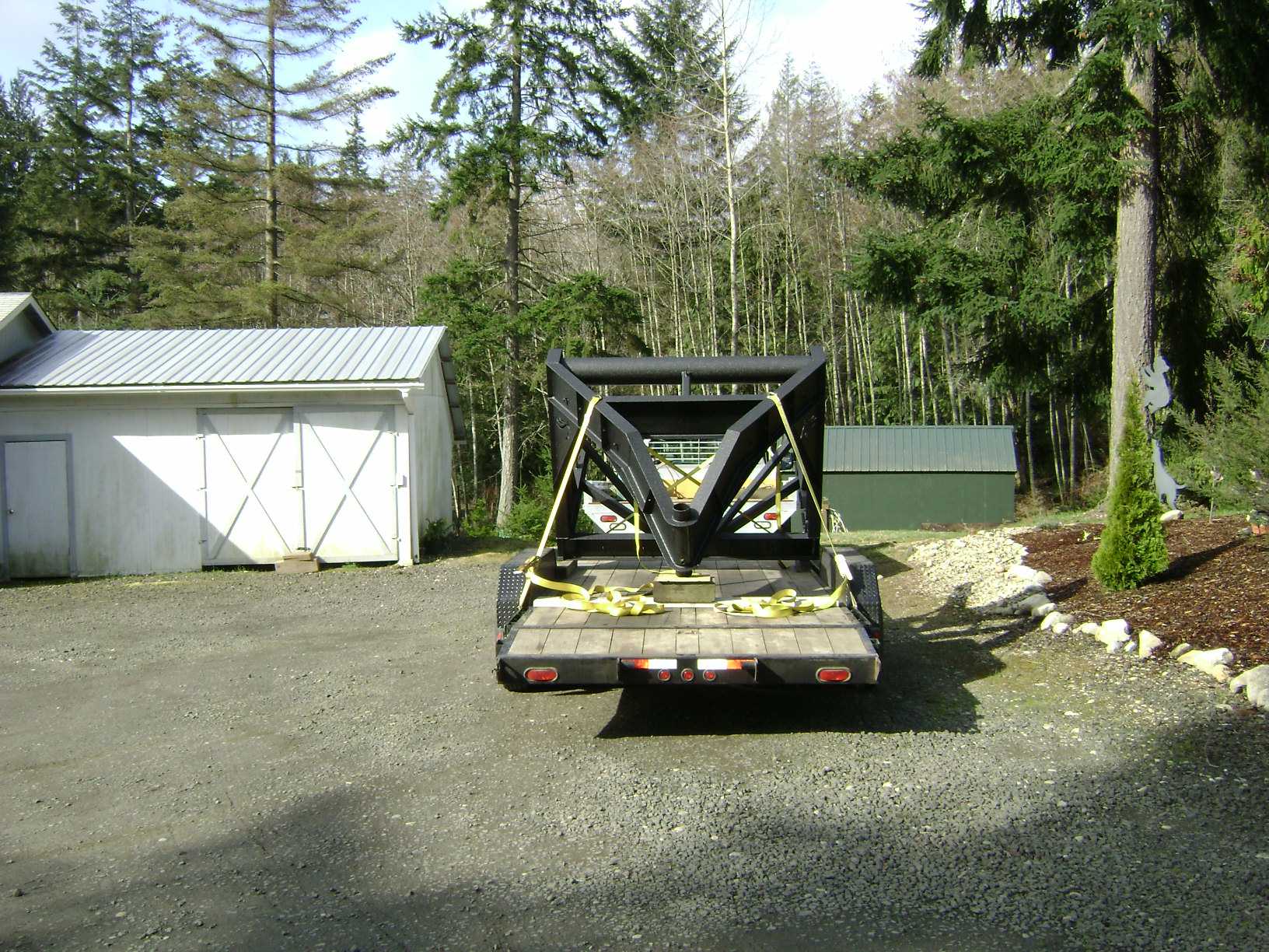

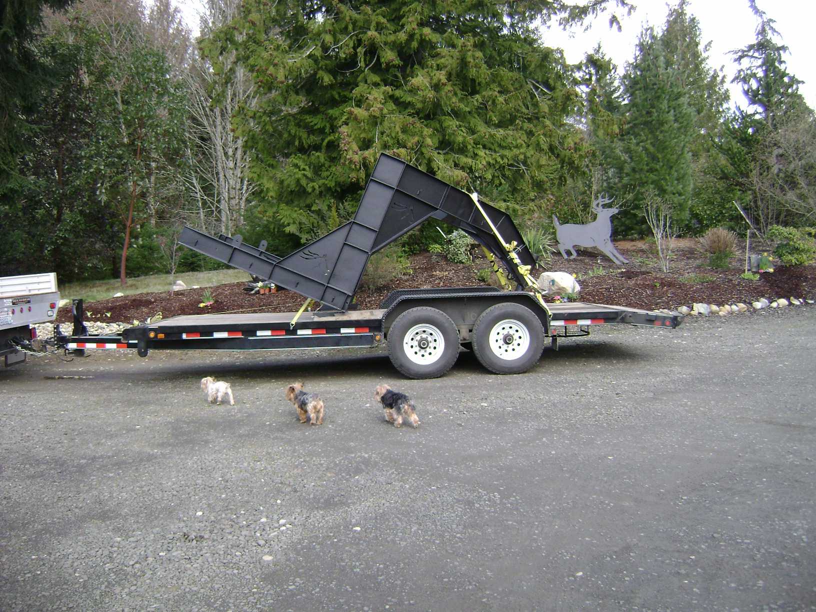

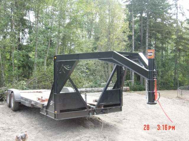

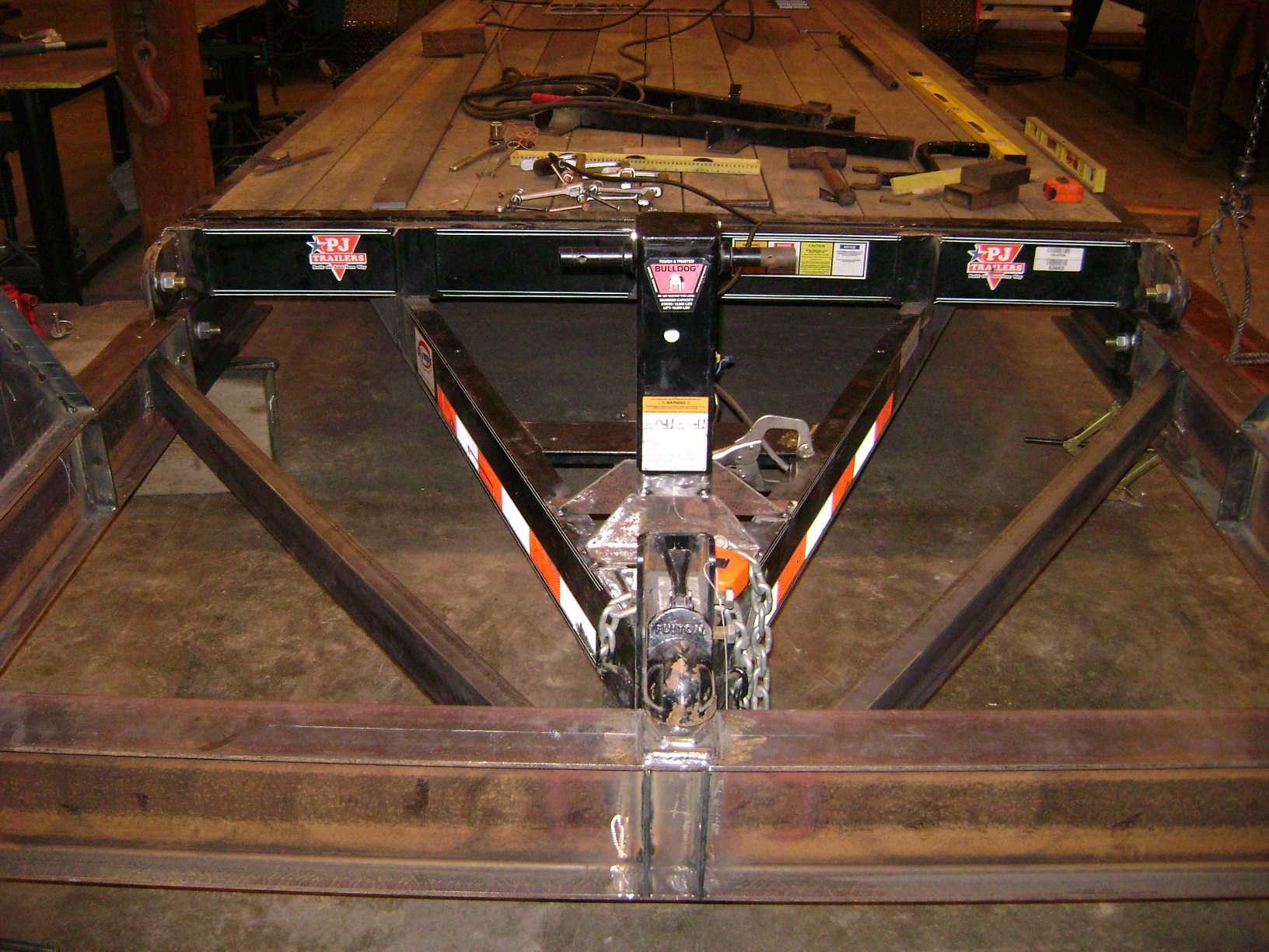

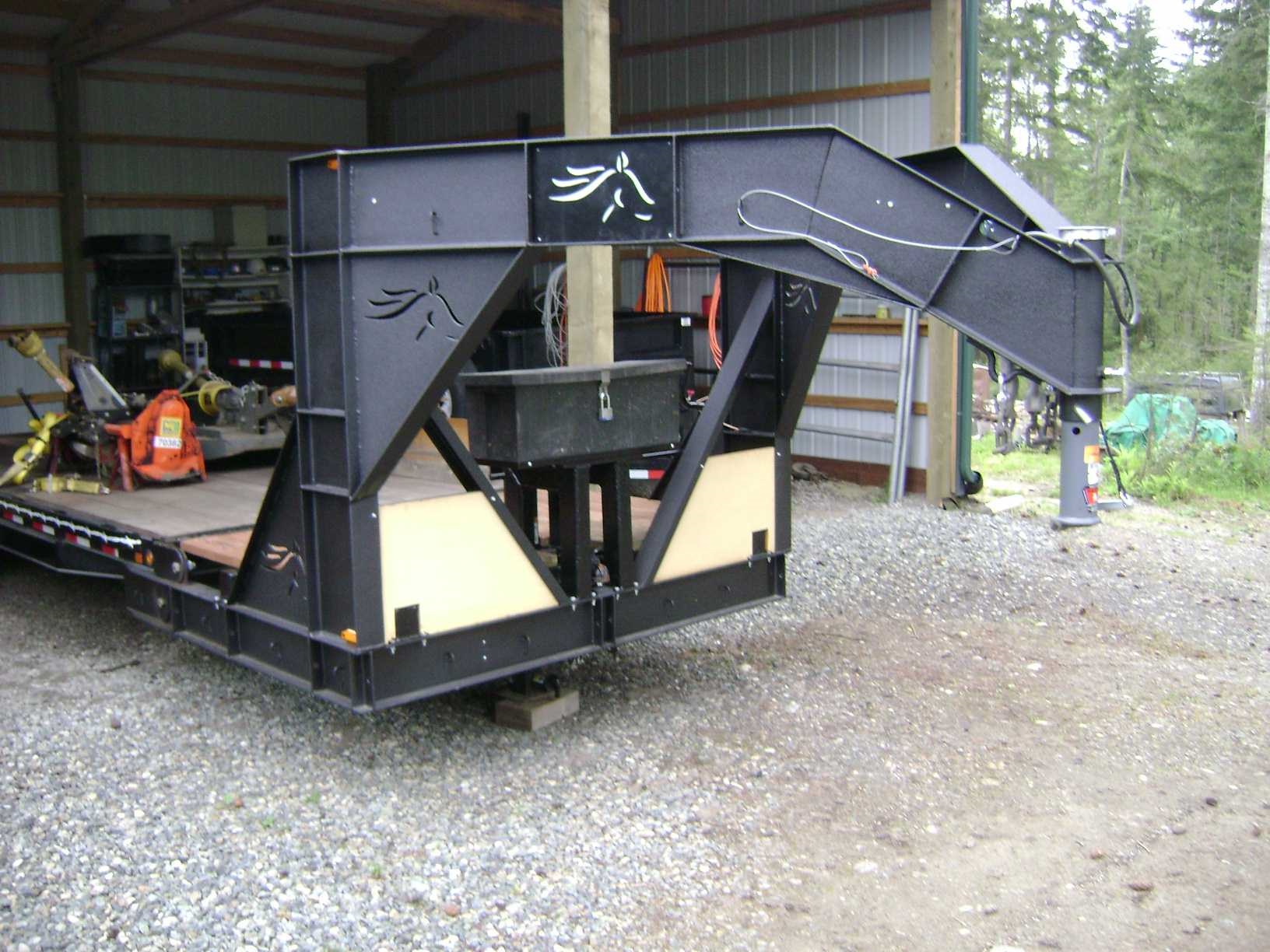

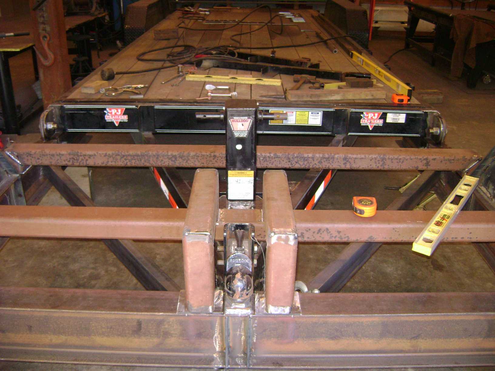

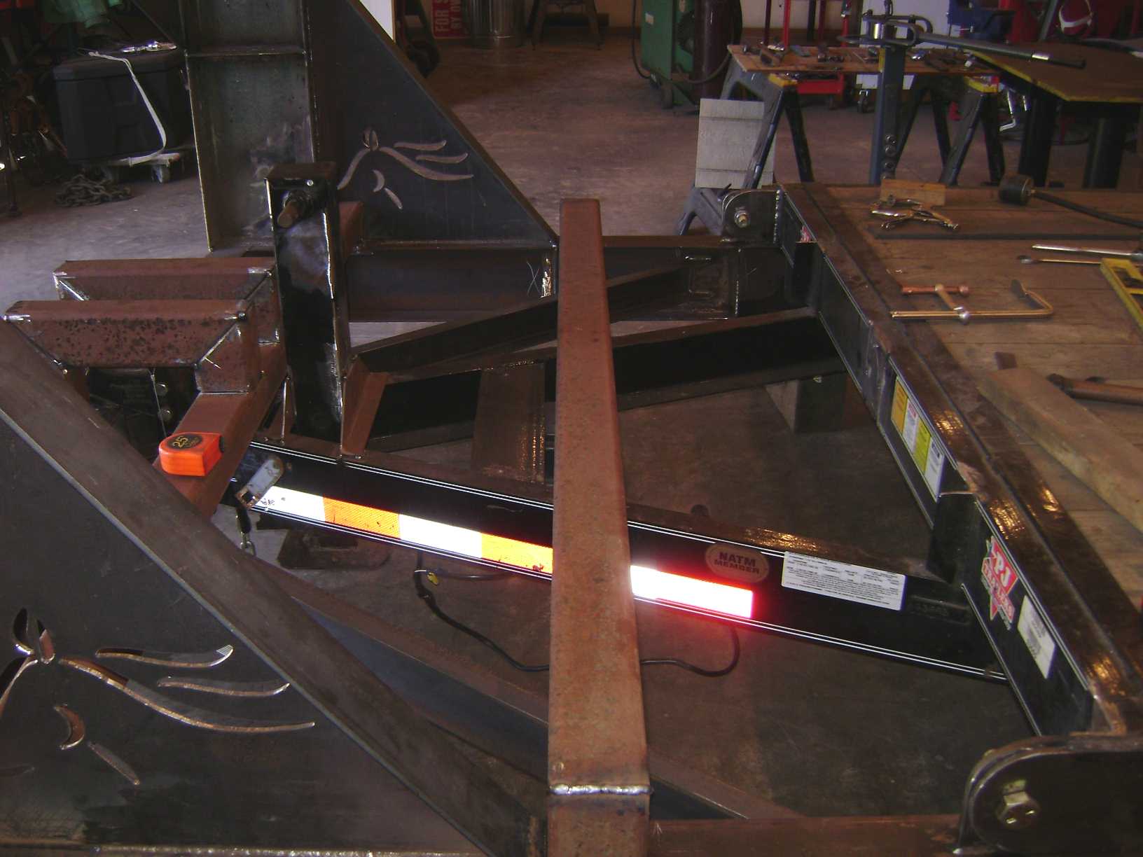

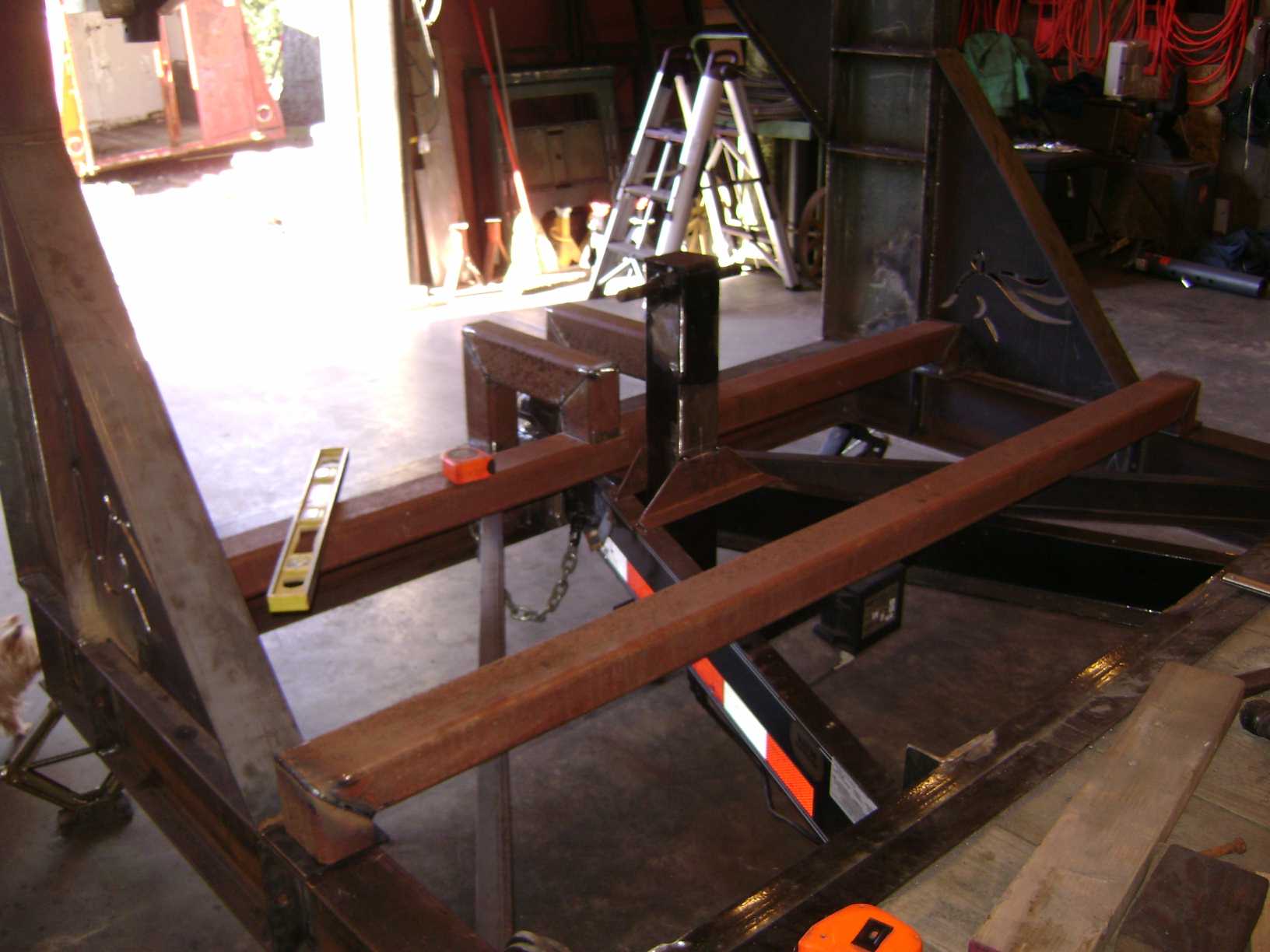

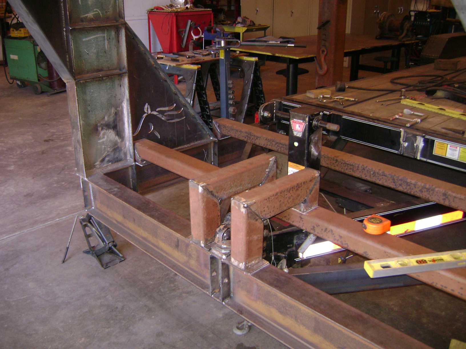

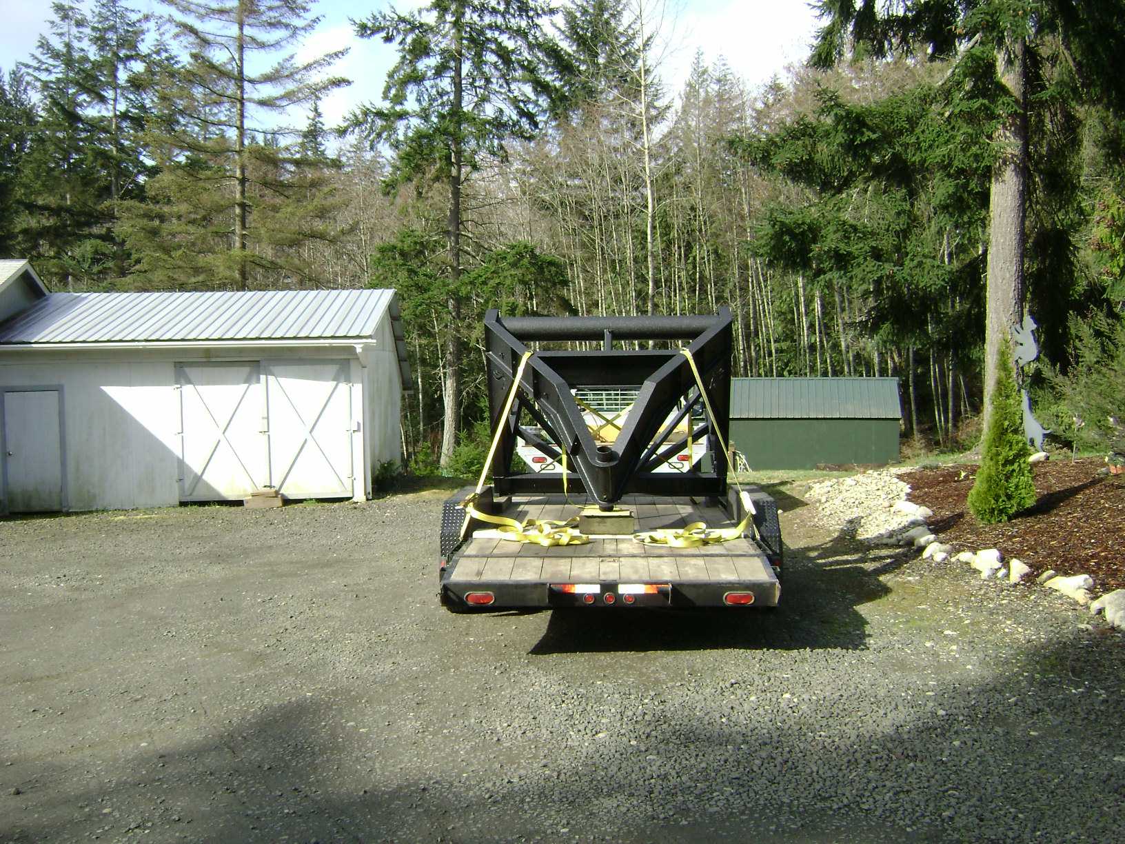

Seems a little slow around here:confused:. So I Thought I'd post some pictures of a gooseneck adapter I built a few years ago. This is the second one I've built. I built a lighter version for a friend a few years before this one. The base is 8-inch I-beams. The gooseneck is 12-inch I-beams. The trailer pulls perfect.:cool:

This is the best of both worlds. I haven't removed the gooseneck adapter since I built it. My buddy takes his off all the time. He just uses his tractor to pull it off, and sit it out of the way.
Here is a picture of my buddy's trailer.

/ Gooseneck adapter build. #4
You've posted pictures of those before, I was intrigued by them then, as I am now... I like my current BP deckover, and plan to copy your design when I get a GN hitch...
/ Gooseneck adapter build. #5
How much does it weigh?

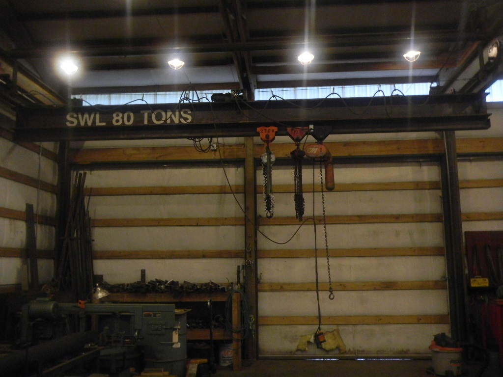

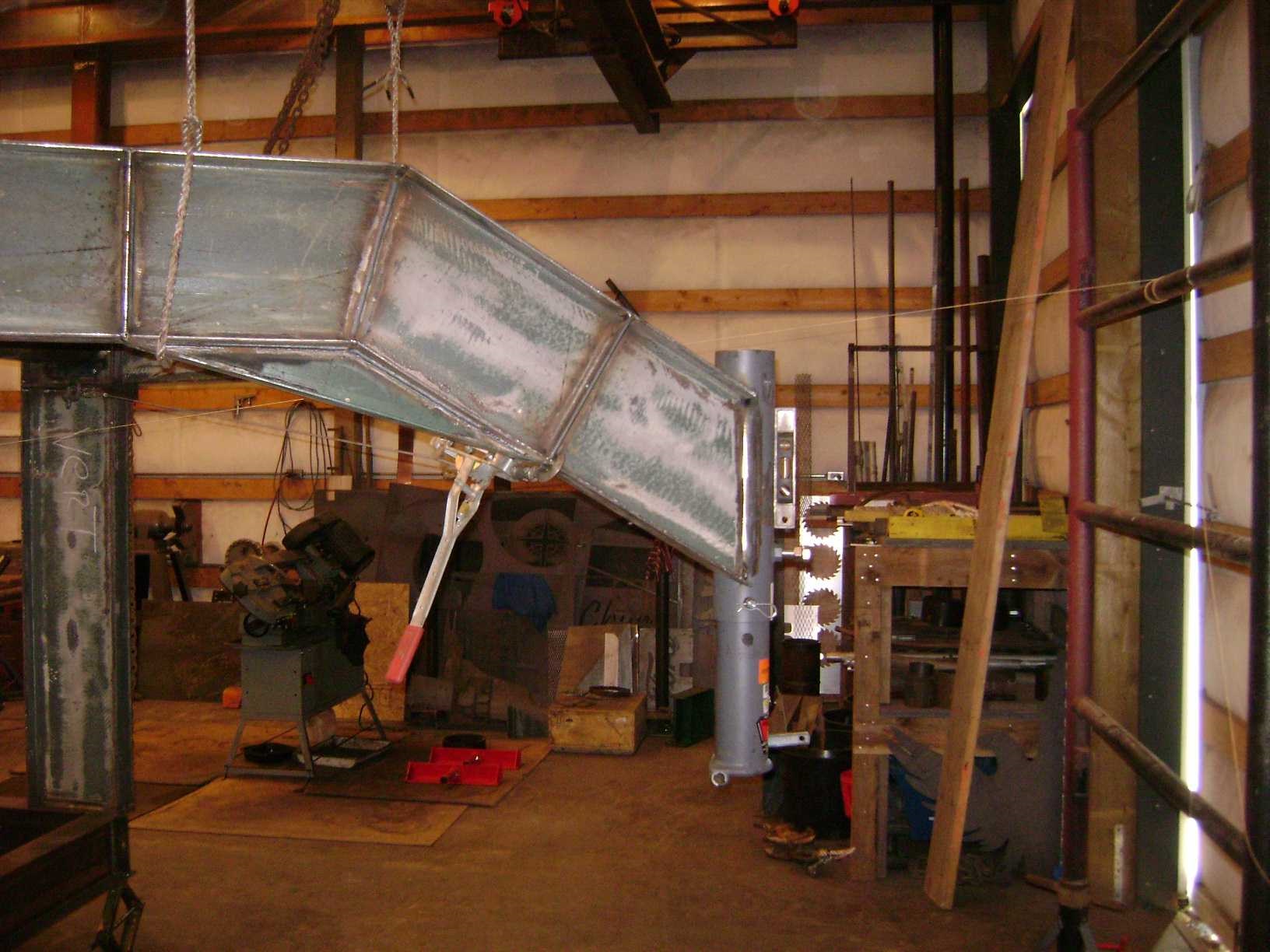

This really helps when building things like these gooseneck adapters.
My 8-year old granddaughter, (now 23-years old) did the layout, cutting, welding, and rigging. All I did was run the tractor to install the beams in the air.;)

Shield Arc, I'm glad you showed this adapter --->separated<--- from it's ball-hitch trailer. I saw this a couple years ago and never comprehended that it was an ADAPTER, even thought it was in the title. This is the kind of thing you CANNOT buy, it only happens on "Build-it-Yourself".

But back to this topic I'm glad to see how that adapter works - that's inspiring.

That goose neck adapter is neat- Looks like some extra deck space is ( or could be) created by bolting it on?

okay for discussion purposes, I know you can haul more weight on a goose neck because it put more weight over the truck axles but at what point do you add so much weight building the GN that it is not worth it to add the goose neck?
#14

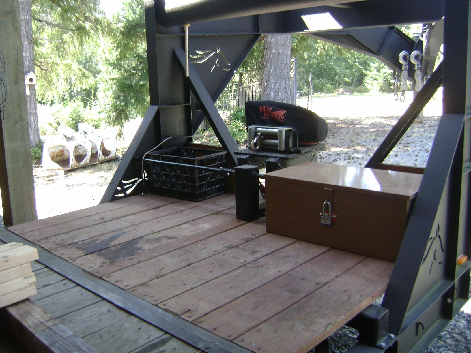

I built some frame work for a deck over the trailer's tongue.
I don't know the answer to your question.
An engineer friend ran the numbers for this gooseneck adapter. He said it was good for at least 30,000-pounds.
