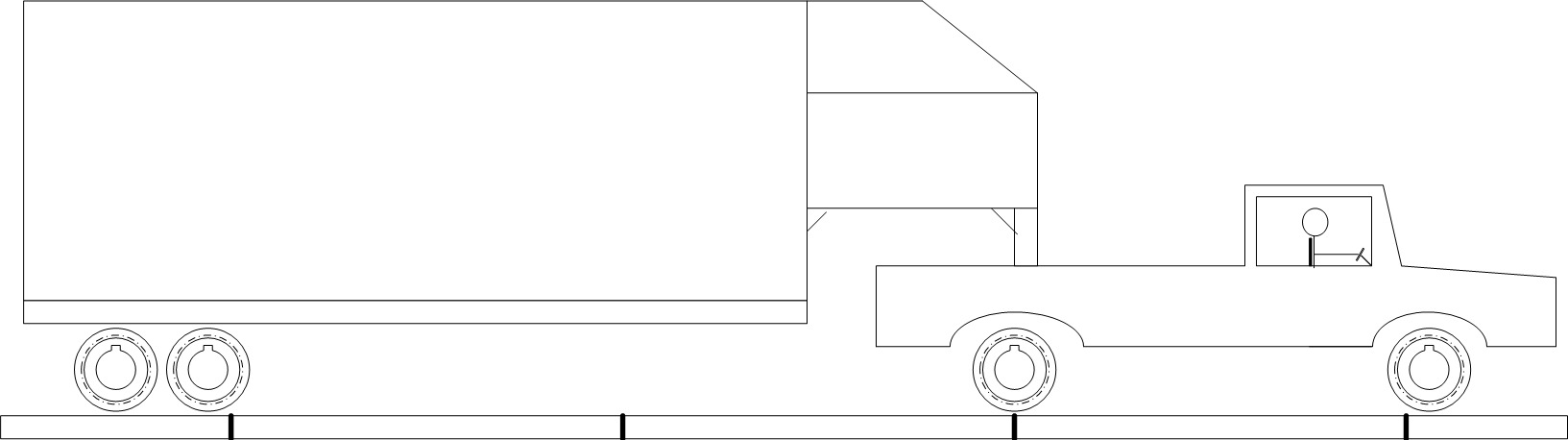

Perhaps you were hitting the expansion joints like this: Truck.png
What that would do is make the rear of the truck go down (just a little) and as it is bouncing back up the trailer tires are dropping into another joint. Not much, but on a trailer without shocks, it could cause the "pogo stick" effect you describe.
