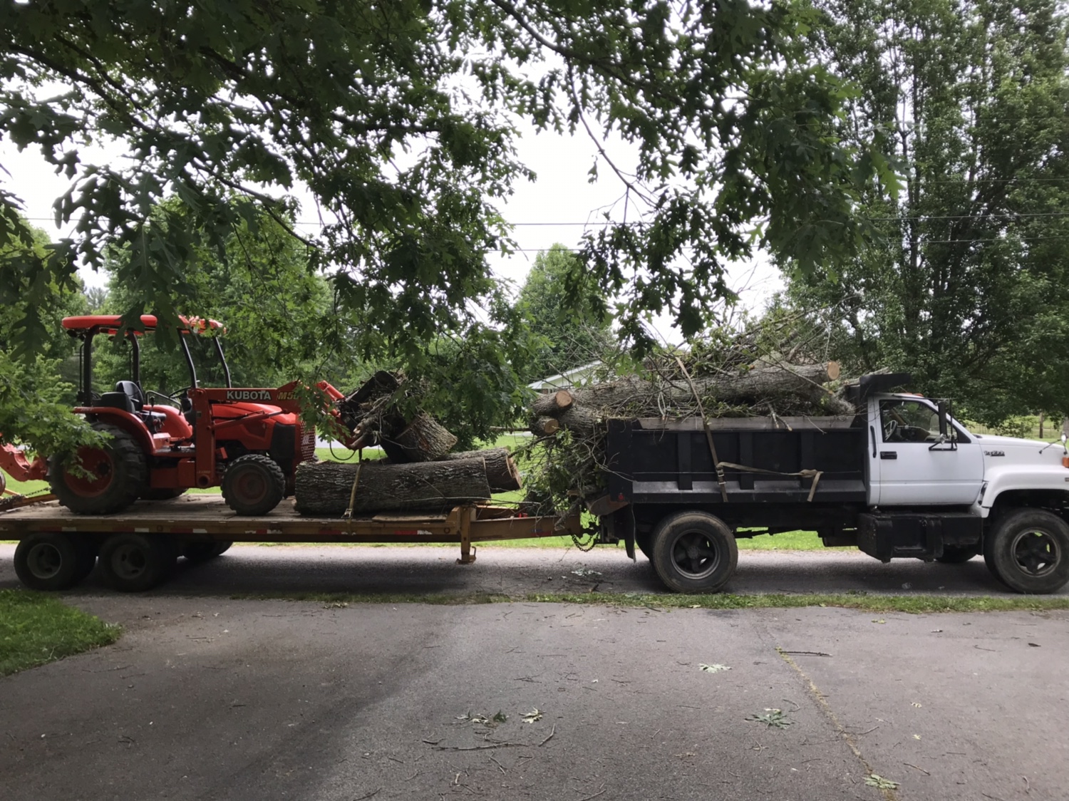

Bumper pull trailers pull like crap and the weight distribution is a lot more sensitive to get right. IMO anything above a 10,000 pound load behind a pickup should be a GN. I pull a pintle hitch trailer behind my 6500 truck but that’s a different animal. There’s zero sway with it and any amount of tongue weight short of breaking the hitch off is good to go. IMG_8795.JPG
