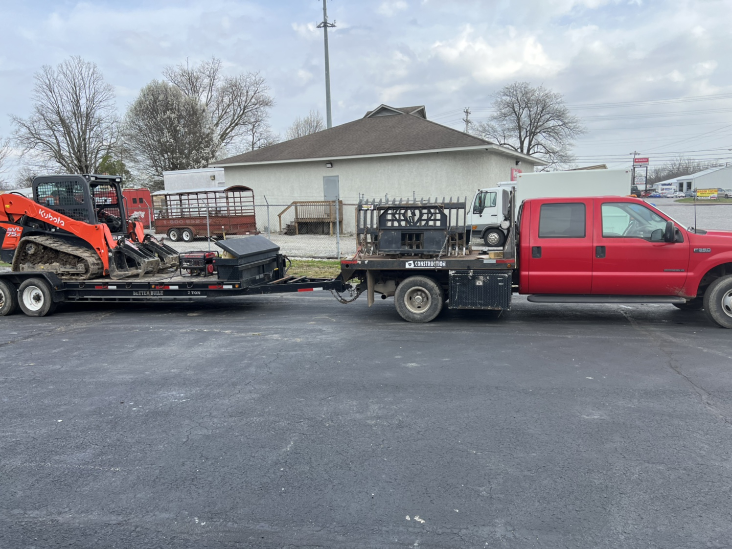

I was afraid of that. I have decided a box truck or flatbed with a lift gate may be the best option. A crane, like 5030 suggested, on a flatbed may be another option.
Yea, a 26k flatbed with a lift gate is probably gonna be light enough to give you at least a 8k-10k payload that you want. But is a pallet jack to move the bundles of firewood gonna be enough to get the material where the customer wants. Like if they dont have equipment themselves and a gravel driveway or something?
If the tractor is only 5500lbs......you can always get a 26k straight truck with a flat bed.....and tow a 10k trailer behind it. Put the wood on the flat bed and the tractor on the 10k trailer. That still keeps you under CDL.

A potential max of 11,900 on a 22-24' trailer is gonna be a no-go with just about any 14k trailer. You need a 16k for sure.
And sadly.....6400# on the first 8' of either a BP or a GN trailer I think is not gonna go so well with a 3/4 ton truck. just my 2-cents
I load my 10 ton trailer like that but you’re right a 3/4 ton truck would be crying with that kind of hitch weight. Probably to the point the front wheels are off the ground. My ton dually wouldn’t be happy either. I could probably manage the load the op plans on hauling with my ton dually and 14k trailer if I put half the bags on the flatbed and half on the trailer.
