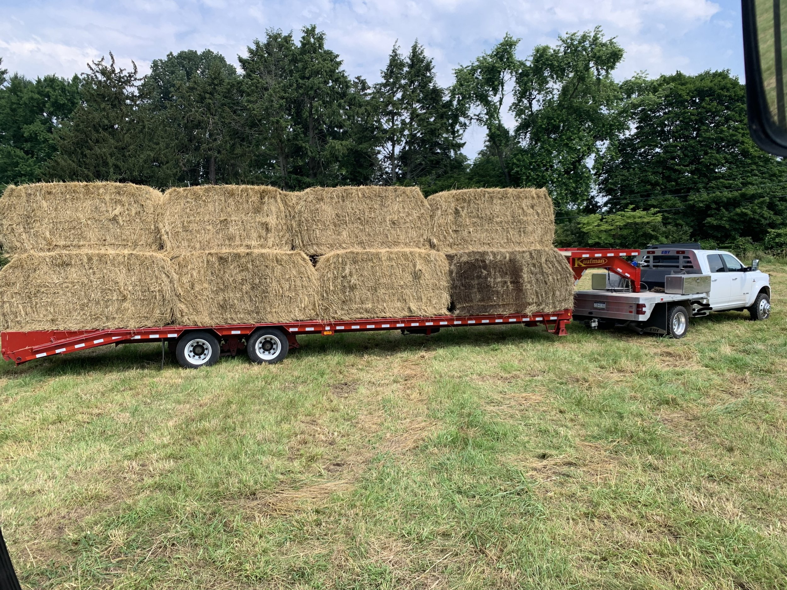

Another thing to consider if you go with the 17.5" super single is you can also get aluminum wheels to save even more weights. That is what I did on my 16k gooseneck. I like the look and they are considerably lighter than the steel wheels. Another advantage of the singles is they are easier to inspect and set tire pressures. The

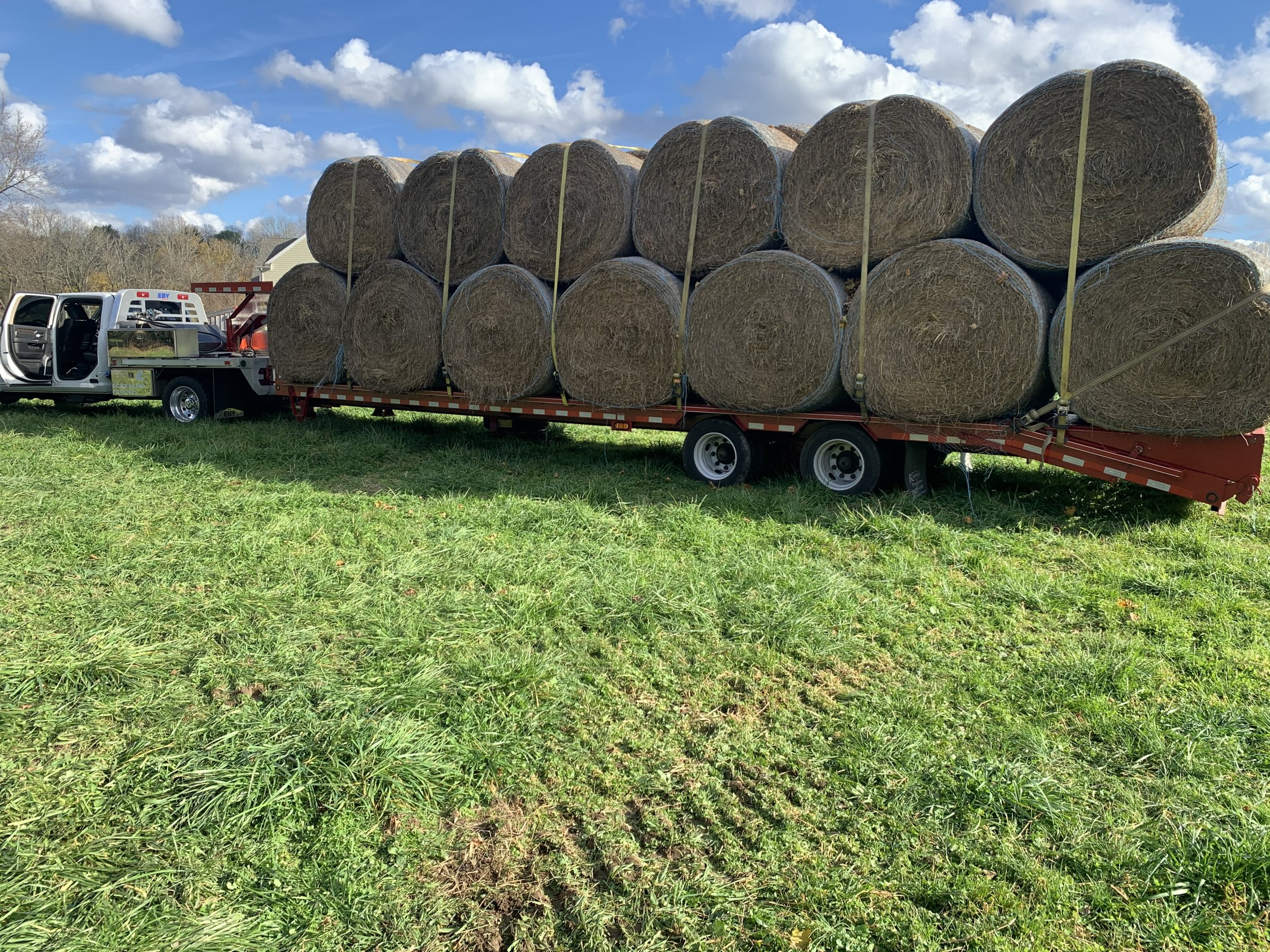

I haul commercial @26k max so all my trailers are singles (5). Like you said, dual's will get you looked at by DOT. Three of them run 17.5's, I have yet (knock on wood) to have a flat. I watch them close and keep good tires on them.

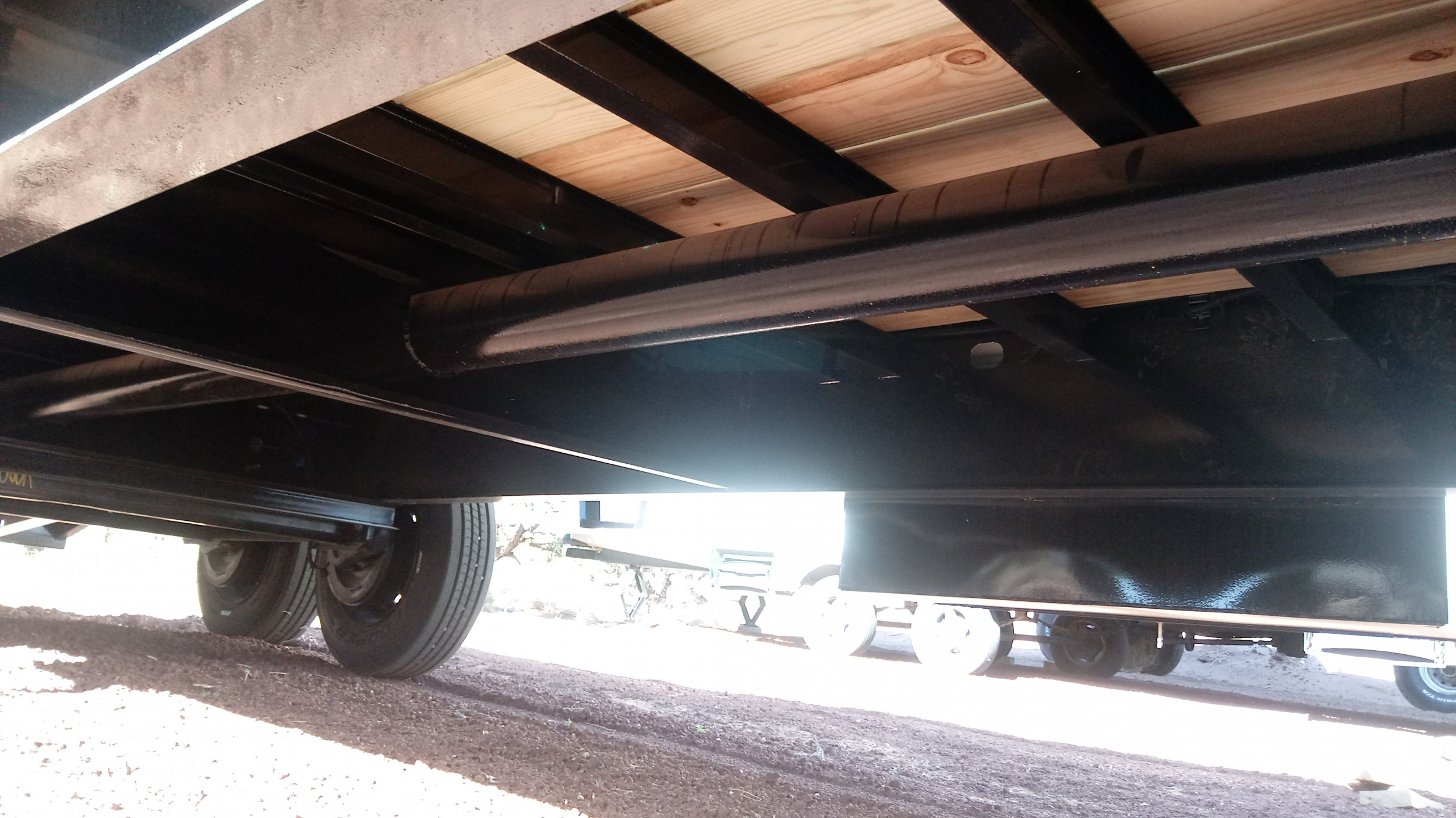

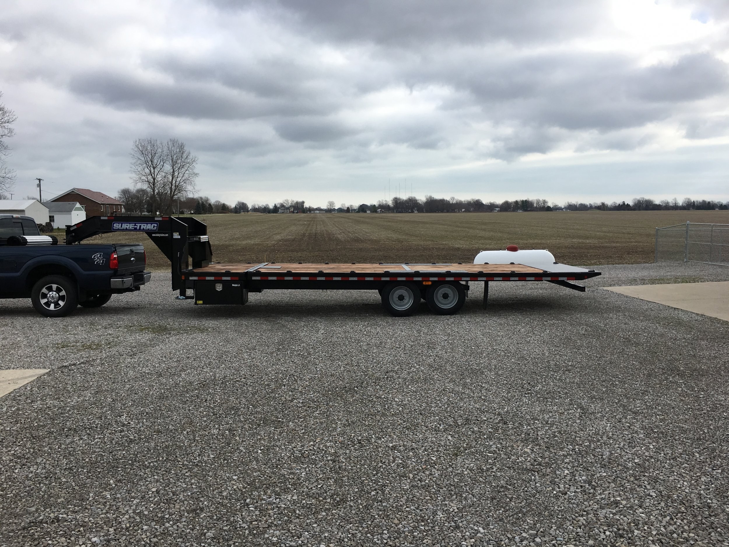

I have a 102'x28' 18k rated Diamond C flatbed with 8k torsion axles. To stay @ 26k total, I had it derated to 16k, my truck is 10k. The trailer weighs 6k empty before I added tie down gear. It has the engineered pierced beam main frame and gooseneck, supposed to be lighter than the competitor's. What I like about the 8k axles, the trailer is built with that in mind and has a wide frame. The 10k super single trailers have the narrow frame, same as the dually. I also opted for the sway control, standard on 30' and above.
Pictures of the frame width. First one is mine with 8k's, second one is my sons, with 12k axles. Note, 2 deck boards outboard of the frame v/s 4. In my opinion/experience, the wide based frame will pack a top heavy load better than the narrow frame. Sway control pipe is also important hauling top heavy loads.
