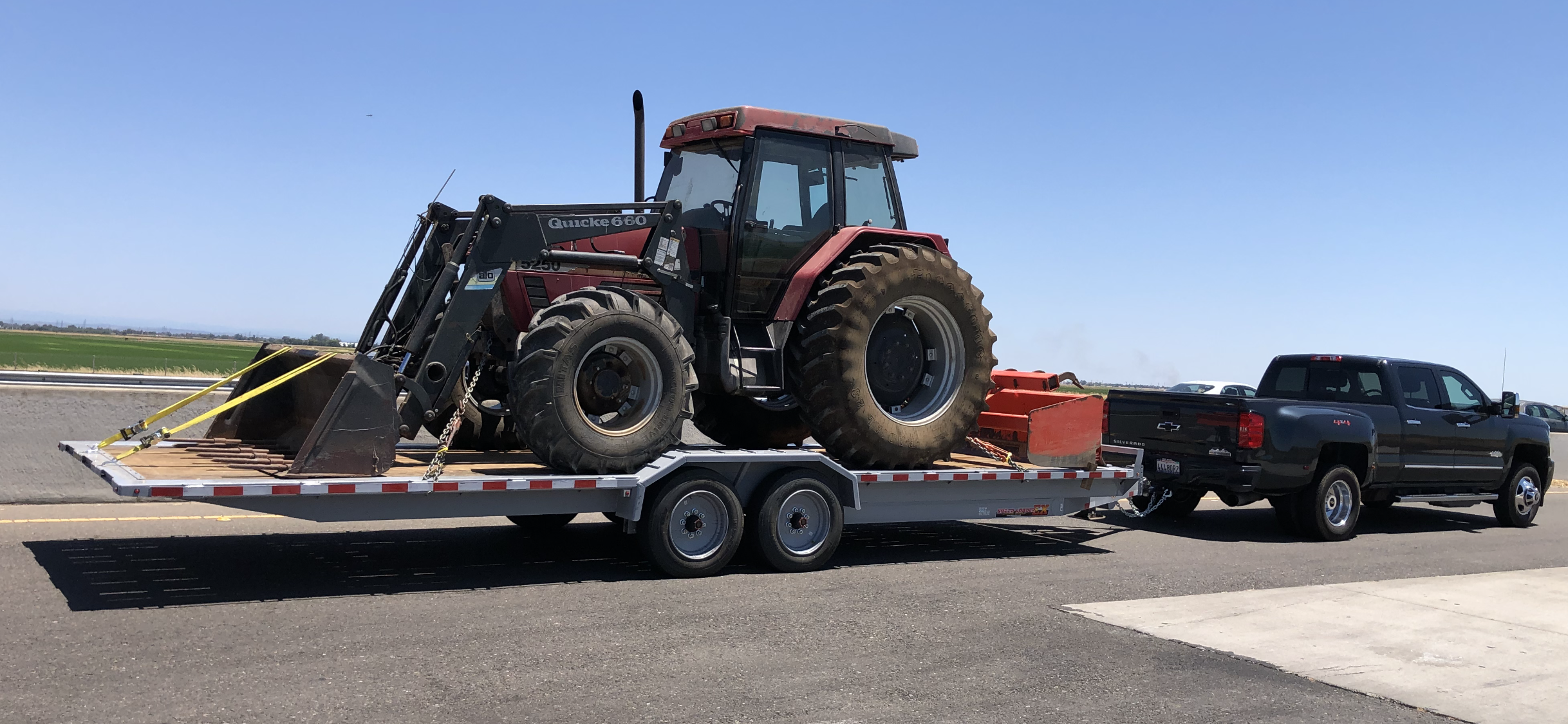

I think that pipe running down the center is called a torque tube or something like that. However, I do NOT understand its purpose? I have worked on lots of flatbed semi-trailers, and I have never seen one on them.

Thank you. Yes, some manufacturers call it a torque tube, Diamond C calls it sway control, just to be fancy I think:D It helps control bed twist especially in the longer decks. By design, a gooseneck doesn't support twist like a flatbed can.
