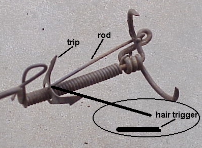

The only sure fire methods of limited control is a good cat and a good trap. I've used the .22 but I don't have the patients to wait like a cat does and my hearing is a million miles from that of the cat that can hear them under ground.
And some cats will quickly learn to run your trap line for you. Teaching them to re-set the trap is more difficult:D
