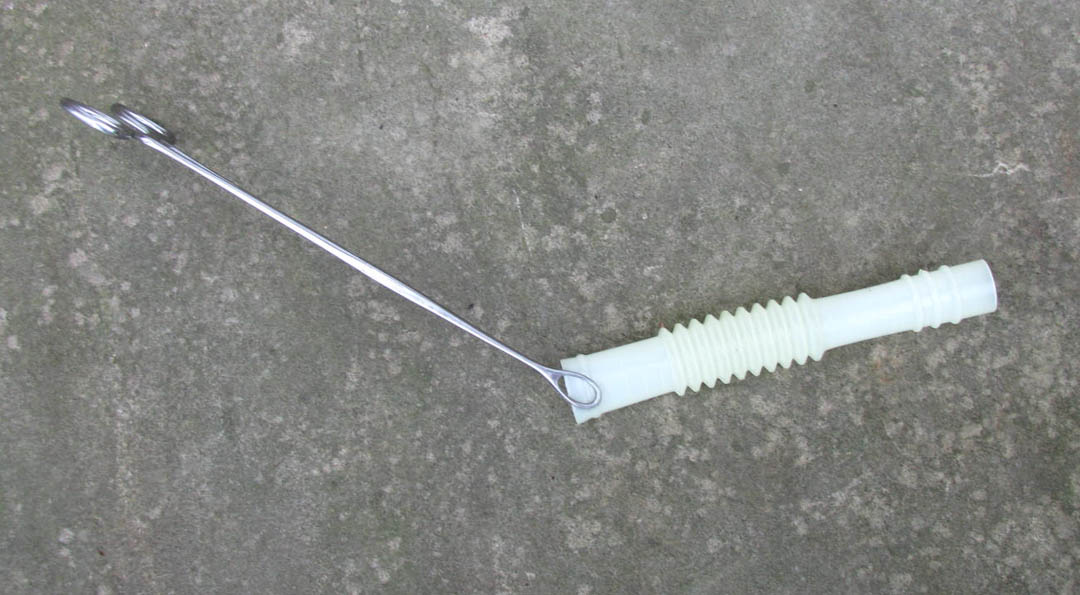

My first tractor (Case DX40/NH TC40DA), so instead of driving 6 miles to the nearest town, I use a 5-gallon poly can to refuel. I guess I could have just repainted my old steel gas can with a metal spout yellow, but I wanted to be environmentally sensitive. So, I got one of those new safety cans that gets gets as much fuel on my pants as it does in the tractor.
Long story, short, the translucent spout extender fell into my tank. Darn it. How do I get it out? Does that plastic even float in diesel?
Some options I have considered:
1) Hire a skinny 8-year old boy to reach in past the restrictor to find it. ;)
2) Use my Ryobi snake camera to find it and try to guide it to where I can reach it with some prongs.
3) Empty and remove the tank and/or fuel level sender unit?
Any other ideas?

Dollar store - they have these "grabber things" - flexible metal shaft with a plunger on one end and 4 bent wire things on the other. Push the plunger, the other end slides out and expands to about a 1" diameter and then release the plunger and it pulls back under spring tension (with the spout in it).
Works great for grabbing nuts, bolts, etc when you cant reach them. Think they even called it a grabber. Plus it is only a $1
Good luck

John, fear not, you are not alone by any means. My wife has done it on our tractor twice and I did it on my ATV. She was able to reach it with needle nose pliers and a long thin screw driver. I had to remove the tank on my ATV.

Yep, any kind of funnel is better than no funnel. Just unscrew the EPA cap (as you do when filling the can) and pour the fuel.
As far a finding the cap - in a dark barn or during the night take a flashlight and look for the cap. The light will shine right through the fuel. Once located the "fishing device" mentioned earlier (long tube with four prongs on the end) should work. Most hardware or auto supply stores carry them.

I had the aluminum nozzle from my fuel hose fall out into my tank when fueling. I left it in till I ran down to about a 1/4 tank then with help from the noon day sun, I could se it shining in the bottom. I found a couple of small pieces of can and managed to roll the pipe around till I got one of the canes inside. I then used the other one to wedge it tightly and lifted it out. Got lucky and only took me a couple of minutes after I found it. Shiny aluminum inside a shiny tank is hard to see. The shape of the tank helped me since it was flat with one side sloping about a 45 angle so when I rolled the pipe around it was facing up enough for me to get my first cane into it and then the other one was just perfect to stick in beside the first one and wedge it tight. That nozzle wont come out again as it now has a 1/4" self tapping screw through the nozzle handle and into the end tubing. I never saw one of those come out before.
