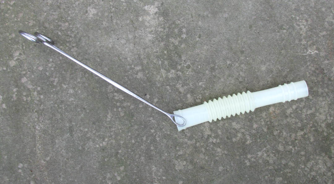

Well, I got it out. But, it took the help of an obstetrician. :D
attachment.php
Drained and removed tank. It is really not that hard to do on a DX40/TC40DA. The spout kept getting lodged behind the filler restriction. With the tank tilted slightly forward, the spout could be rolled forward and grasped as shown.
