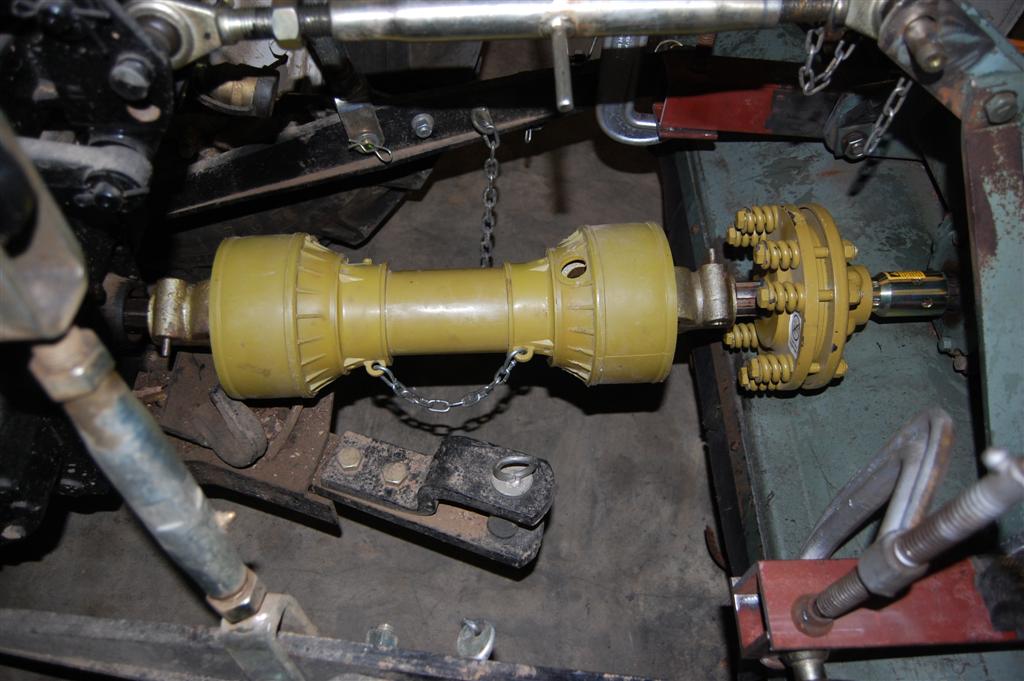

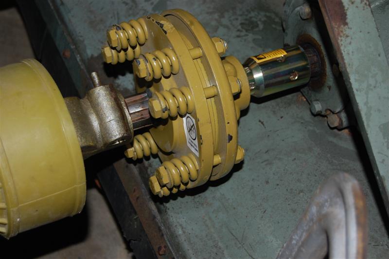

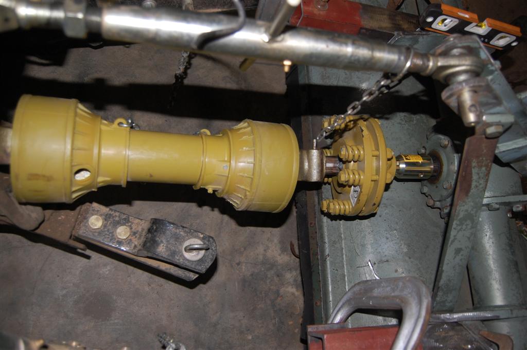

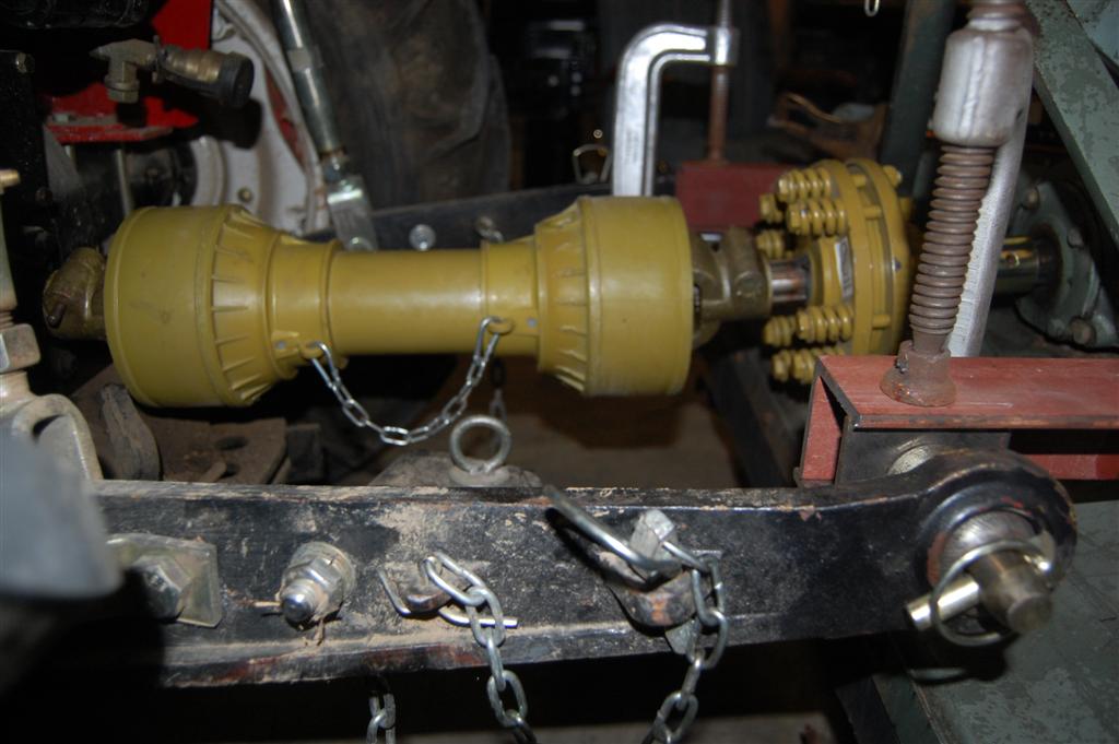

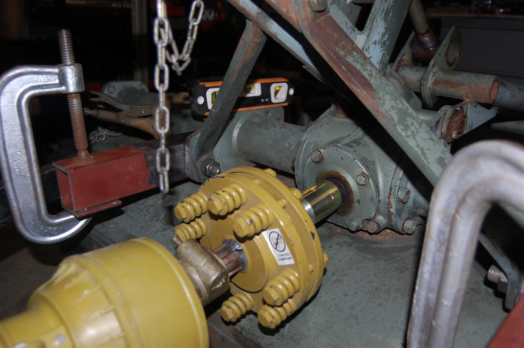

:laughing:Ok I finally got around to getting over to the tractor supply store to get
a slip clutch . Well now I can safely say that this ain't no more Free tiller folks .
As you can see where the buck stops it cost $220 .
The good news is all my careful measurement with the string and plumbob and square
have payed off sorta kinda .Either that or the tractor gods were shining down on my tape measure
and laughing .The drive shaft from my wood chipper is short and payed for so all
measurements were taken to use it . It was soon apparent at the store that the clutch
must be attached to the implement end . Know how I figured that one out ? Thats what
it said on the sticker. This presented a new problem the diameter of the clutch would interfere
with the sheet metal from the tiller. But laying right next to it was a PTO Adaptor for 26.99 .
So the space I had allotted for the Quick Hitch is now being used by the PTO Adaptor .
This is not what I wanted to do, But like my grandpa always said you got the "Cart before the Horse boy"
Never the less I have already cut and drilled my angle iron at 11.5 inches and will weld it
up as it is . I would suggest 14.5 inches if you use the Harbor Freight quick hitch.
So future builders take note to include the distance taken between your quick hitch
when fitting this to your tractor or your drive shaft may fall out when you lower it in the ground.
Once I finish this project I will post a scale drawing . The photos show a near perfect fit
adapter ,clutch and driveshaft, Of course without the quick hitch.

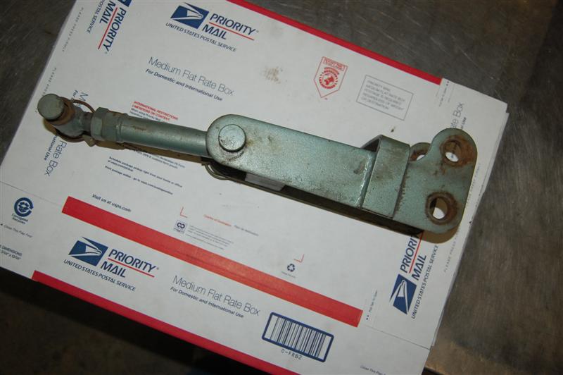

:dance1:pS If any of you Yanmar owners need this top link let me know it is for sale and fits
in a one price shipping box .
Starman:cool2:
