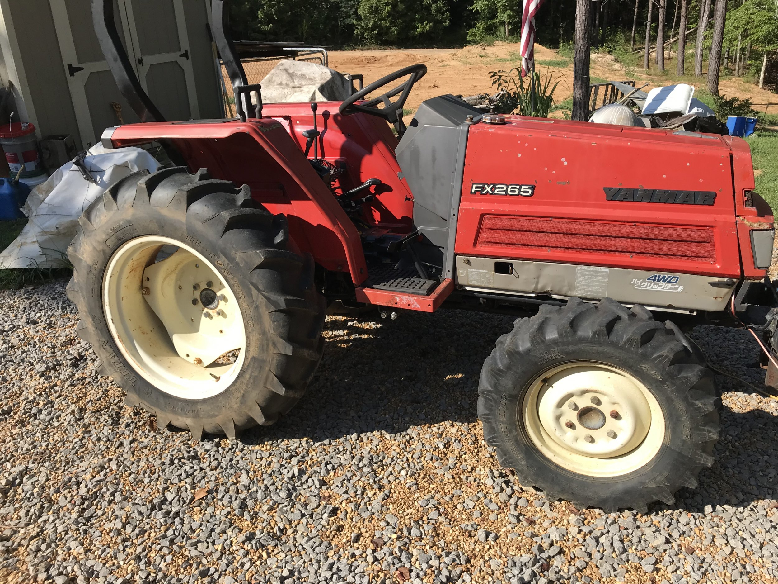

3-Point Hitch Got a FX265 D, problem is the 3point hitch arms do nothing. New to group and looking for help. Already did complete fluid and filter change.

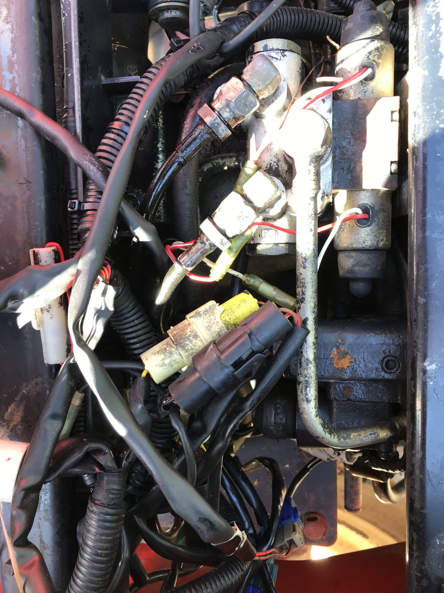

Thinking you have some electronic controls on your 3 point. If that is the case, it is over my head.
   / Got a FX265 D, problem is the 3point hitch arms do nothing. New to group and looking for help. Already did complete fluid and filter change. #3
OMG the dreaded electronics vs our very mechanical YM's, you have access to any english diagrams for that.

Yes,
there are 2 solenoids that are associated with it. One of them seems to make a clicking sound when I pull the lever or joystick to like raise the 3ph and stops when like lowering it. Maybe the issue; but, it may also be a stuck rod or valve in the system. I’m just trying to get feedback on where I should go next. I have been reading all the posts of others that have 3ph problems in trying to narrow down the problem. Any insights by anyone that has this model or similar would be greatly appreciated.
I have a parts manual with good diagrams but it’s in Japanese. It is helpful in be able to know what to expect in case I disassemble anything.Have not found an English version yet.
