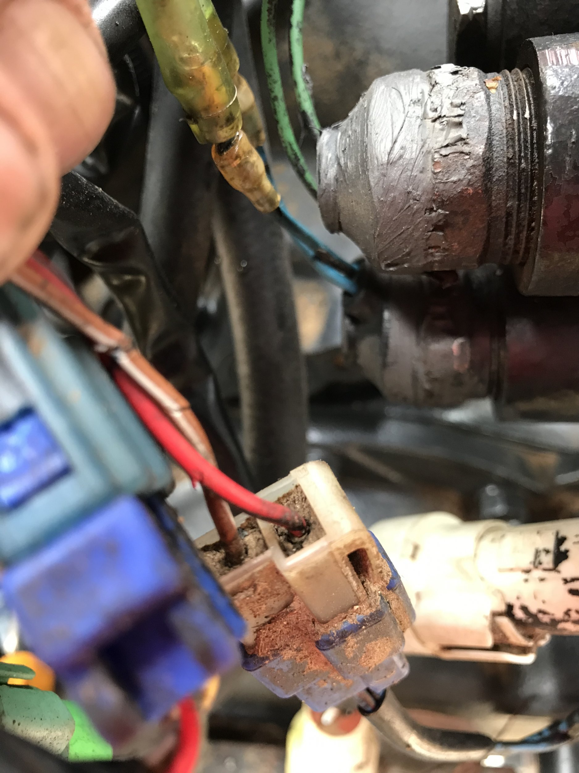

This is my UFO control box on the righthand side.

maybe I missed it, But did the 3pt ever work?

did because the guy I got it from was using it up until last year when he bought another tractor. They bent the rod on the ufo hydraulic ram and had that fixed. The guys dad said that it was working fine till then. I am thinking I have a bad solenoid; could be as simple as that. I’m checking into them now.

The pictures are fine but..... they are way to close.
Im looking for 2 plugs on the left side of the rear of the tractor, the reason is if those 2 plugs get water in them or the wires get pulled, nothing will work.

Ok here's the 2 plug-ins + Virginia and her family
I will try to get you a picture later, I have Virginia in the garage, maybe I can snap her picture, she's (quite shy)....
ll take another pic further back

I have that white plug-in but the yellow one is nowhere to be found. And they are loose not attached to any mounting plate. I guess the previous owner destroyed that setup. What are the colors of the wires going to that yellow plug. I have one-white/green stripe and green/black stripe
This is a pic of the left side from the rear; you can see two sensors (I guess) with wires going to them. Does Virginia have those also?
   / Got a FX265 D, problem is the 3point hitch arms do nothing. New to group and looking for help. Already did complete fluid and filter change. #57
left one
black w/ white stripe
red w/ white stripe
green w/ white stripe
right one
black w/ white
yellow w/ blue
blue w/ yellow
red w/yellow
Wow! glad I'm not color blind. I just could not get a picture (no room)
Virginia has 2100 hrs on her, I bought her back in 1999, she came over on the boat.... It was luv at first sight. :ROFLMAO:
   / Got a FX265 D, problem is the 3point hitch arms do nothing. New to group and looking for help. Already did complete fluid and filter change. #58
Yea, she has the 2 sensors?
#59
left one
red w/ white stripe
right one
black w/ white
yellow w/ blue
blue w/ yellow
red w/yellow
Mine start at the unit one color then change at the other end of the plug-ins. Left start at the unit, blue/red stripe,blue/yellow,black/ no stripe. On the plug-in-green/red stripe,red/white stripe,and black/ white stripe. The right one starts, blue/yellow, blue/red,black; at the plugin red/white,black/white,green/yellow.Dogone that’s confusing as all get out!
#60
I don’t think the problem is with those two anyway.
