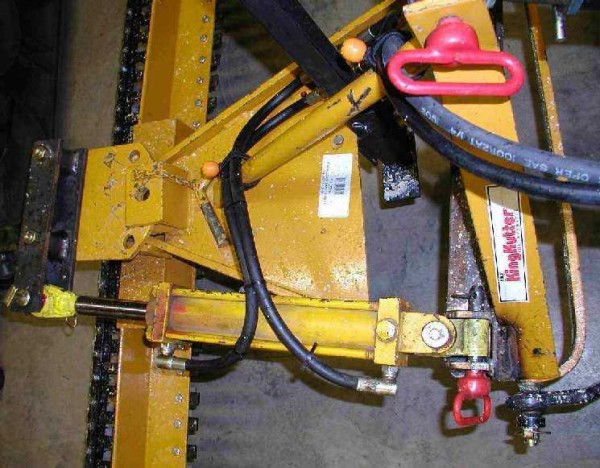

I have KK 84" landscape rake.
Has anyone given any consideration to adding hydraulics to adjust the angle?
Doesn't seem like it would take much time with a welder and a couple pieces of metal plus the ram.
Greg

</font><font color="blue" class="small">( Has anyone given any consideration to adding hydraulics to adjust the angle?
Greg )</font>
I have considered it many times, but just haven't come up with the correct cylinder to do it and the time to make it happen. Too many other things keeping me busy. Here is a picture of one that I grabbed off a post a long time ago. Sometimes it is the simple things that take the longest to accomplish..... like cleaning the garage.. /forums/images/graemlins/grin.gif /forums/images/graemlins/grin.gif

york brand makes a landscape rake with hydralic angle but it is almost 3k. you can buy the hydraulic angle kit seperaltely, on the website.
