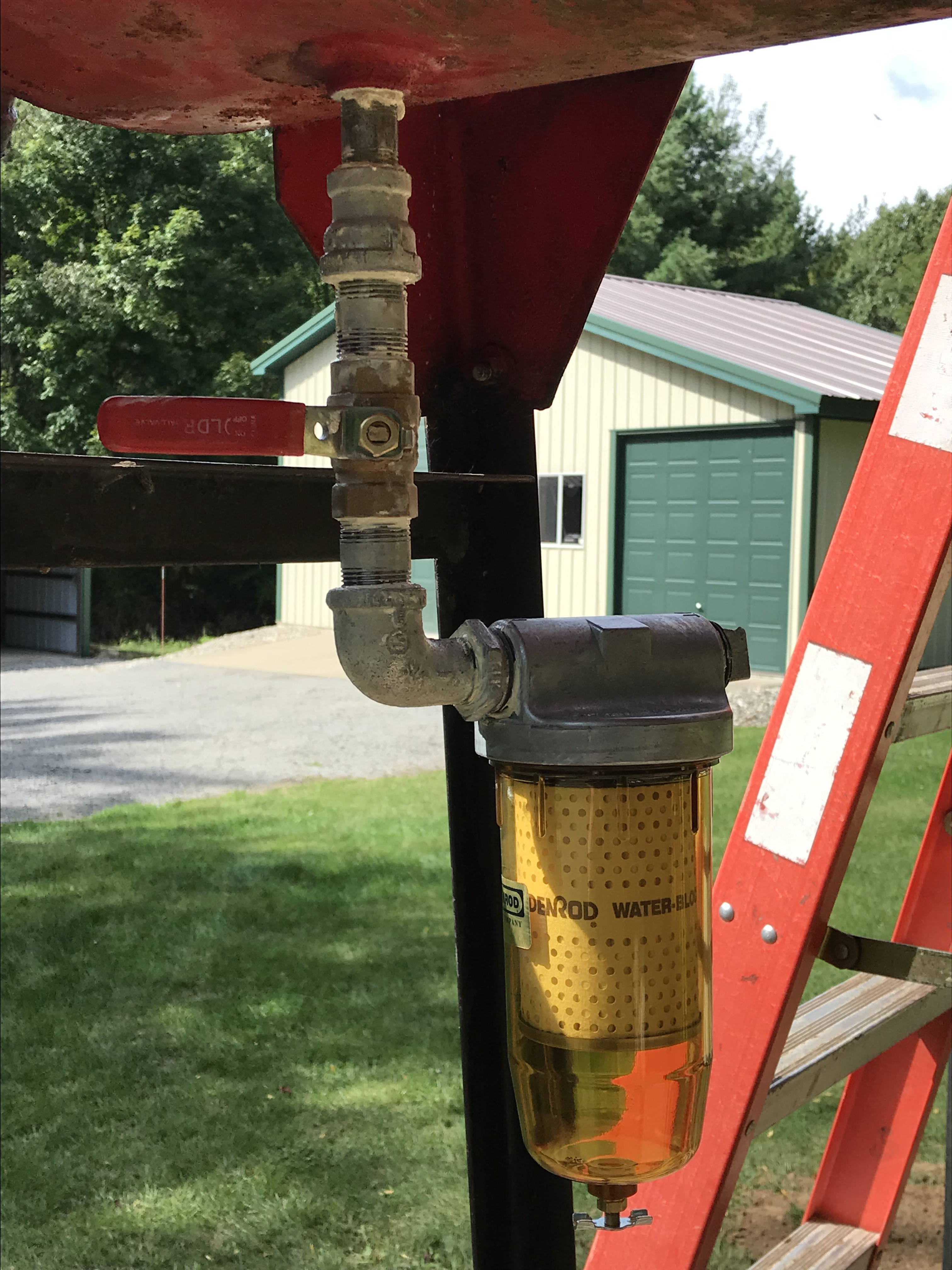

Here is my new filter setup at the bottom of my diesel tank to disperse water.I also have a filter set up in the fuel hose feed.

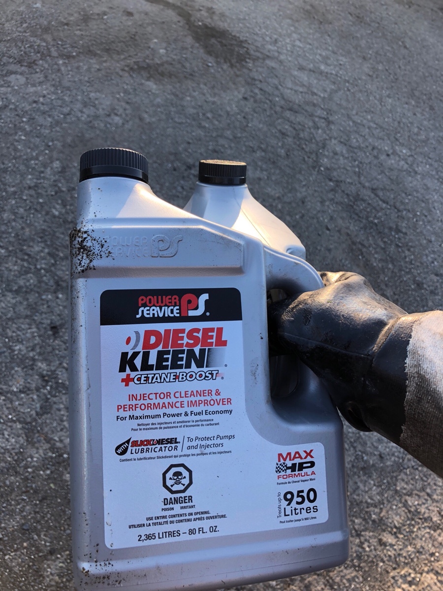

I regularly drain off the junk in the bottom of my 500 gallon bulk tank and I add Powerservice biocide and Diesel Kleen as well.

Bummer. I killed my Jeep getting fuel from a station that was getting the tanks refilled. Something I won’t do again. The new filter setup will take all the guess work out of it now. Some Biobor would help clean things up

Did the filter bowl completely fill with water?
   / Got bit by overhead diesel tank contamination.
Did not have the new filter in place that I do now on the bottom of my tank.The in line fuel filter on the hose showed very little water contamination when petcock was drained.The reason for the new added fuel filter setup.

OH! I didn't read carefully and thought the picture in the first post was the "set up" that let you down.
I always like to think that a sight glass of some type is better than a metal can. But "regular maintenance" can work even if I can't see inside. ;-)

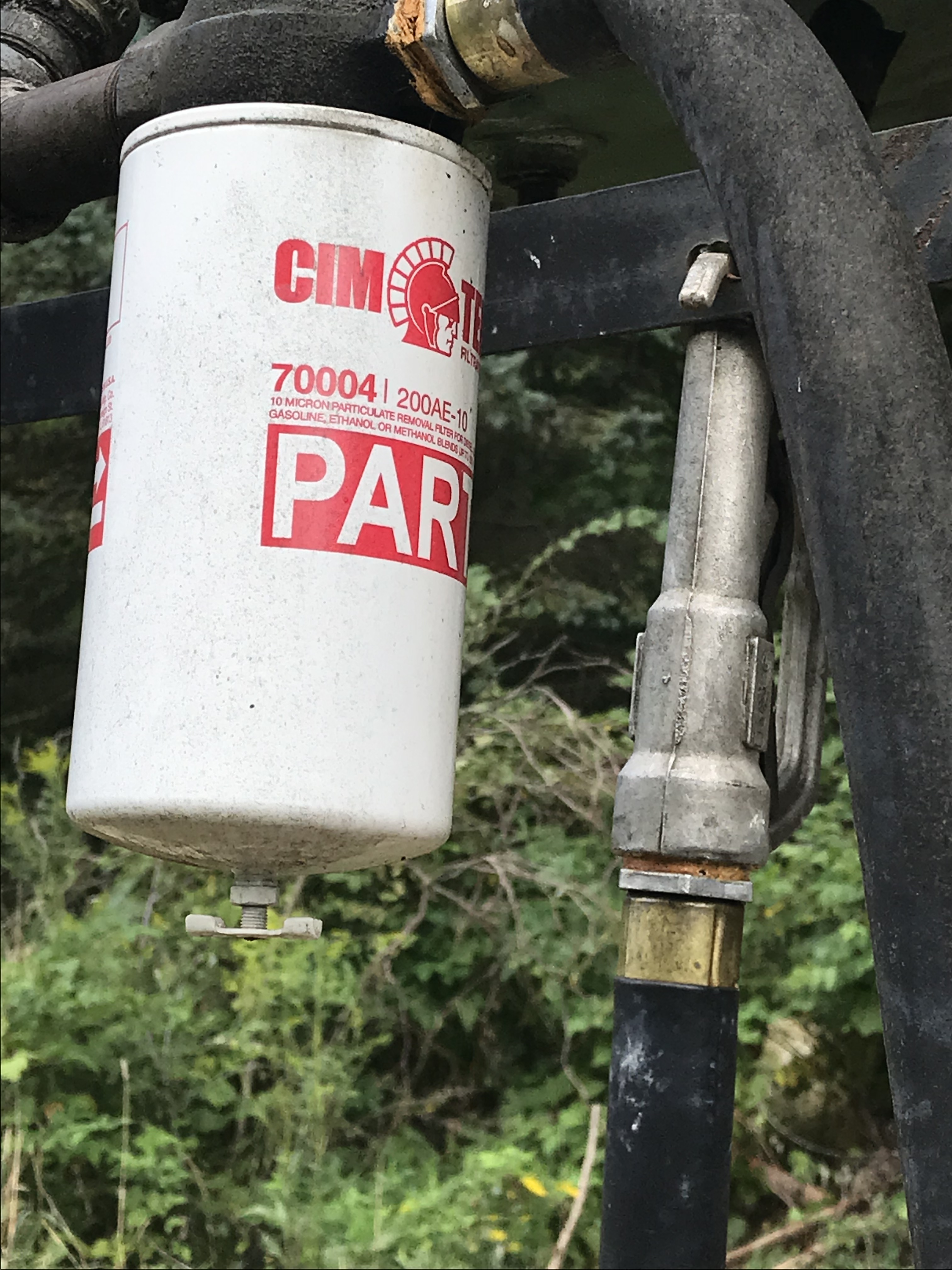

I run 2 filters on my tank. A water separator like yours and then a 5 micron (I think) second filter to polish the fuel. Hopefully when it goes in the tractor, the tractor filter doesn't have to work very hard.
