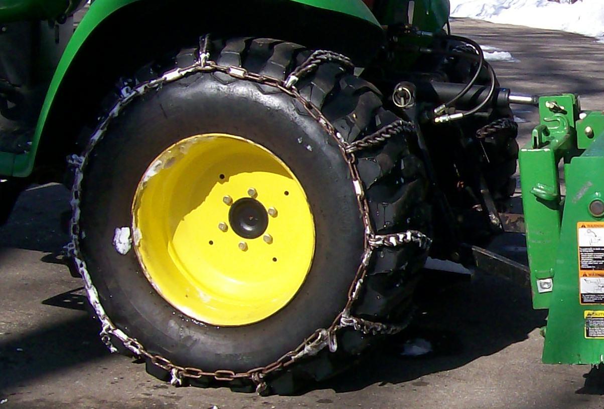

Go to some tractor supply places, or truck supply houses, and make your own (half the cost). Buy the side chain in bulk, the cross chains in bulk, the cross chain hooks, and the side chain closers (just need on outside side chain, as the inside is just a simple hook.
You will get a much better rigging than on-line too. IMO
My home-made chains.

Never seen 6-link chains before...2 and 4's but never 6.

I'll have to admit that is about the best fit I have seen on chains. I think I'll try to make my own also. I need chains and some weight on the rear in the worst way. Do you remember what type chain you used for the cross chain?

You got my interests up... Is there a 'special' type of chain needed for snow chains? What is the difference between the side and cross chains?

For making up the chains, I used 6/0 side chain and 9/0 cross chain. Both can be found in bulk at truck supply stores, and/or can be seen/ordered on Tire Chains by TireChains.com
Tire Chains Cross Chains Click on the side chain tab or scroll down near the bottom/end of the page.
Also can get hardened 3/8 cross chain that works well.
atgreene has some good suggestions too.

The side chain is a special linkage. The links are longer than a normal work chain in order to accomodate the cross chain double hooks. Easiest source is to find an old set of worn car chains and recycle the sides.
Another note; The sides are just about always a smaller guage than the crosses so recycled car sides are just right for a CUT.
Chains generally only wear on the cross links from driving on pavement so the sides are always good to recycle.

That crossed my mind for my rear Turf Specials as they wanted $400 plus bucks for the pair for the rears - yes my tires are pretty big (41x18x16), but $400 plus was too much for me. These look very good I may revist making my own.
