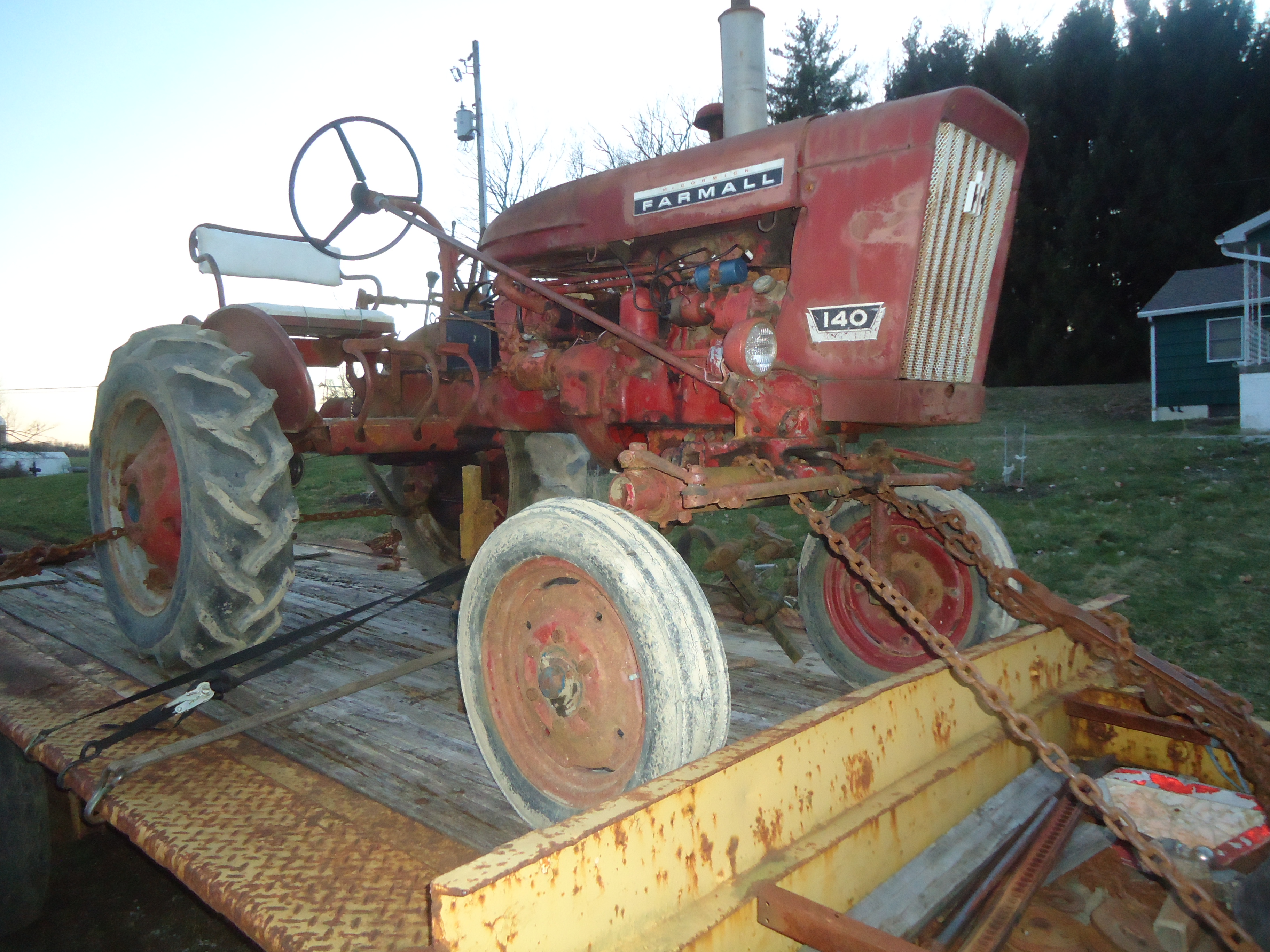

Not nearly as pretty as yours, but it runs great. It spent its life cultivating, along the Ohio River. I'massuming the original owner, not the one I bought it from,had it rigged for cultivating at night. If you look close, you can see a small flood type headlight mounted to the inside of the right differential.
That was removed,and I put it back to the original 6V system, and completely rewired the harness from scratch using a color coded wire schematic I found online. Someone did a hack job 12V conversion, and to be honest, looked like an electrical fire waiting to happen. I bought the proper color wire, and solder type terminals, and went to work. Double shrink wrapped the wire at the terminal ends, just because. Turned out very well.
It didnt have FH, but did find one reasonable near Lansing, MI., and put it on. Newrear tires, and double rear wheel weights, because the plan was to pull the potato digger with it. But,due to hitch height on the digger, and the drawbar being at the bottom of the FH, it wouldn't raise it high enough, so pulled it with my 240. I've since found a single FH prong, I plan to make a proper drawbar to pull it.

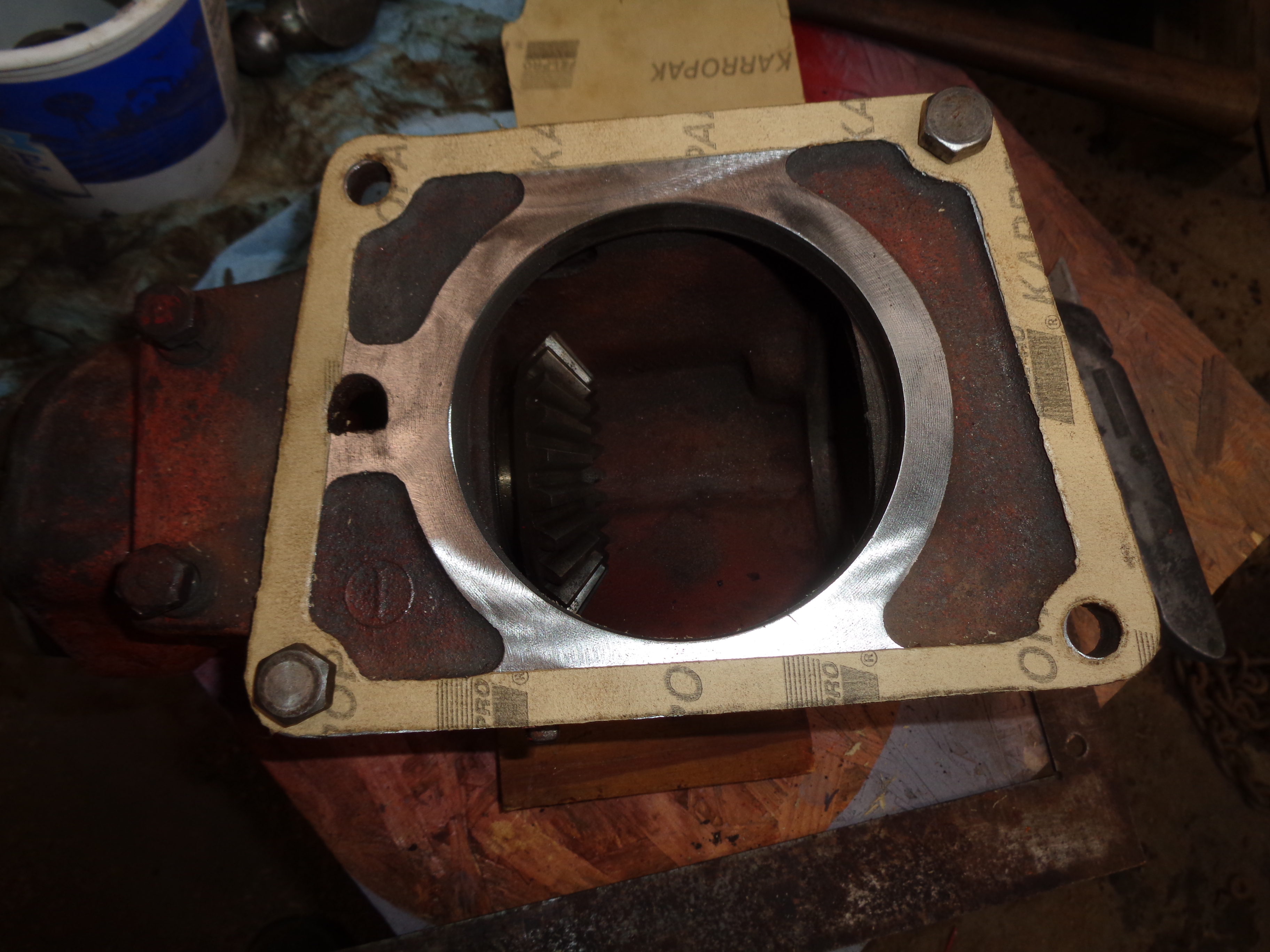

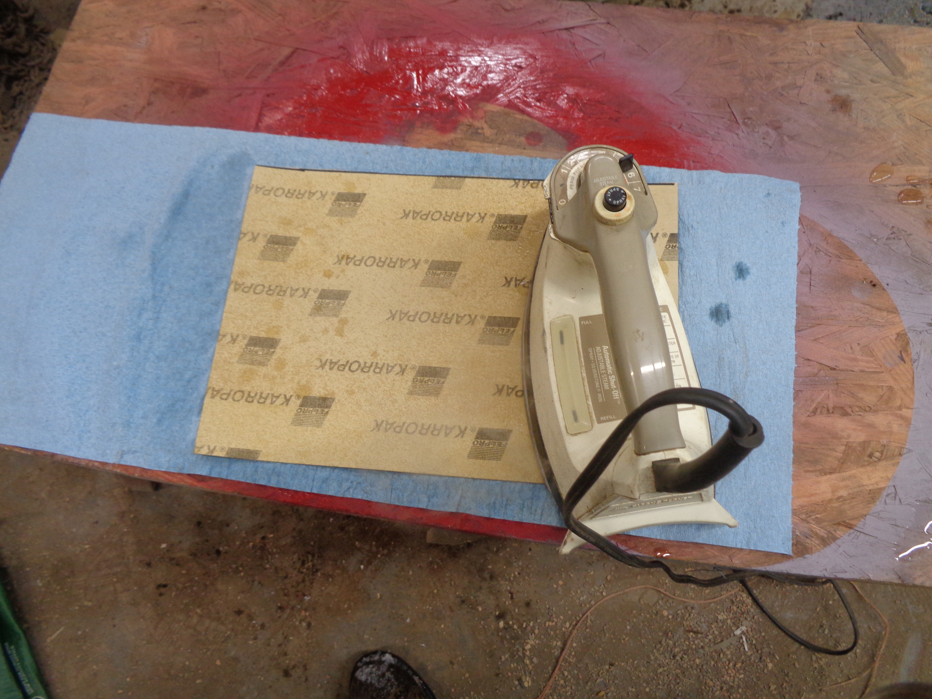

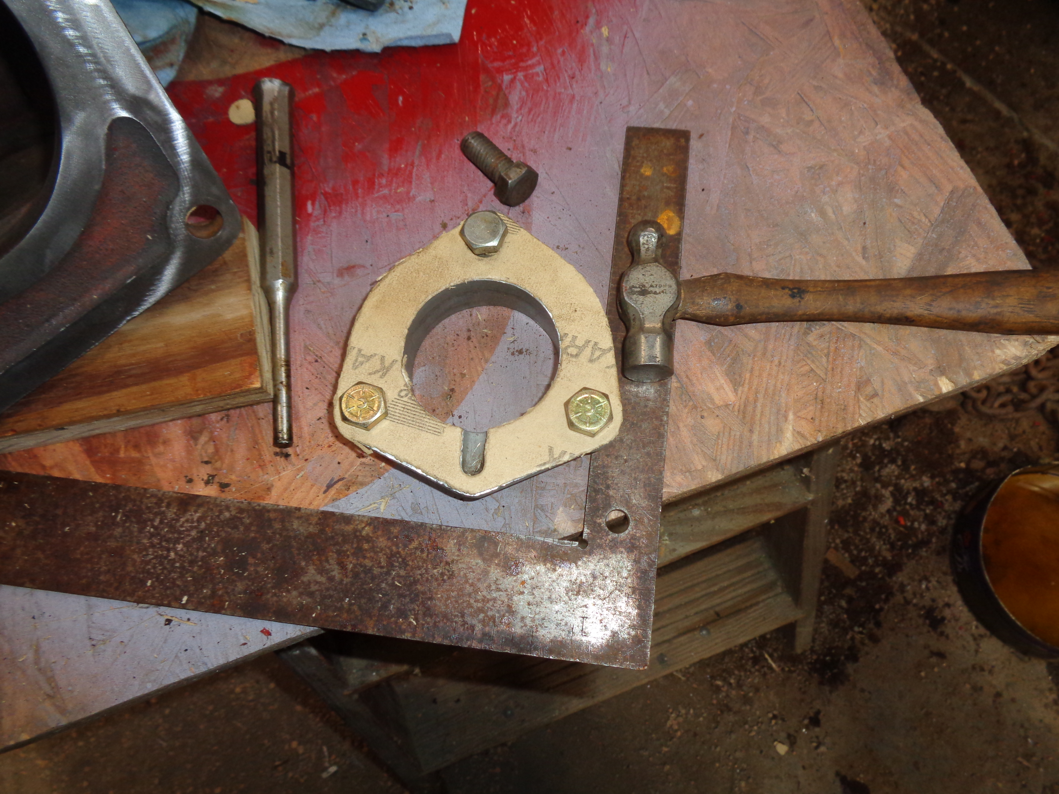

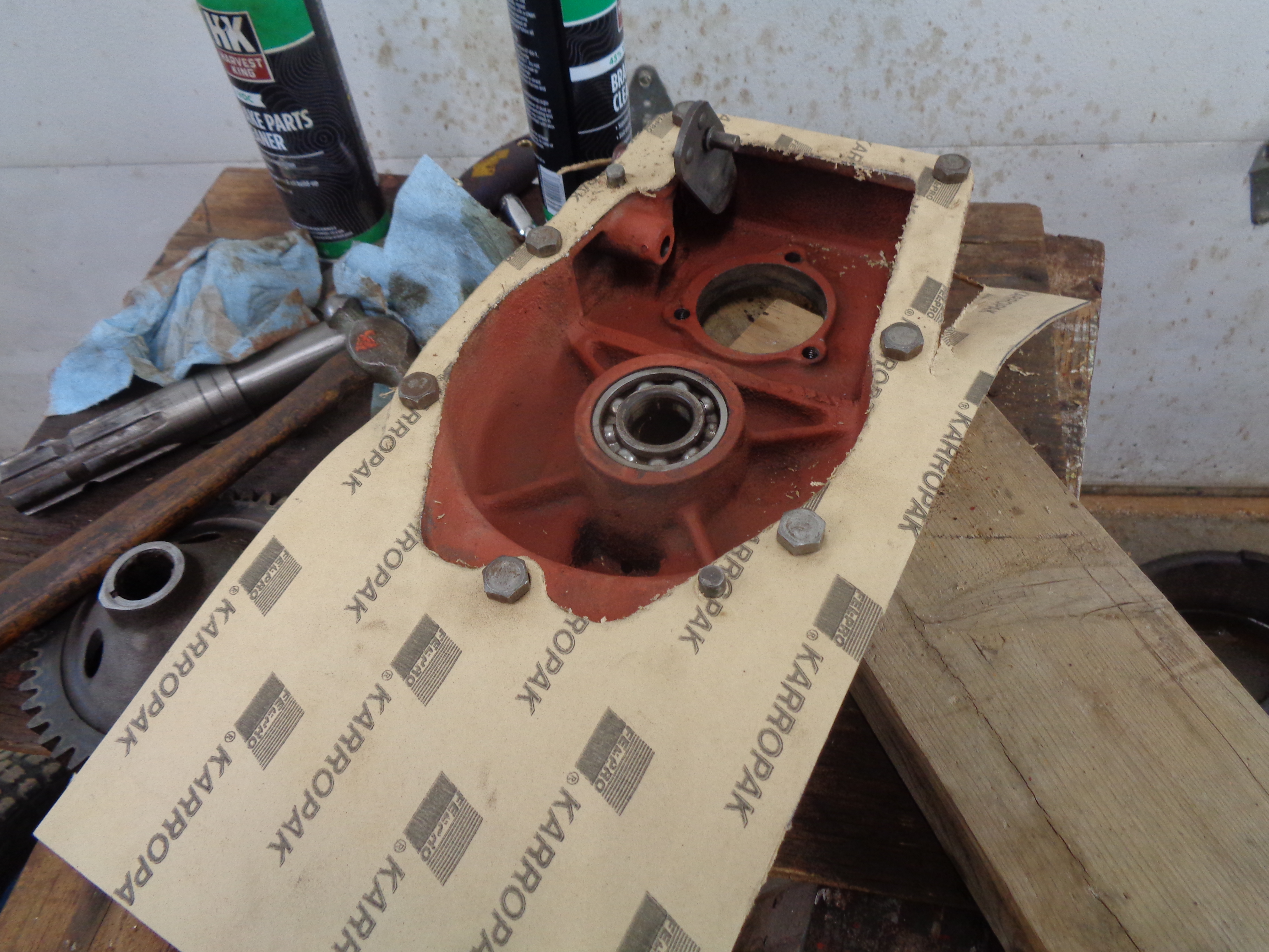

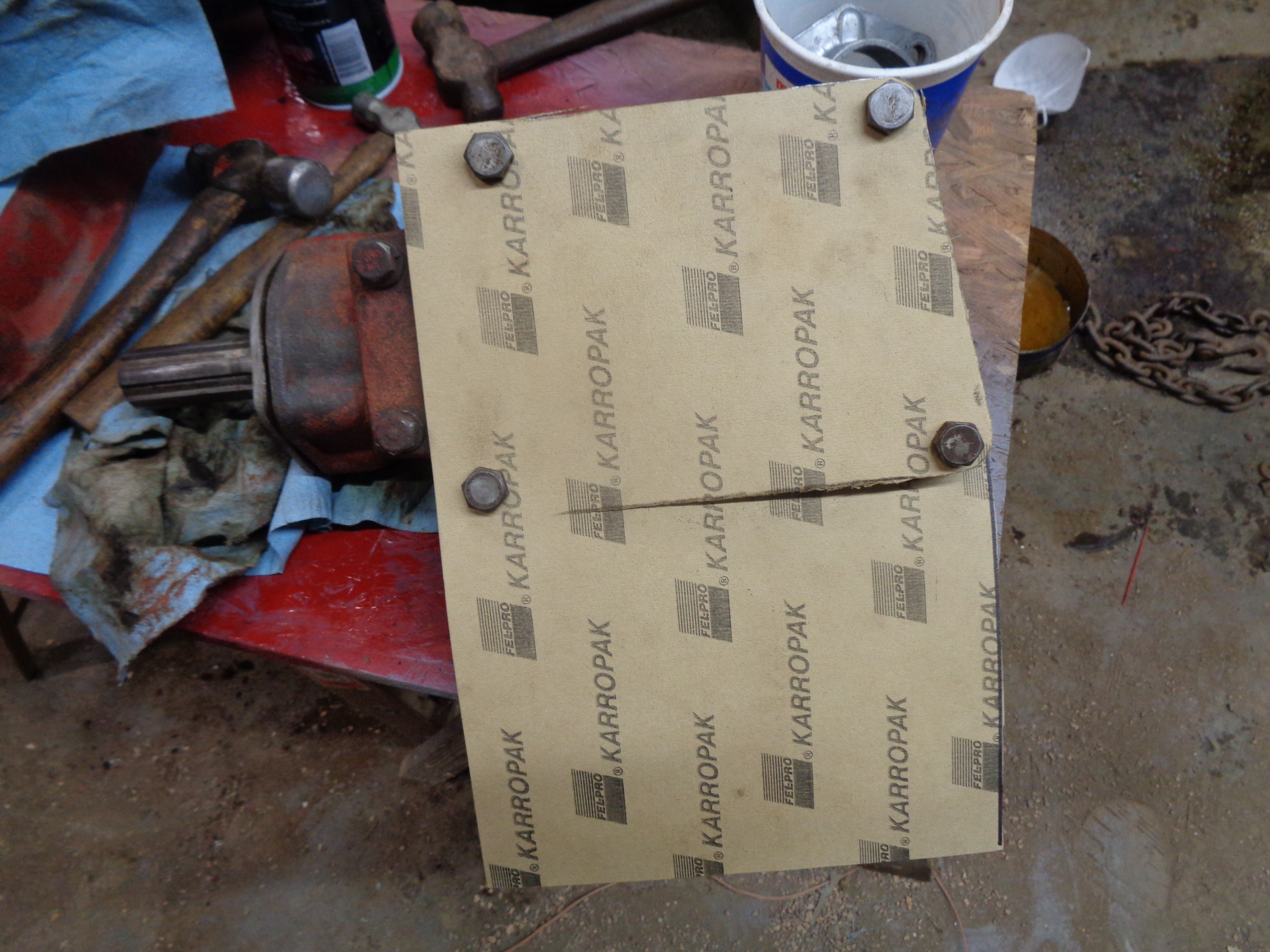

When I did the 140 late last summer, it needed the pto bearings, gaskets, and seals. The bearing I got off a seller here in Ohio, for 1/4 the price of any local suppliers, and they are USA Timken, or SKF NOS bearings. Seals from Rock Auto, and a gasket set from Steiner. This time, since the weather has been nasty, I decided to make my own gaskets, tapping them out with a ball pein hammer. The 18" X 72" rol of gasket material was less than half the gasket set needed from Steiner, and eough material to make 4-5 more sets. I got another thinner roll for like $6, to make other gaskets where the other material may be too thick, due to gear clearance. I mic'd the old gaskets, to be sure to get the right thickness. They all turned out very well, just takes a little time and patience, and several more pointed ball pein hammers. And, a good way to re-purpose an old steam iron, to flatten out the rolled material.
A few of the gaskets on the 130 I reused. Bolts holding the seal retainercaps,and plates were just barely more than finger tight, so no wonder they were leaking. I'd say a PO had been in to it before, and barely snugged the bolts, without torquing them. They pretty much fell off the retainer plates,when I took them off. Sprayed them with brake cleaner, and they look pretty decent. Let them dry onaflat surface, then when installing, used Permatex brush on Prime Seal. It seals very well, but if you ever take it apart, it releases from the surfaces, not ruining the gasket. So far, I figure I've saved around $125 doing it his way. Not much to some, but I figure that's money that can be put towards getting the starter and generator rebuilt. I should get the left finalput back together in a couple days, and will then have to split it, andsee where an oilleak is coming from. I'm suspecting the rear main seal from the type of oil leaking. That I will go ahead and get the felt seal/gasket set. And, looks like the input shaft seal may be leaking too. Hoping just a seal will take care of that, without having to get a speedi-sleeve.
