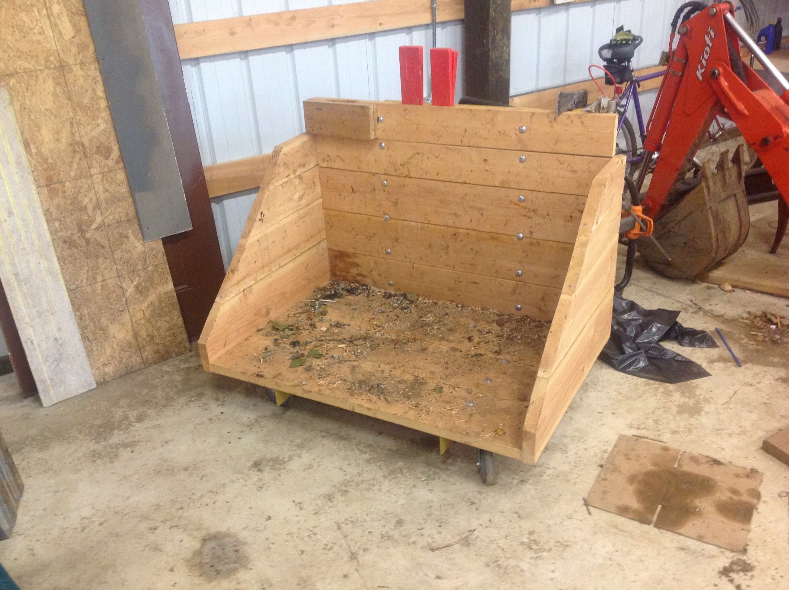

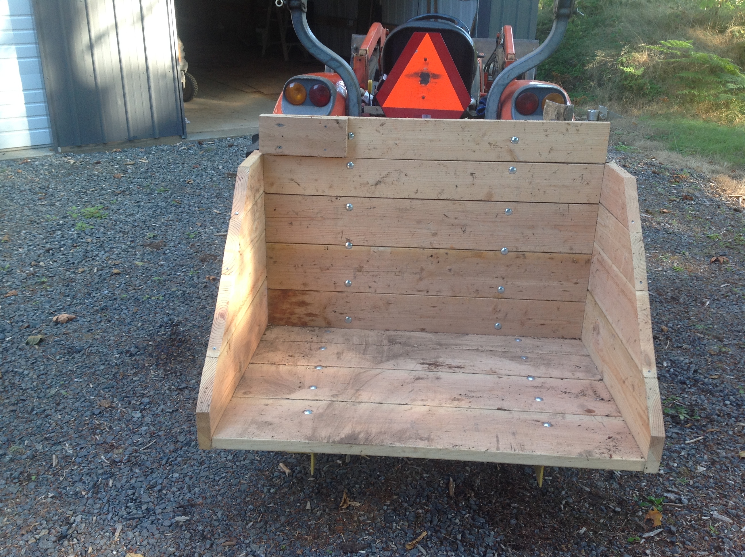

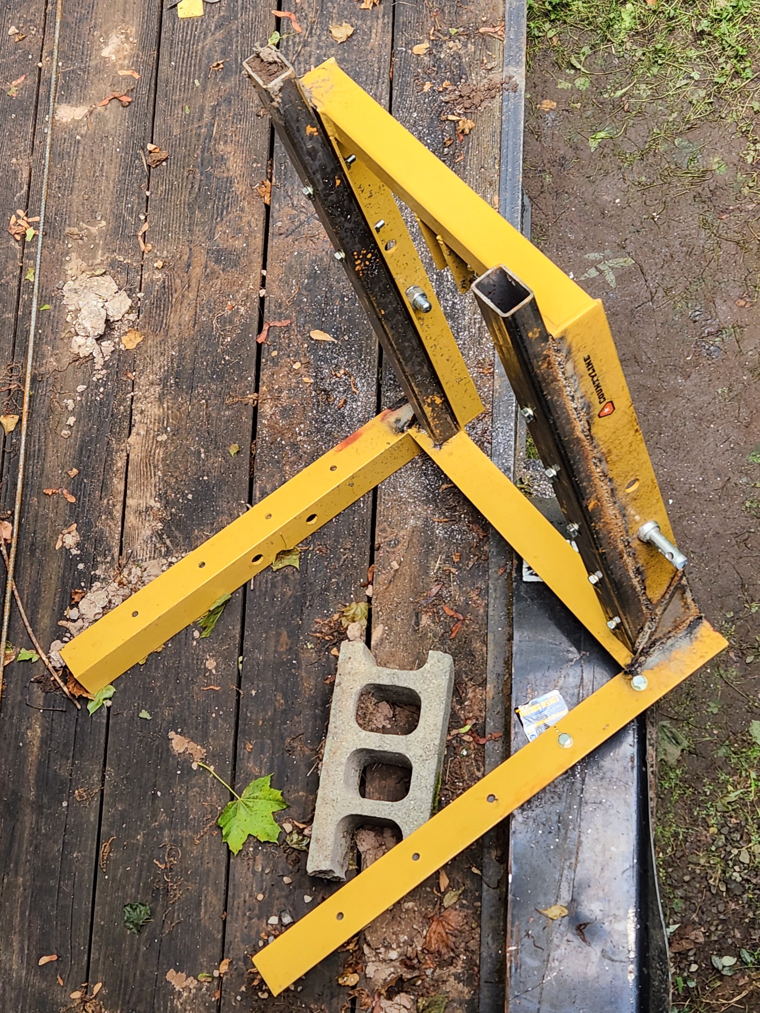

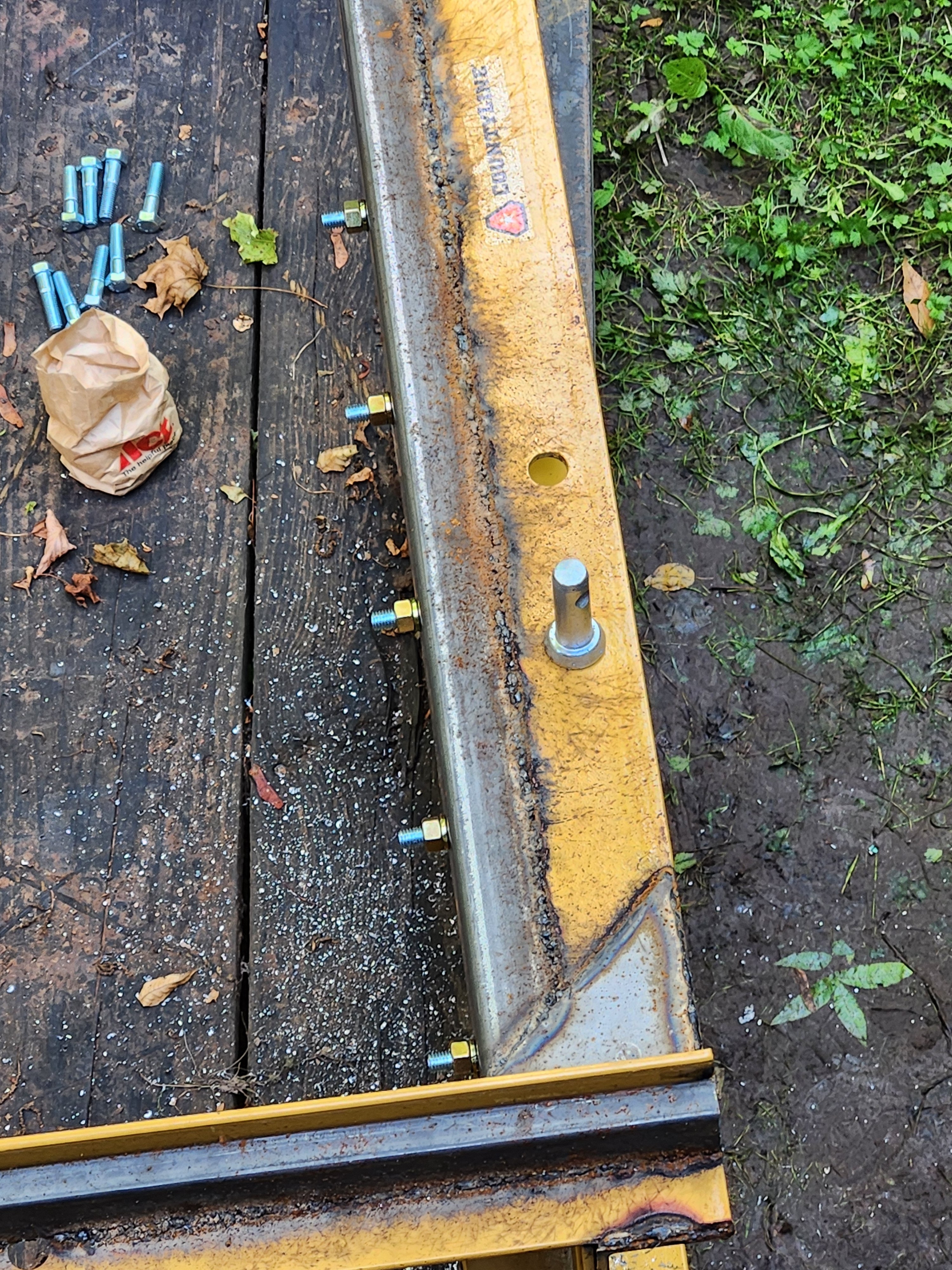

Update:
After a few errands I was able to get started.
Went to a big boxy store to get a series of drills bits that are recommended by a certain utube channel for their price and durability. Then I went to a local store to pick up nuts bolts etc.
I prefer nylon nuts but they only had two so I had with those spring type washers. They didn't have many grade 8 bolts so I went with 1/2" grade 5.
Slow going. Drilling smaller pilot holes, twice. Then larger holes until I got to 1/2 inch.
5 done and 15 more to go. I also got two rattle cans of spray paint today (online) that's suppose to match up pretty well with my tractor.

#35
I got 4 more bolts in today. It was slow going and I reversed the previous 5 bolts I put in. So 9 bolts in and 11 more to go.
Slow on the drill with oil on the bits.

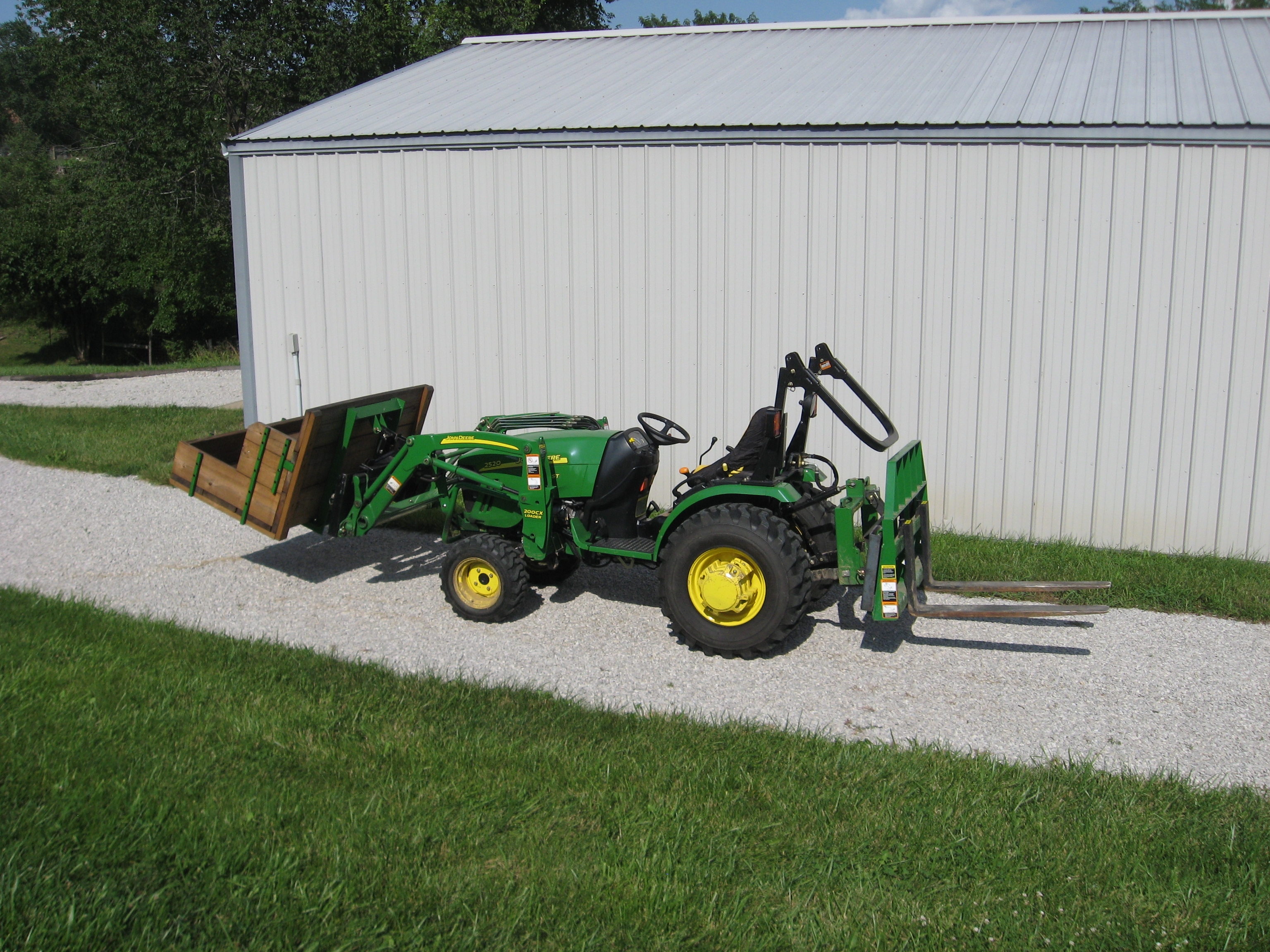

   / Got my Carry All today. #36

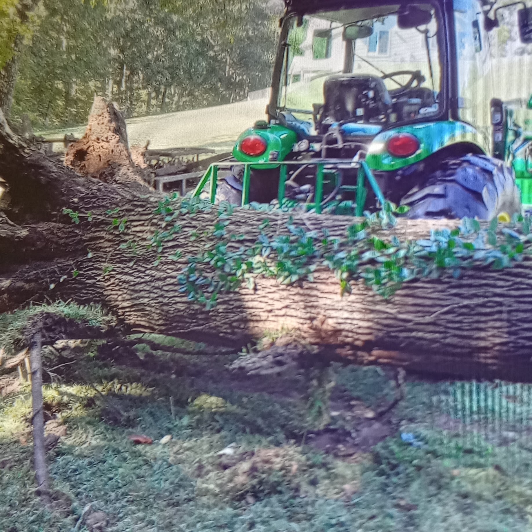

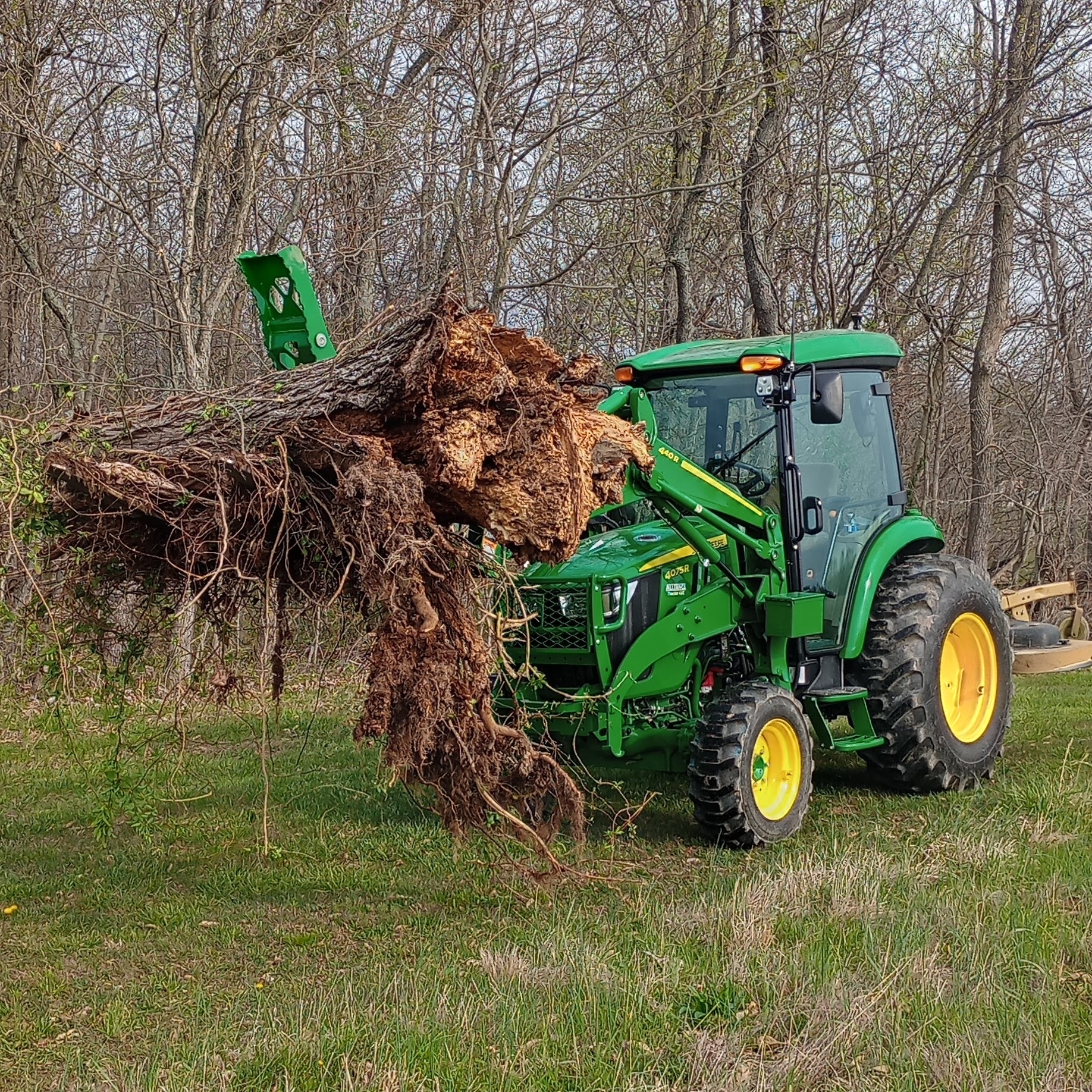

Pallet forks are one of my most used attachments. Add the frontier pallet fork grapple for the complete package. I fabricated mine to also be used on the draft arms for heavy loads, would not be without them

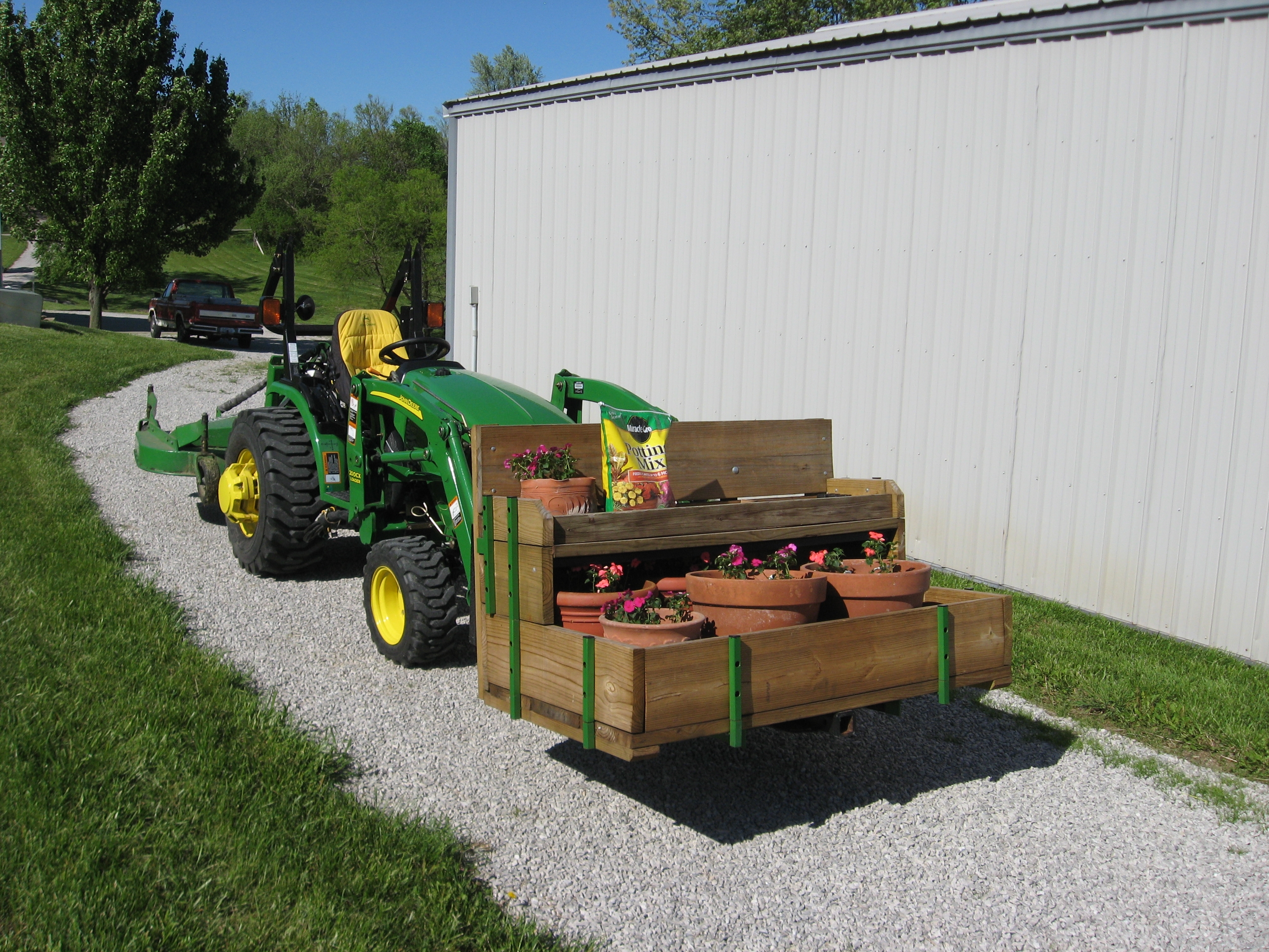

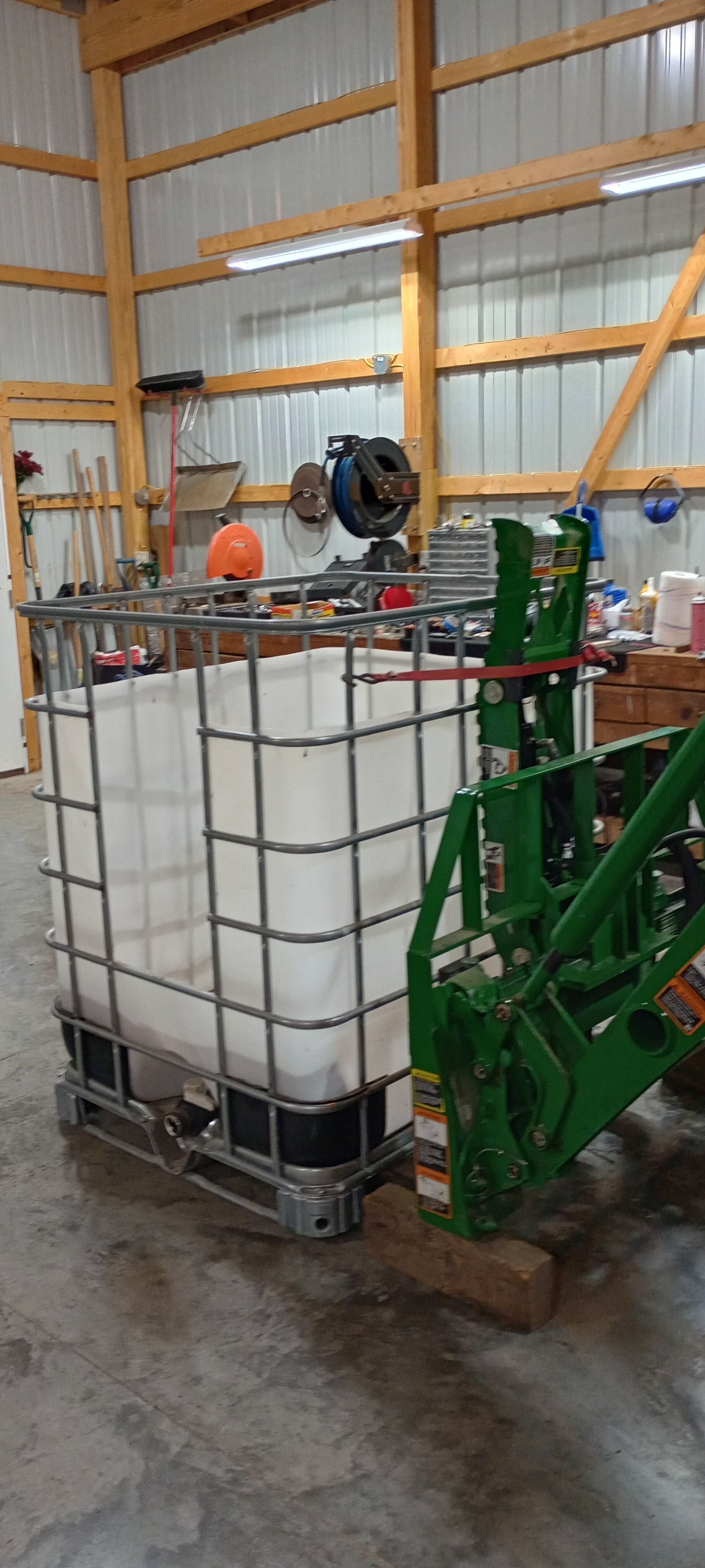

   / Got my Carry All today. #37

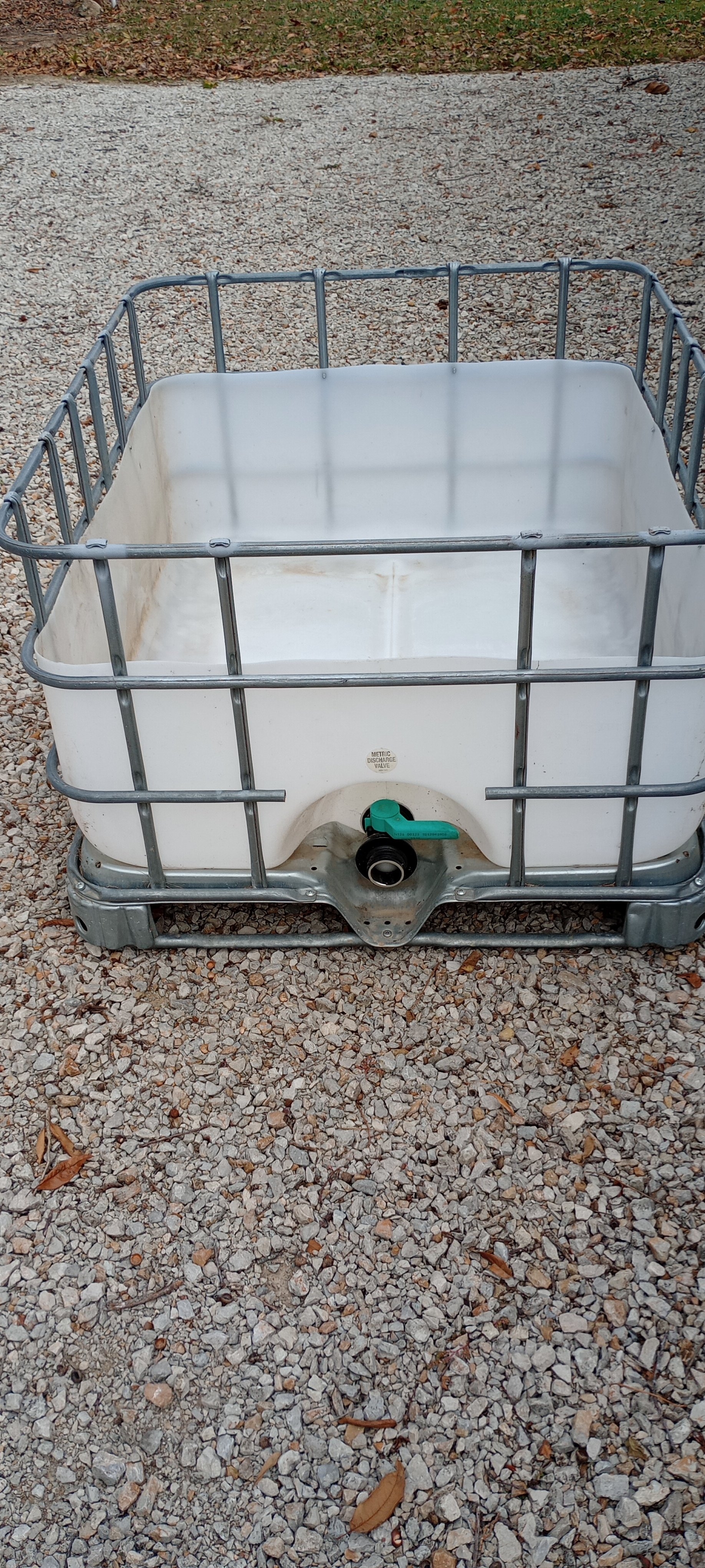

Also as far as a carry all goes you can find these totes laying around for near nothing, they also make a good safe working platform while elevated.
#38
I might use that idea of a tote later on. I definitely want my forks on my carry all to be able to carry different items. I picked up four pallets (for free) and saw a good use for them on a utube channel. I also got two 55 gallon steel drums (10 bucks a piece) to carry water with for the main purpose of filling my plastic septic tank back up when it gets pumped. I know first hand that those plastic tanks will rise, when empty, with a heavy rain. I'm taking no chances. I drained my well filling up a very recent tank install. Had to use my truck, the steel drums, a cheap pump, an inverter/generator to get water from a lake to finish filling the tank back up. I can always use the 55 gallon drums as burning barrels as they age and either get new barrels or use your tote idea.

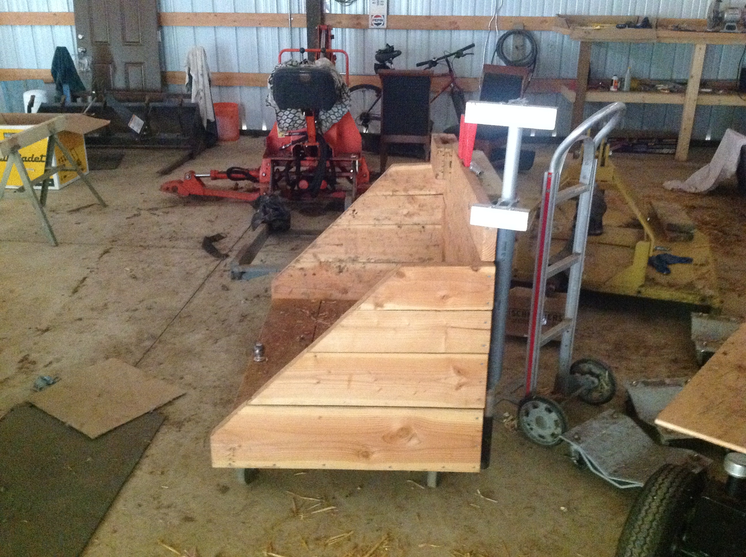

#40

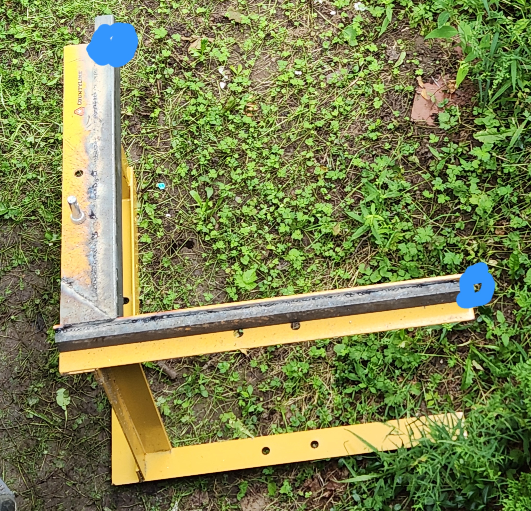

Also, not to beat a dead horse, but if I could run a cable from blue dot to blue dot connected with a turn buckle, that would really add strength. Probably increase the capacity way beyond my tractor's capability.
