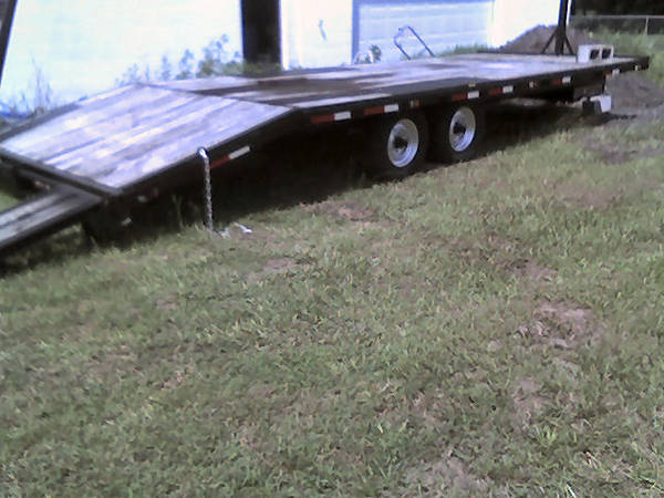

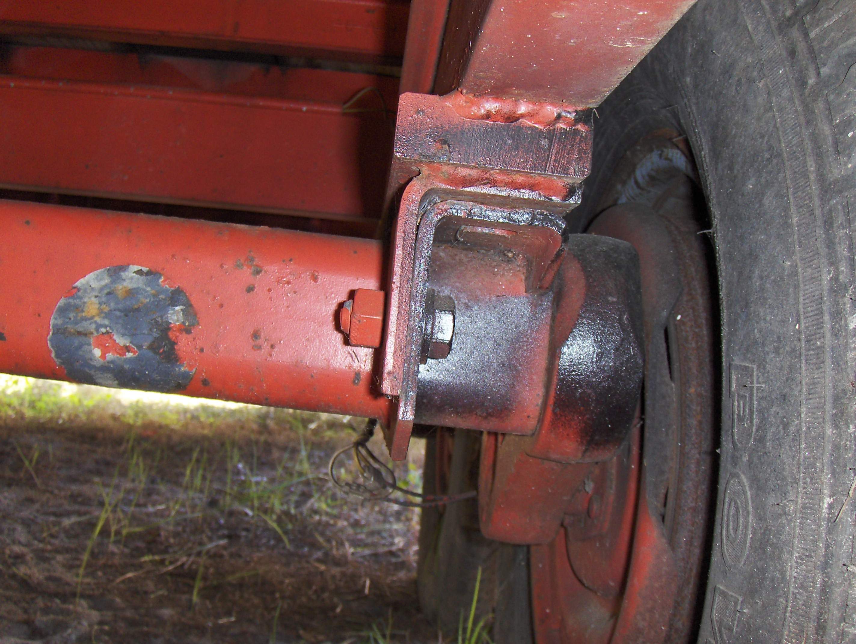

I have a Crosley trailer made in Florida. It is 8 X 25 ft, with 7000 lb torsion axles X 2, no springs. What do you guys think of the torsion axles?
Torsion axles are great. No issues with mine, nor the ones that made me get mine.

I'm personally not a fan of torsion. They don't load share very well and with a load they tend to have a baby buggy ride. However they a good for delicate loads like boats.
   / got my new dump trailer last friday #17
A trailer with torsion axles will ride smoother than the standard leaf type axle. However, on the torsion type if the trailer is not level when loaded...one axle will carry a heavier load while the other axle will have less. That's because with the torsion type, the axles are not connected and sharing the load like the leaf spring type, (having the "Y" connecting the axles to balance them out). That's why my personal preference is for the leaf type axles on a heavy load trailer.
