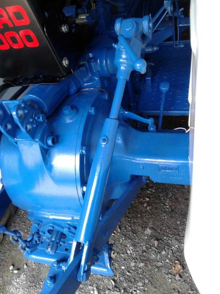

Despite having video of it working on the farm, I discovered one other issue. The crank on the 3 point lift arm, for levelling, I cannot turn.
Any advice on what to try or do you think it will need to be replaced?
Not sure if it's just seized or if the gears are stripped?

There is a good chance that the grease in the leveling box has gotten solid. You can take it apart, but getting the pins out can be fun. Use lots of penetrating oil, a brass drift, and a 5 lb. hammer, and you may need the ole flame wrench but they will come out. You can then inspect it and hopefully only have to clean it out, replace and put fresh grease in her.

I have found that most of the time the rod has rusted in the fork, on occasion I have found bad gears but 9 out of 10 it has been the rusted shaft.

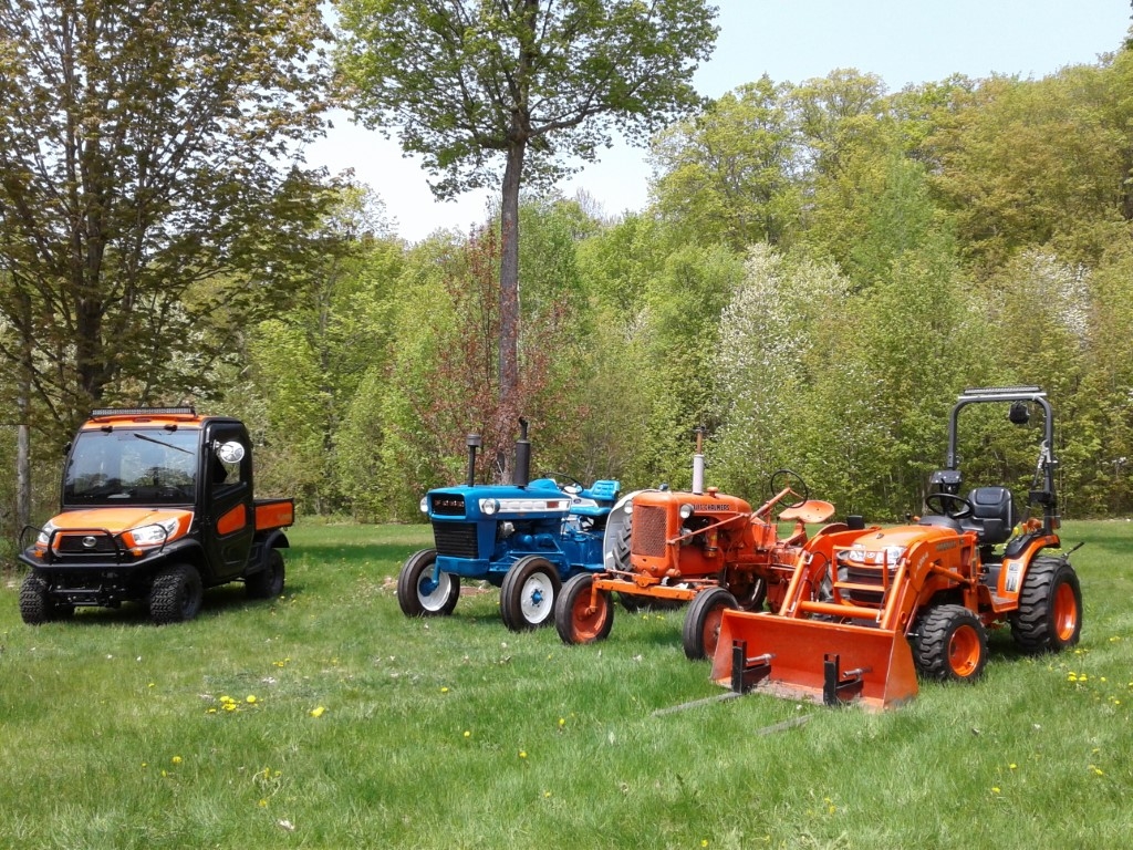

Had to take them all out today to reorganize to get them all back in inside under roof so lined them up for a family photo. Only ones I didn't take out are the two Massey Ferguson 7 lawn tractors.
