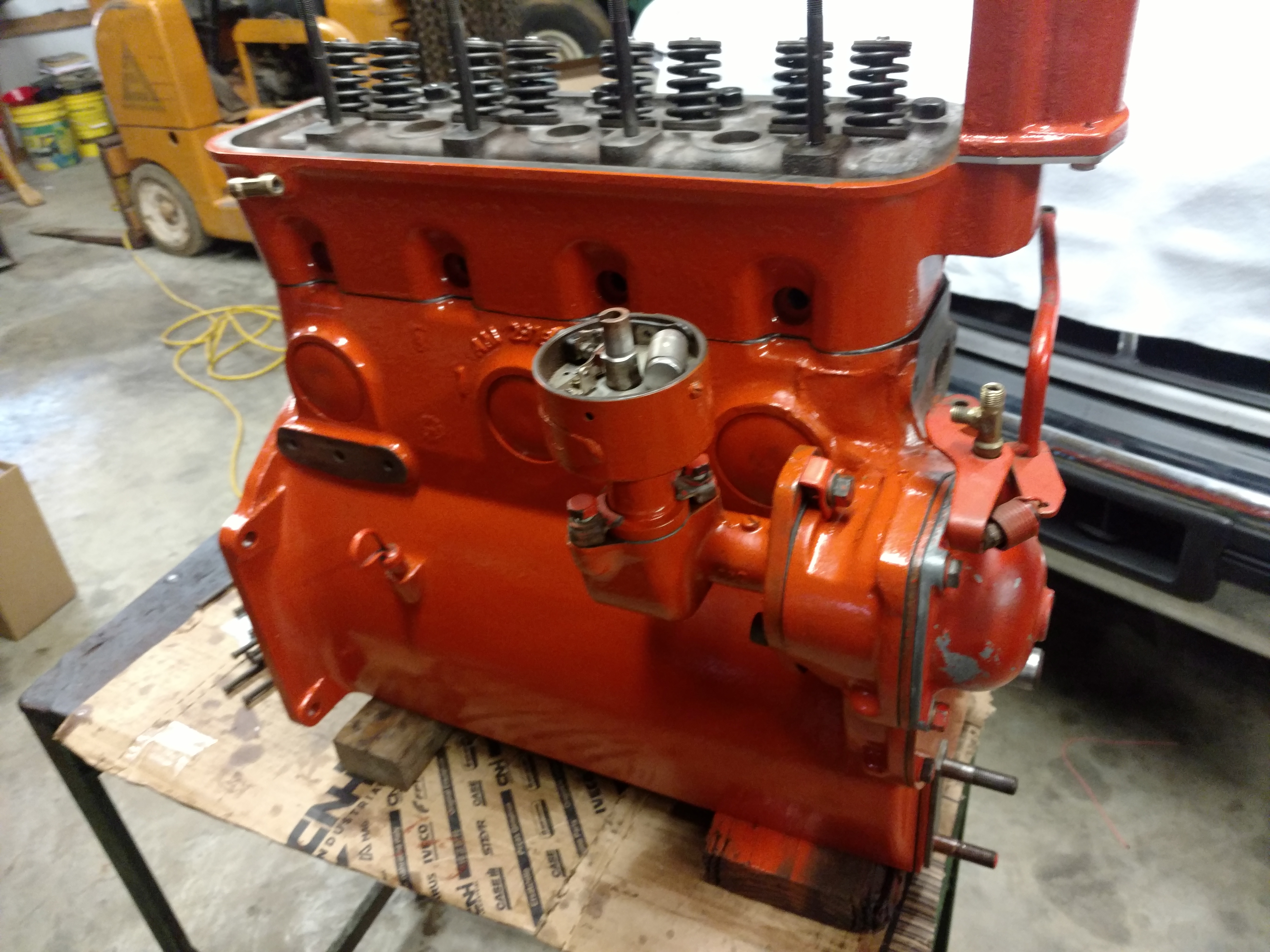

This has been a hot summer project and summer left yesterday so we got the sleeves back into the block and got the crank finished today and the pistons loaded. Hope to get the head on tomorrow.
At age 3 in 1954 I played on Dad's Model B and started driving it when I was 5 while he was picking corn by hand.
I have no way of knowing what age it was but this 1948 is very similar except it has like a 50 year old Wood's belly mower on it. I bought it non running. It turned out the nearly empty bottle of Liquid Glass stop leak in the tool box had made its way into the crankcase. The bearings were nice and shiny but very thin. I have learned so much about this 19 HP engine over the summer. The machine shop saved the crankshaft and head. I cleaned up the sleeves and pistons and we are reusing them. I had to find a used rocker arm due to the Liquid Glass in the motor oil.
I am looking forward to hear the 70 year old tractor run.

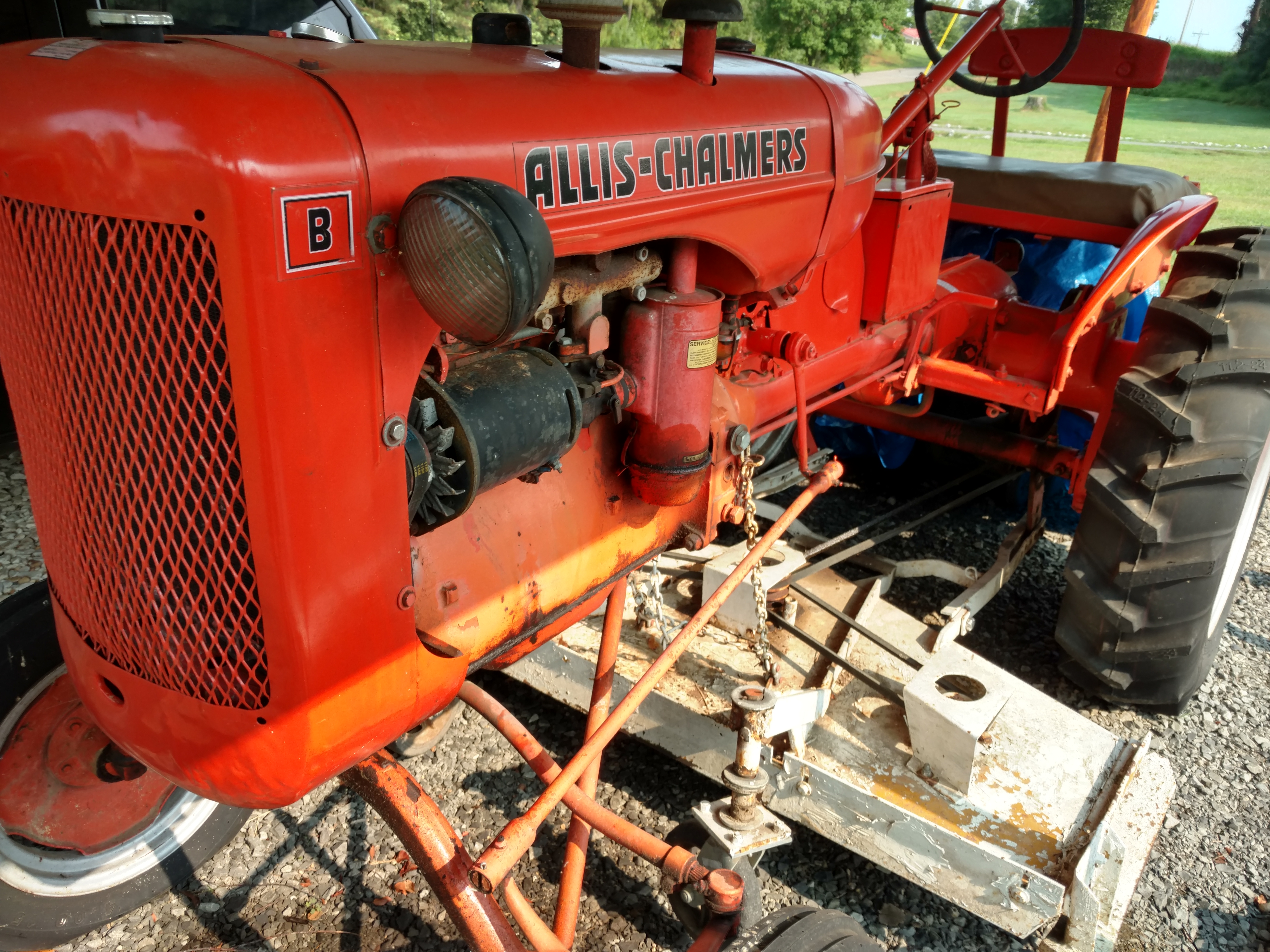

I have worked it about 5 hours but today we put the skin back on it and got the lights wired. Now it is read for the Veterans Day parade Sunday week.
We got rid our our Model B in 1957 or 1958 for a Jubilee Ford (600) and I never thought I would own the tractor like I played on when I was 3 and started driving when I was 5 when Dad was picking corn by hand and got tired of getting off and on it. :)
The oldest son got put to work early but I guess it has paid off over the last 60+ years in one way or another.

That is a real nice lookin B!!!
With that belly mower: it's not just a parade queen. It can work!

Well coolant started to getting into the crankcase. Head gasket proved to be fine. Sleeve O rings proved to be fine.
Sleeve #4 cracked around the two lower O ring grooves. We had reused the old sleeves and pistons. After the first 5 hours we changed the oil and it was free of coolant so not sure when it cracked. That is a very thin area of the sleeve.
We have the old sleeves out and the block washed out with gas as of late last night so after a dry inspection we plan to order a new sleeve, piston, rings rod bearings and sleeve o-rings set.
The shop owner let me clean up and hone the old sleeves so I got a lot of first time experience going that deep into an engine. Wish this had not happened but on the redo we are going to revisit the steps. For some reason one rod bearing had a small hot spot showing. They were all at .002 clearance per Plastic Gauge. The crank looks clear rod wise. We did not drop the crankshaft caps.
I wanted to go with the standard 3 3/8" bore but it looks like the thinner 3 7/16" over bored sleeve kits are the only option. I am more concerned about forces on the crank than engine HP.
This time I plan to start with the Archoil AR9100 from the first fill of the crankcase and may just go with the Rotella T6 5W-40. The last time I ran 15W-40 diesel oil without the AR9100 for the first 5 break in hours.
