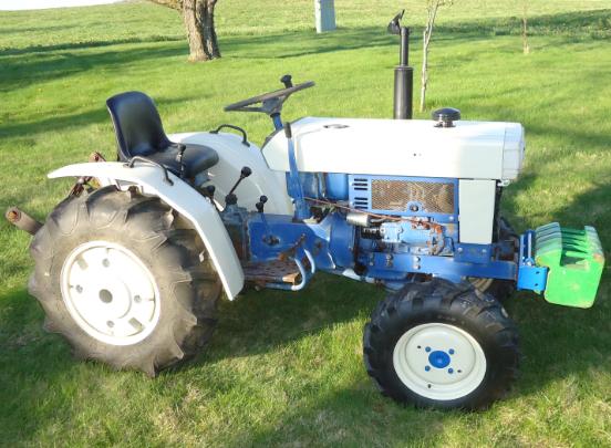

Here's was the setup I had. I'm thinking someone made/screwed with it. It had cat 0 lift arms and the pivot was welded to some angle with the drawbar. Notice the pto guard is missing and won't fit with the "retro". It had the cat 1 pivot rod mounted underneath
I removed all that and put the kubota arms 22 1/2" center eye to eye length. I have a standard cat 1 drawbar from TSC 26".
It clears when down, but half way up it puts the lift arm into the tire
And I want to add that I flipped the rear wheels so I have an additional 3" of clearance on each side. I could put a 21" drawbar on it and that would fix it temporarily, but that doesn't help with my box blade or scraper blade issues...

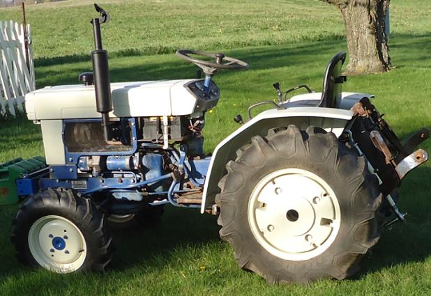

Here's how it looks with the rear wheels flipped
Left side flipped. Right side standard
I flipped the front wheel to see what it would look like and to see see about putting some front wheel weights. I'm not going to flip the fronts bc it's too wide and I'm just envisioning an axle breaking from the extra stress from the wheel being out so far
