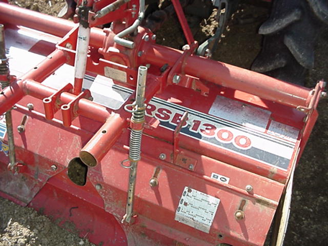

gws, I have basically the same set up. Mine is an 1820d with the 1300 tiller. I routinely take this tiller off and put it back on several times a week. I do tilling on the side for a few extra dollars now that spring has sprung. I also do leveling and grading with my box blade. I have no problems hooking my tiller up.Takes me at the most 15 minutes. I carefully back to the tiller. Get to the point that the shaft lines up. Slide the coupler onto the tiller side splines, then slowly back it on till the lock pin will seat. I then hook one side of the lower arm and finigle with the hydraulic lift till I get the other one lined up. I generally kick with my boot and shove a bit on the tiller. Last of all I hook the top link to the tractor and then adjust the top link length as necessary. Make sure that your connecting links to the bottom arms are in the tiller holes! This method works for me very well and i have virtually the same set up as you do. rccoyote

I forgot to add in my earlier post the use of one of my most important tools, a 5 lb sledge hammer with a short broken handle. This persuader makes left and right adjusting much simpler when installing the lower arms on the tiller.

recoyte,
So you just keep the two shafts assembled and then back the tractor in and hook it up? I've been getting the tiller on the 3pt and then trying to align the splines while bending over, and fighting thorugh the plastic shields, very hard indeed. bw
