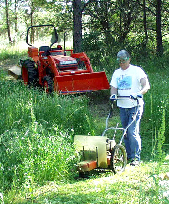

<font color=blue>I don't remember which one you have.</font color=blue>
Neither do I, Bird.
The darn thing is sitting just a few feet from my tractor, but I'm 120 miles from both of them.
It's a fairly high-end model, 6.5hp (I think) with electric start. I've attached a bad picture just in case you can tell if it's similar to yours. You're right, mine can also be started with the pull rope, and it stops when you pull the throttle lever all the way back.
I'll have to take a look at the wiring and cabling to see what you're talking about. Remind me next time I'm up there, okay? /w3tcompact/icons/grin.gif

Harv, that looks like the same machine as I have, although it probably won't make any difference. Regardless of which one you have, it will undoubtedly have a number of wires with a connecting plug that can get dirty and lose contact. I'd consider it a bit unusual, but certainly not unheard of and I should have thought of that right off myself. Mine is the 6hp overhead valve Briggs and will be 4 years old in a couple of months.

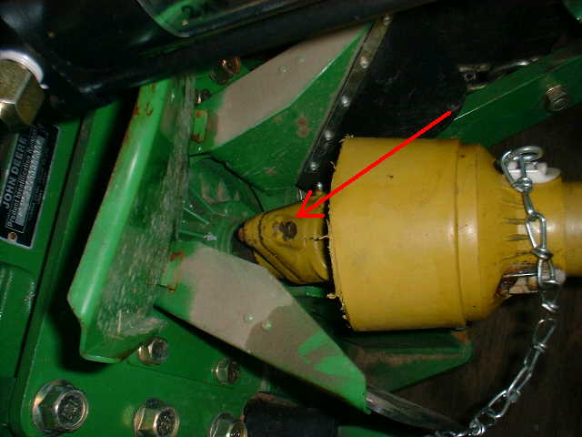

Don't feel bad... I went through almost the same thing /w3tcompact/icons/laugh.gif. Anyhow, attached shows where mine is... and sounds like yours is there, too.
