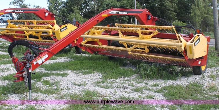

A New Holland 499 center pivot is hydraulically driven hay mower.
Came out in 1983 and is still in production today, I believe.
Might be the most popular hay mower of all time. Theres a hydraulic pump on the tongue driven by the PTO.
   / GPM for a hay mower #18
There are several haybines and a few discbines that are hydraulically powered,
however none of those are powered by the tractors hydraulic system they all have there own PTO driven pumps.
Then most of those are also the hydra swing type that will trail behind the tractor going down the road,
then when you start mowing will swing out to either side of the tractor.
So you can pull into the field swing it out to your right side, do your head lands, turn around and do your back swath,
then start down one side, turn a 180 and hydra swing to the left side and mow right back up the same side, get to the end turn 180 swing the mower to the other side and repeat till done.
So they do usually require two tractor remotes one two for the swing cylinder and one single action or floating for the header lift.
