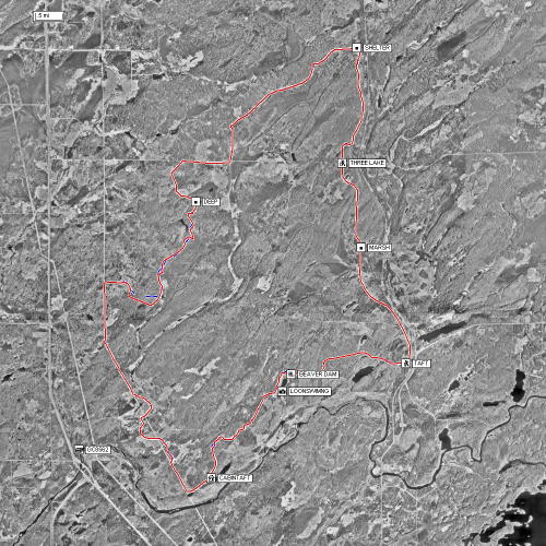

Here is a small pic of some of my trails that I have gone on. Had to reduce it from 9 meg to 100kb so not sure how it will turn out.
