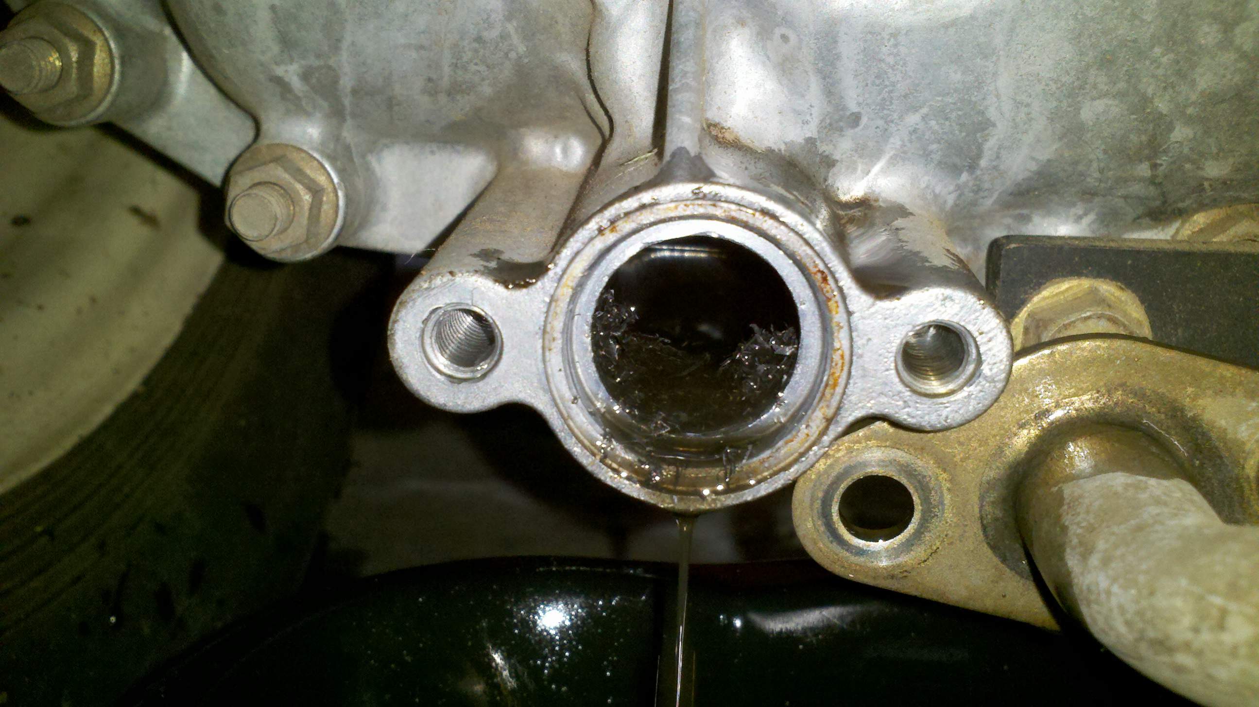

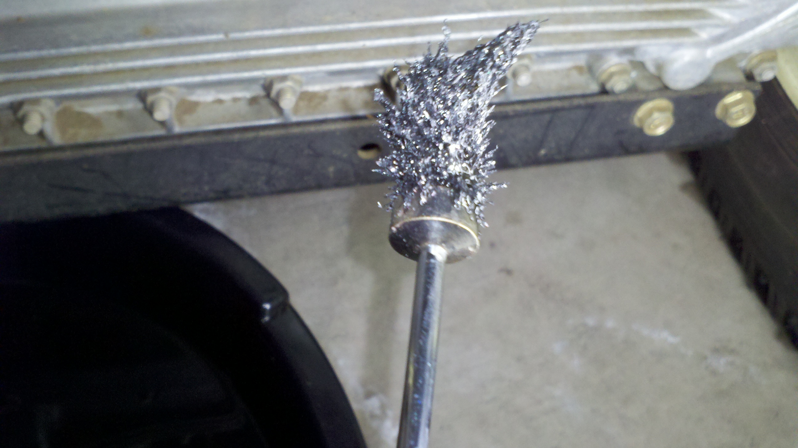

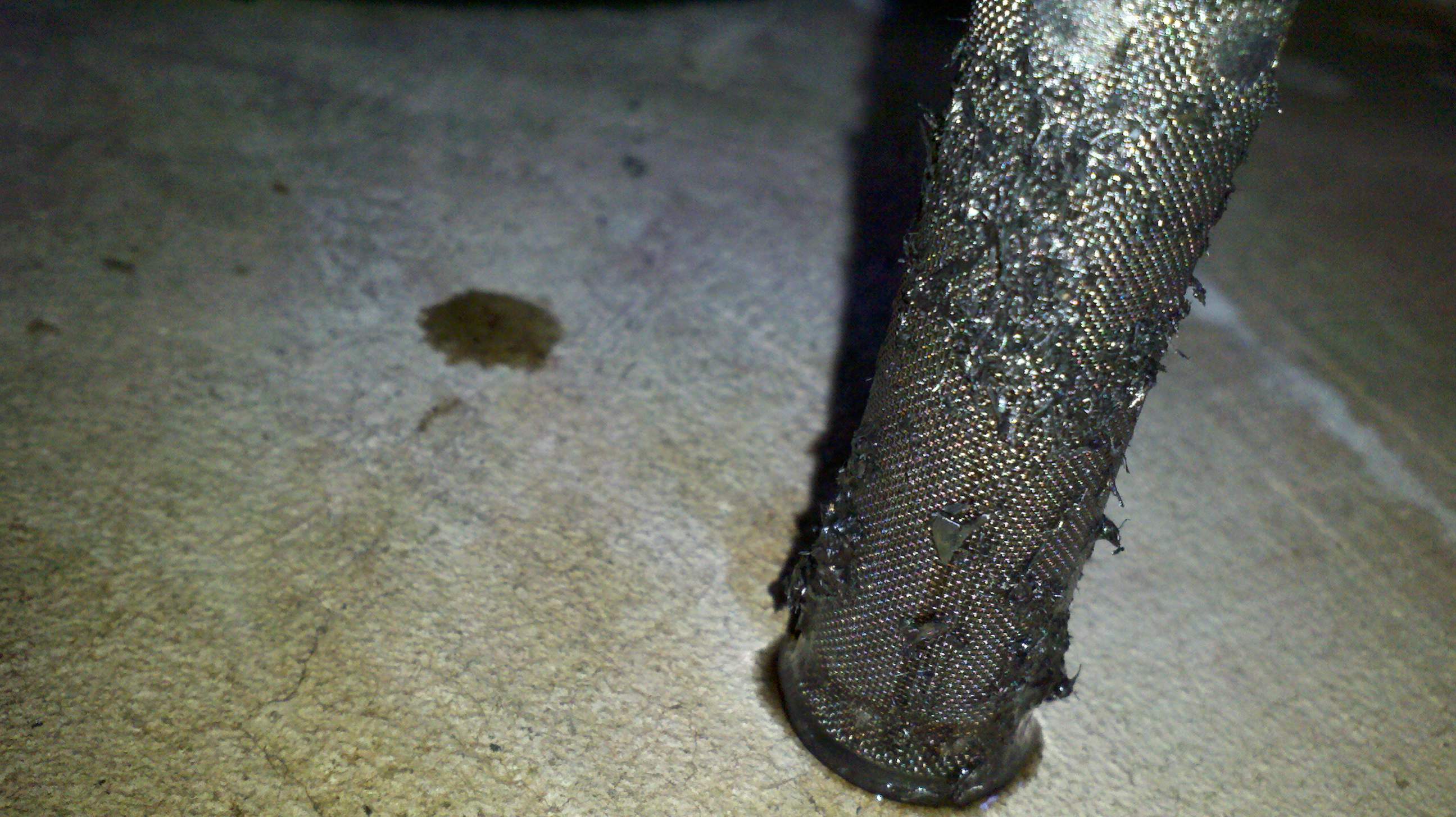

I am curious if you put a magnet in the the hole after you took the strainer out.

Where is the strainer located and

If you look below the fan in the back of the unit. It should be right there.
There is a long metal tube that comes down and two bolts hold it into the casing. The first picture is where the screen is. The tube to the right is what attaches to the screen area. You just pull it away and the screen is inside there. I would get a magnet and put it inside first, then pull your screen out and put the magnet in there again.
Not sure how to adjust the PTO. They told me that was the first thing to go if failing. Since this is mostly hydraulics it either works or it doesn't.
