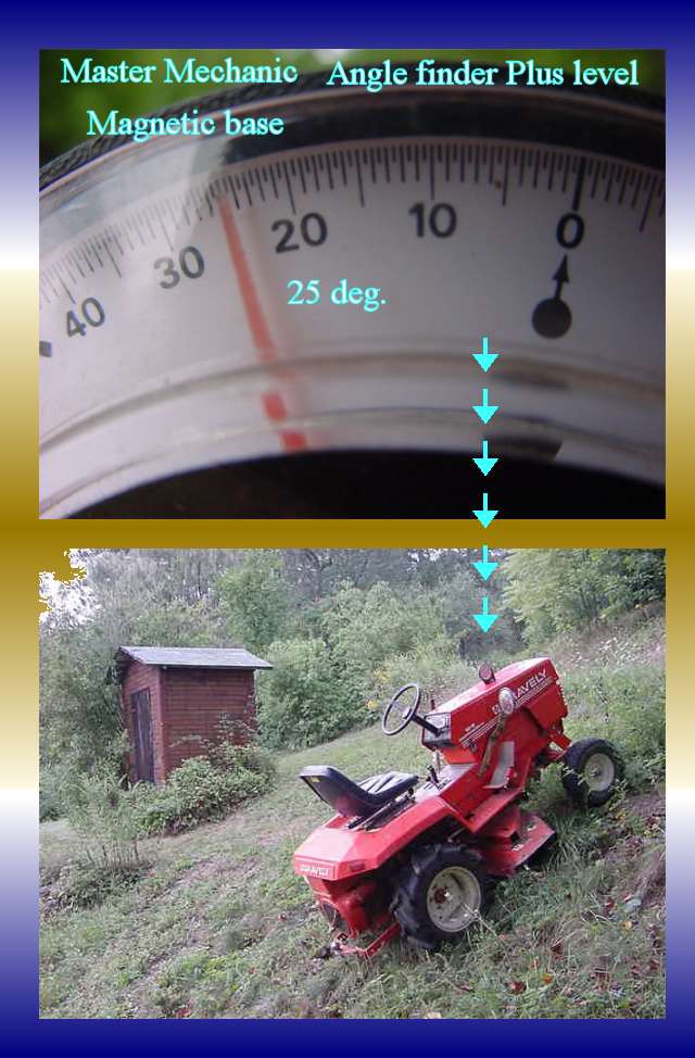

Just to put some things in prospective this is a 25 degree incline....what is being referred to is a 30 to 35 or more degree incline....huge difference
I cant take any credit for the picture other than borrowing it from someone else (kevin) - its a great shot
