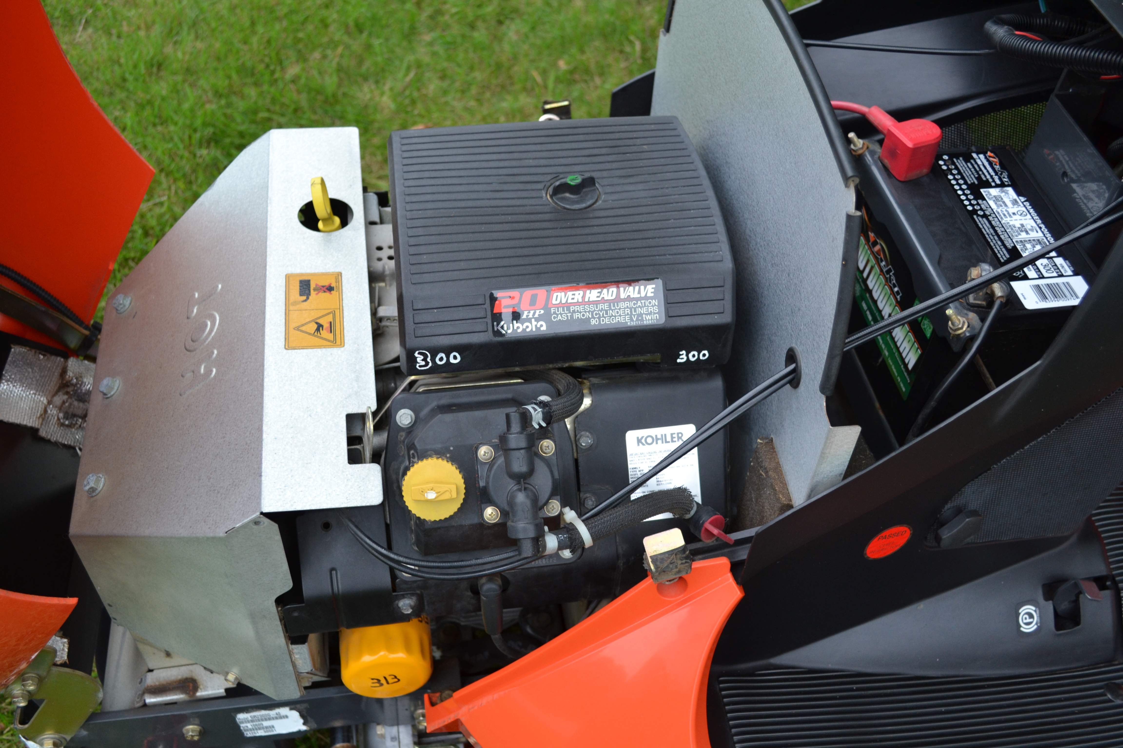

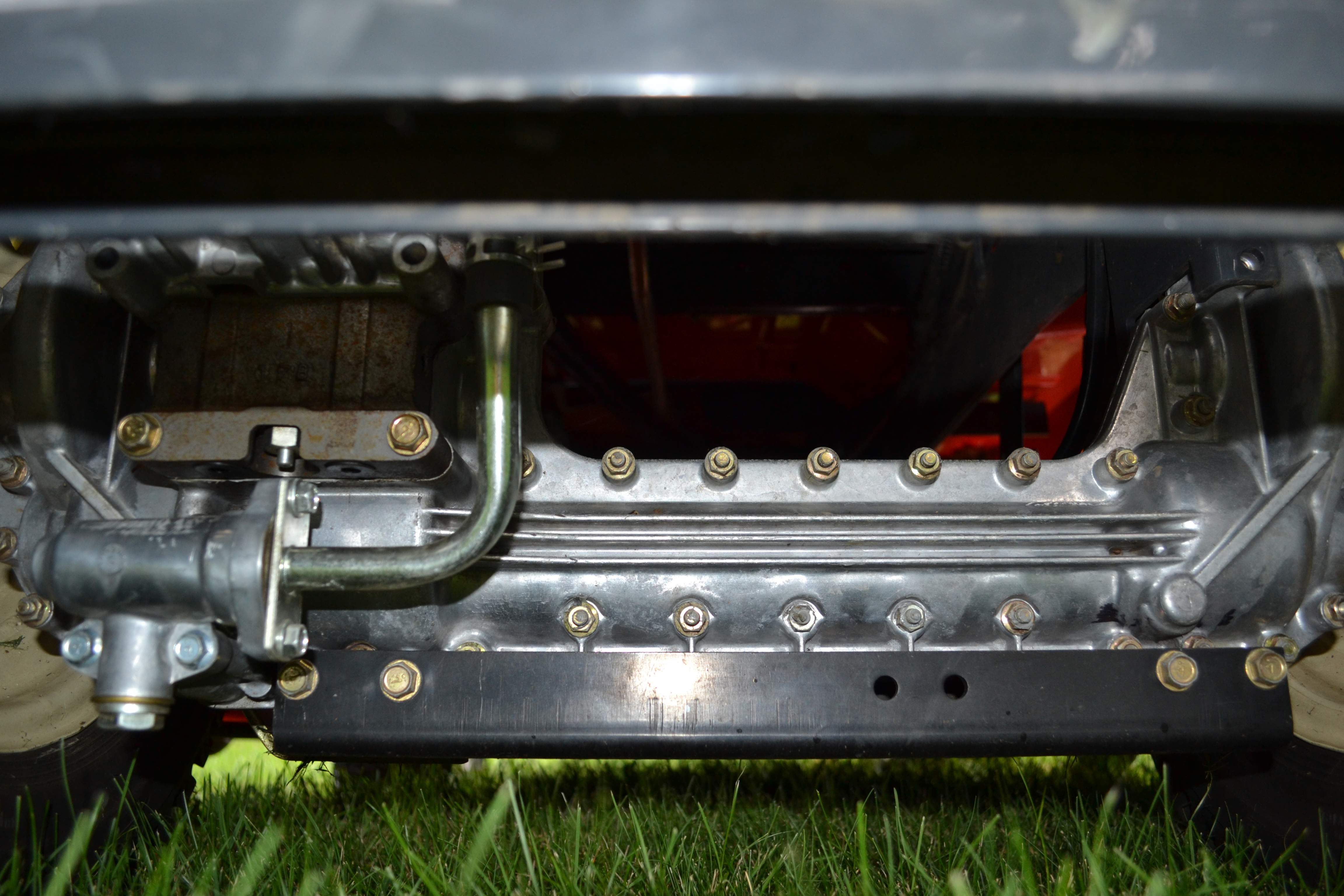

I went to look at this 2007 GR2000 yesterday, I drove hours to get there and this "Garage Kept" "Like NEW Condition" was a big disappointment. I felt bad for the son that was trying to sell this for his widowed mother. However he had not a clue on how to present something to sell. I won't even get into all that was wrong with it.
You need to remember just last Friday I sold my 2005 GR2000 with twice as many hours on it and twice as clean for $3600.00 I didn't even make an offer. They wanted $3400. It is worth $3400 to them but I knew what my machine looked like and this was far from it. Oh well.
On the way back I stopped at two Kubota dealers and called two others and there just aren't many used Kubota's. Actually none.
The dealers you do call have used machines on their website but when you call them they mysteriously have none but want to sell you a knew one. Hmmm!
I'll keep looking.

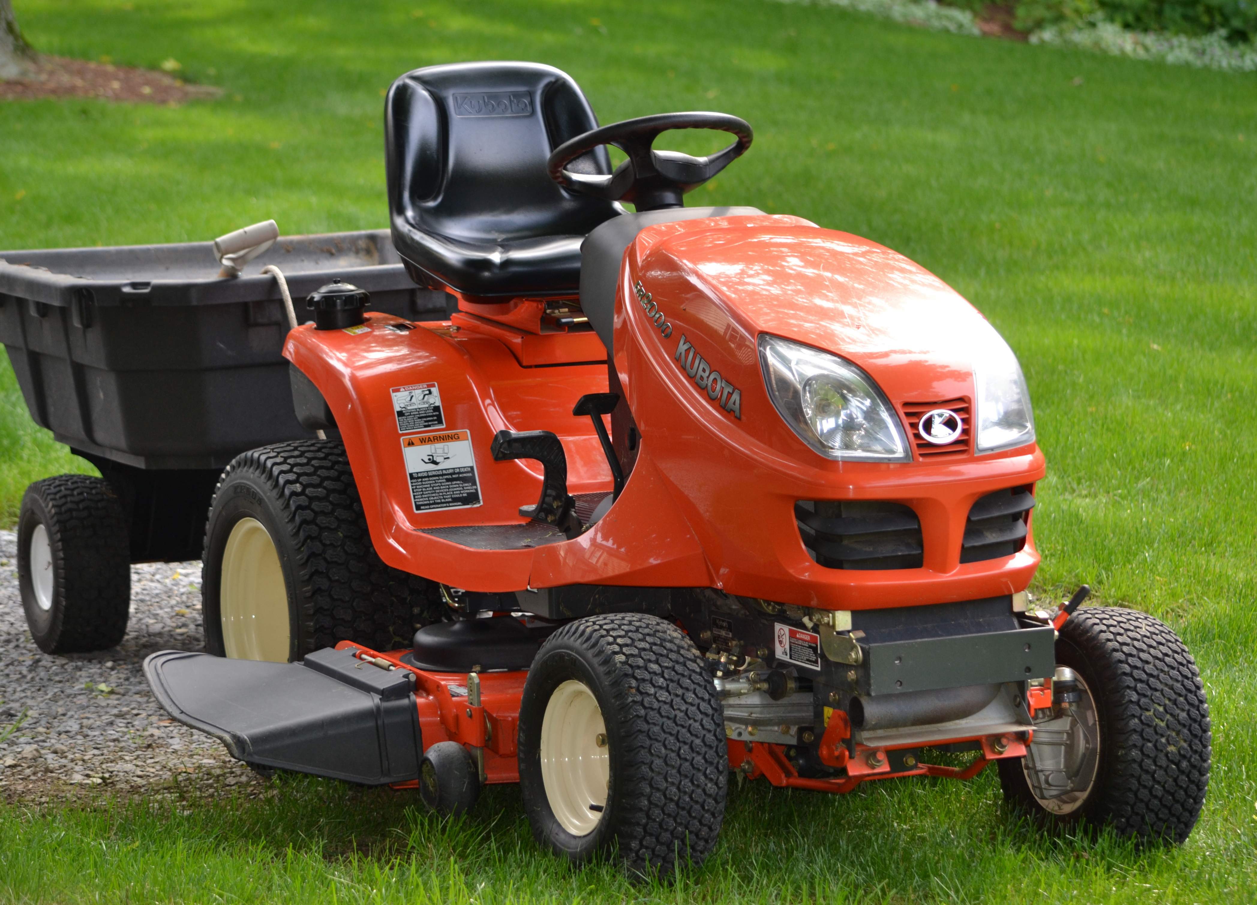

Yes, they are all 4WD, then as you turn, the inner rear wheel clutch proportionally disengages. See attachment.
This is how I modified my discharge chute.
Philip.
