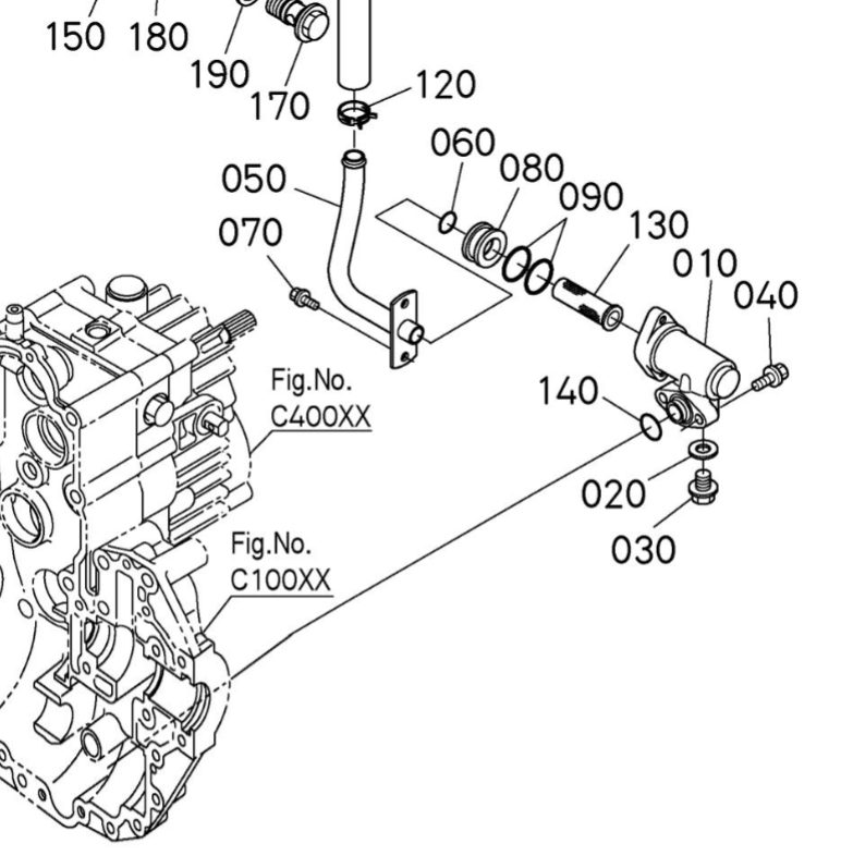

Doing the 200hr maintenance on the GR. Manual seems to suggest just pulling the suction hose and sliding out the boss and strainer for cleaning. No way. That sucker is tighter than a bull's backside in fly time.
Pulled the whole strainer housing but don't see a way to pull or push that boss (#80) out. Be most pleased if someone would point out what I'm missing.

I don't think you're missing anything. I don't have direct experience with that machine, but I would be inclined to either gently pry on both sides of the bushing, or perhaps fashion a 90 deg or hooked tool to tug on it. After disassembly it's just held in with (2) O Rings.

My thinking as well. There's no way to pry externally that I can see - the fit is too close - and I'm a bit concerned about going in with a hook "blind" - but that's probably the only way to deal with it.
Considered applying heat and replacing the o-rings after. Shy of that too...

Got it :) *heat* First thought was a torch but that seemed way too harsh. Then remembered the instant hot water dispenser in the kitchen. More like normal operating temps.
30 seconds of hot water, let it warm through for a few more, then rapped the housing on the bench and the boss popped right out. Yay!
