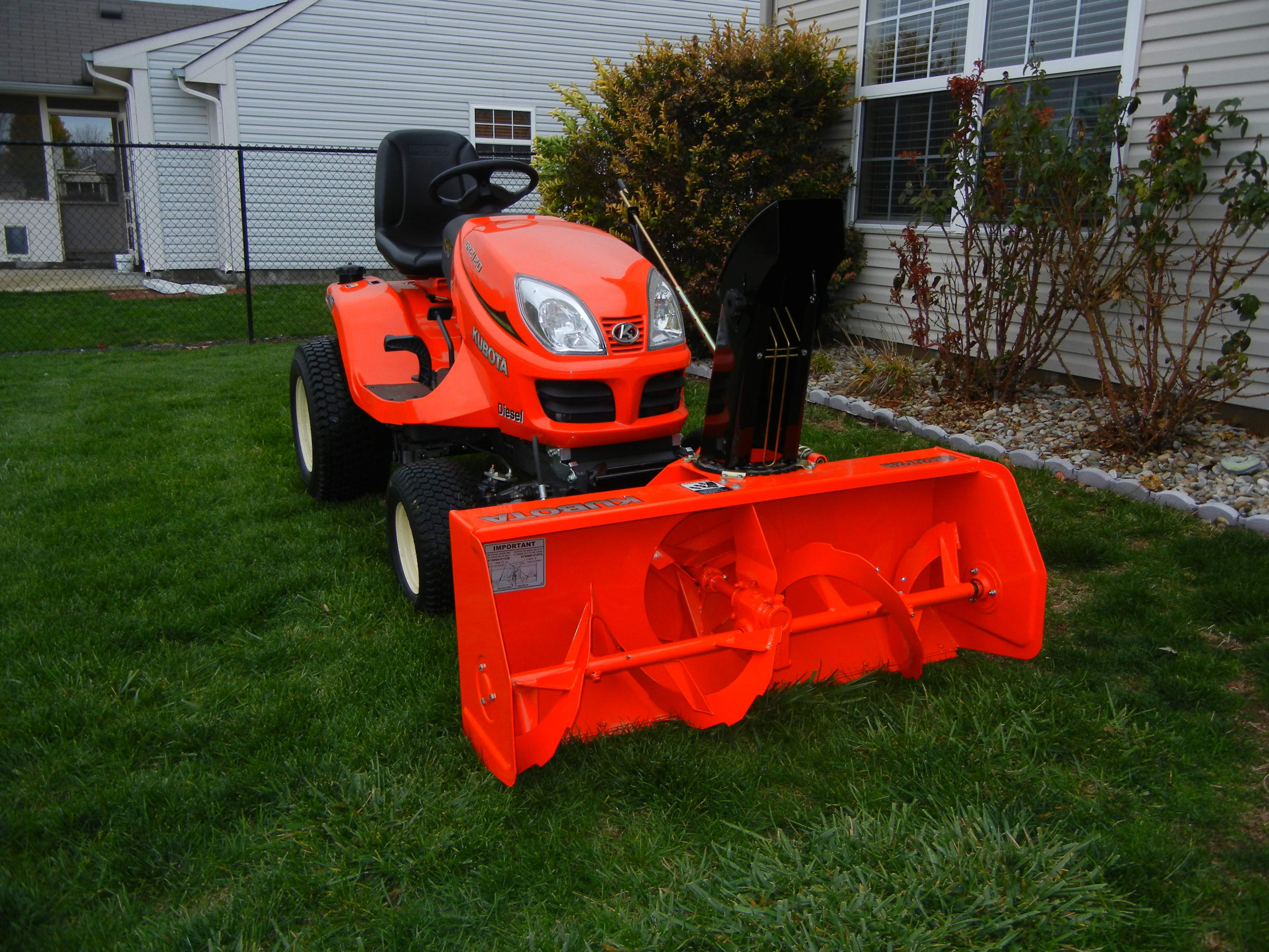

Put the snowblower on for the 1st time over the weekend. Now just waiting on the snow! Philip.

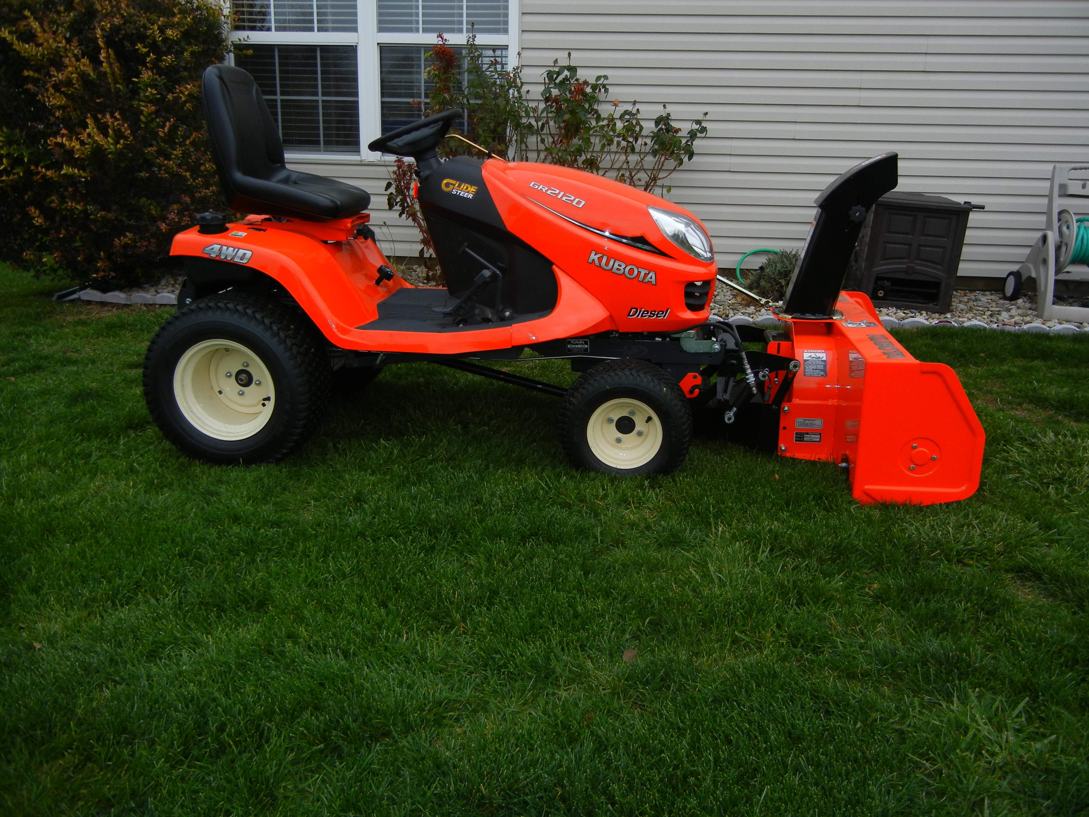

Pete, I ended up throwing that chain, clip, and S hook in trash. When you mount the snowblower, that chain is used to hold the locking handle in place to keep the 'slots' open so the pins from the frame can slide in. I found that too cumbersome to do. I put top lip of frame on tractor, jacked up front of tractor with floor jack, slide bottom part of frame in 'slots', then rotated locking handle in place. Does that make sense? Looking at attached pic, the clip for the chain goes in the hole at the front of the tractor frame. I do not like how the exhaust comes out on the frame, but it is what it is.
My Deere LX188 with snowblower was a 700 pound 2WD tractor with weights and chains, and needed both. This is a 970 pound 4WD tractor and no chains. For this 1st winter, I am going to try without weight and chains, and see what happens.
Philip

I didnt need a floor jack. Got it all installed alright, once i figured out that the bottom part of frame turns, which i thought was welded in place, when i first started installing the blower.
So..you pitched the chain.....think i'll do the same.....cant figure out how that chain is supposed to be installed. I doubt it'll come loose anyway. Never used it when the mower was on.
The exhaust is darn close to the blower frame, you're right. If i hear a rattle, i'll know where to look. Might cut 3/8 off the exhaust if i need to.

Yes, keeps the rotating handle in position so the 'slots' are open during lower pin installation. Did not work very well, looked like crap, and did not want a chain dangling around that I would only use once a year. After thought for sure. Philip.

First, I agree the chain isnt very elegant solution, but it does its job by holding the rotating handle on the quick hitch in the open position when installing the snowblower. It's better than duct tape and it allows the snowblower to be easily installed by one person. Once it has done it job, it just hangs there until next year.
