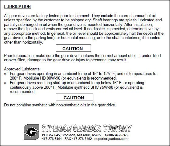

Not sure how the bevel gearbox in your GR2120 compares to this, but here is the manufacturer's lubrication recommendation for a Superior 211ADF 189 bevel gearbox in F3060 front deck mower.
I switched to synthetic 75W-90 GL-5 two years ago on recommendation by fellow member here.

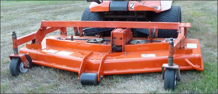

It is a lot easier to remove the deck if you buy a set of four furniture removal dollies with rubber on top. Also, it is fairly easy to check the oil level in the gearbox if you lower the deck all the way down. Then blow off the grass and dirt with compressed air and wipe clean around the check port. Now remove the check plug with a 12mm 3/8 drive socket and ratchet and then poke a piece of wire with a 90deg bend on the end on it to check the oil level is at the bottom of the check hole.
