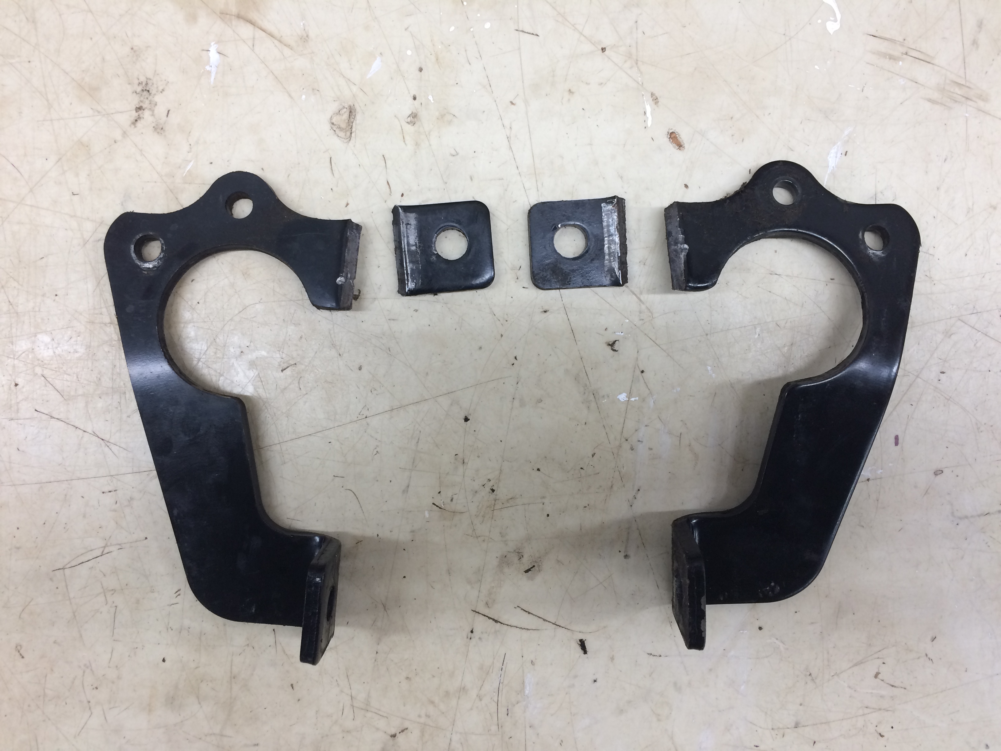

I had the same problem with my GR2120. I figured the failure was caused by the metal being weakened from the bending of the it. I could see a fine line in the metal where it was bent 90 degrees. I weld for a living so I just welded them up and put a little paint on them. I think they are stronger now than originally. I haven’t had a problem with them since.

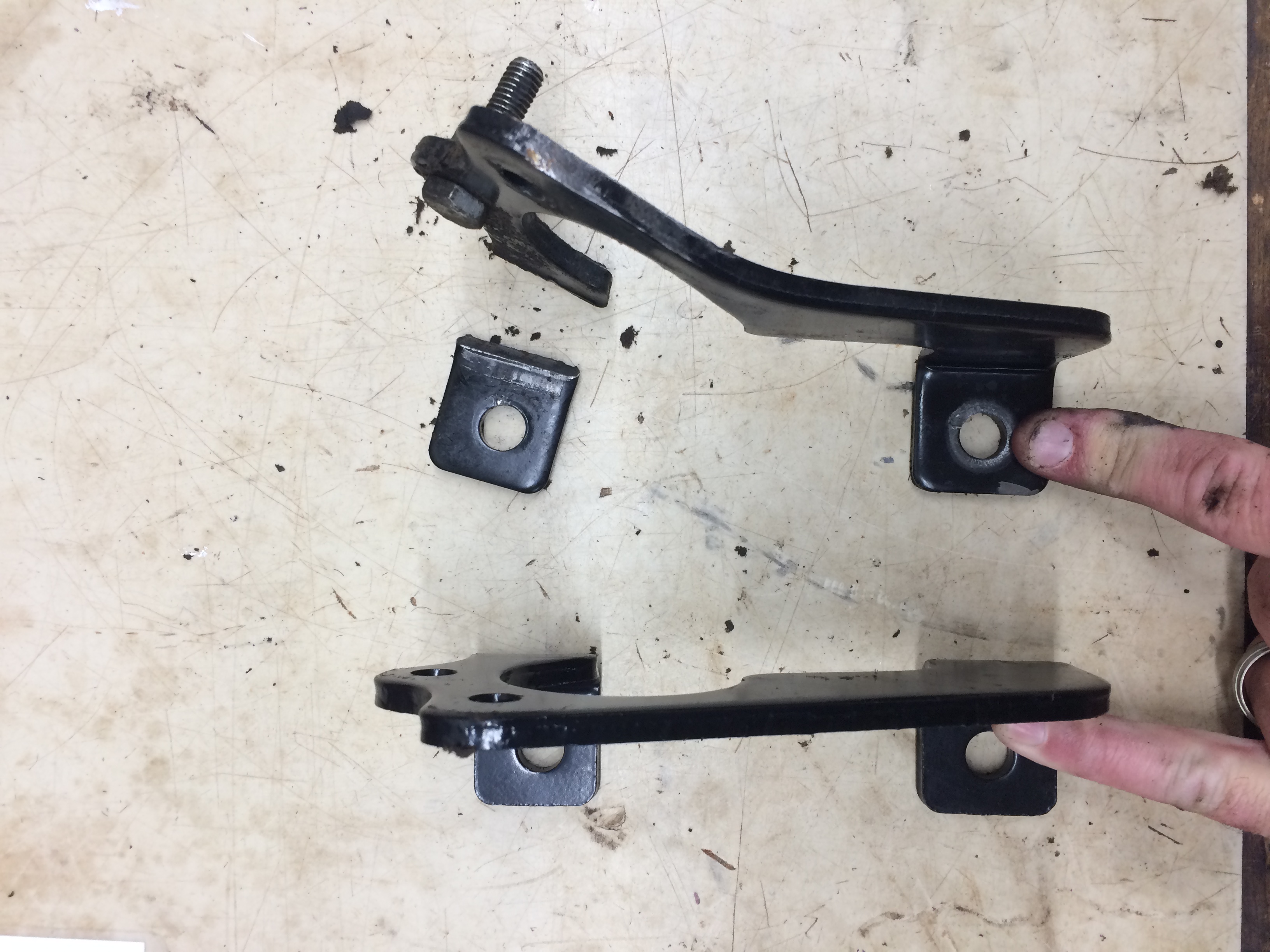

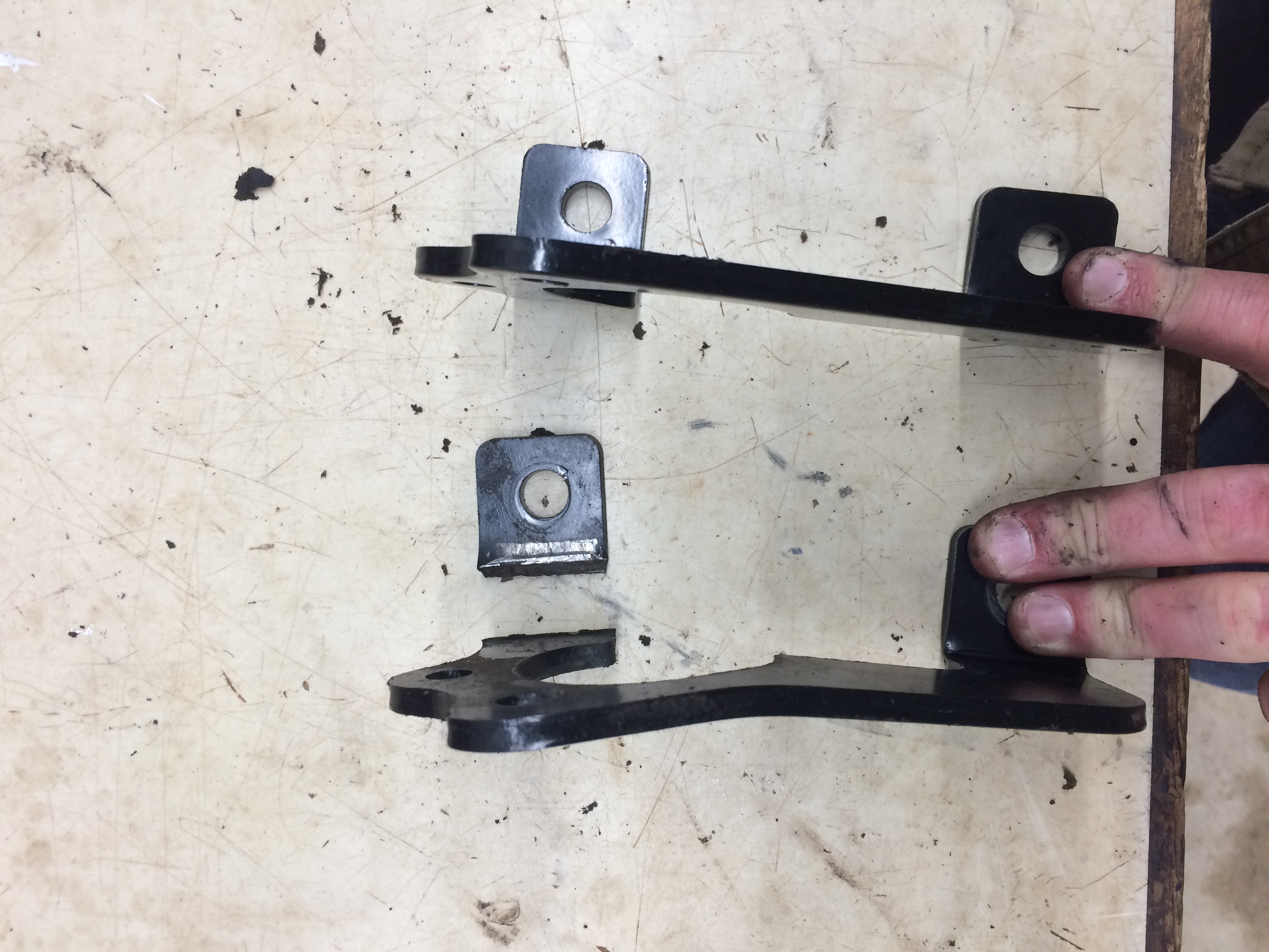

I am replacing both of my brackets this weekend. One of the lower bolts is missing, so I assume it fell out putting extra load and stress on the brackets. 2013 with 200+ hours, but it gets worked around here. Philip.
/ GR2120 Steer Cylinder #8
Replaced both brackets and long tie bolt last night. The passenger side bracket bottom mounting bolt to axle was gone, maybe this initiated failure? Both brackets were bent and broke. The drivers side bracket bottom mounting bolt to axle was not tight, if this happens again I may replace with nylon-lock nuts. I agree with others, this is not a good design to hold a powerful hydraulic cylinder in place, if the front tire hits something hard like a curb, or if the front tire is against something stiff when you try to turn the wheel, one of these brackets must take all that force. Philip.
