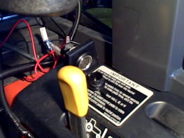

Well - Seeing there is no snow here in Illinois for me to go out and play in with my new Kubota - thought I would post up the install pictures. I purchased the electric rotate and deflect options. I also did not like the cheesy toggle switches and fuses that came with the kit so I did a bit of engineering. Also did not want to drill holes in the dash of my new Kubota - so did a bit of engineering there as well.
Here is an overall picture - you can see where the Powerlet outlets are installed and cabled to the blower:
Here are closeups of the Powerlet outlets and plugs (you need to use a nylon washer behind the outlet if you mount it to a metal grounded surface!!!):
I took the manual rotator support and installed a sealed box on it for the deflect and rotate controls (AEM sealed rocker switches ON-OFF-ON momentary):
I still need to cut and rotate the support a bit so it better faces the operator station.
I installed a 6 pin Molex connector on the underside of the support so I can remove the support and controls for the mowing season:
An then finally the fuse block I installed with a 30A feed to 5A, 15A, 20A fuses for the aux power outlet and the rotate and deflect motors (mounted next to the steering wheel support behind the battery):

Almost forgot - I installed a weathertight 12V power outlet as well in the side of the cup holder. And yes, a can of Miller Lite still fits in there, for post mowing/snow throwing medicinal purposes ONLY. ;)

Those 12-volt outlets are like money in the bank. I paid over 25K for my B3030 and it came without an outlet. So I installed one from Radio Shack--costs $10.00! When Kubota misses the boat, they really miss the boat!
