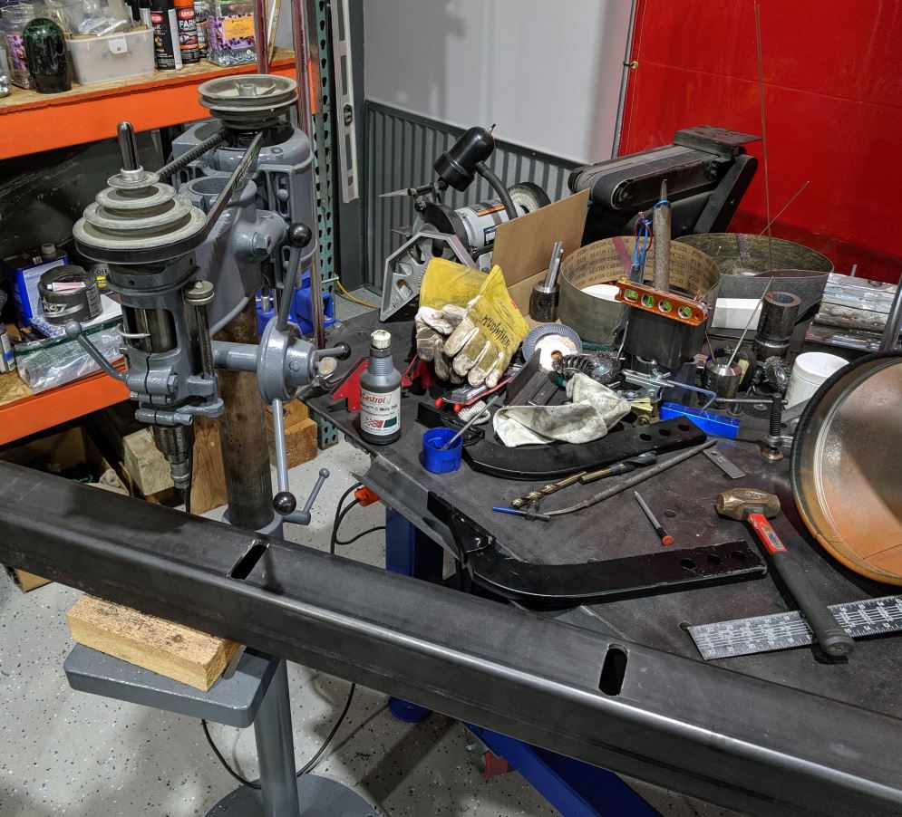

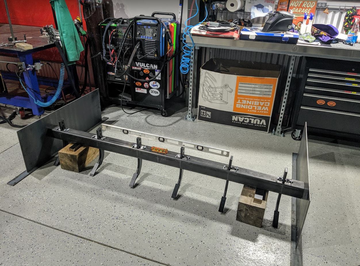

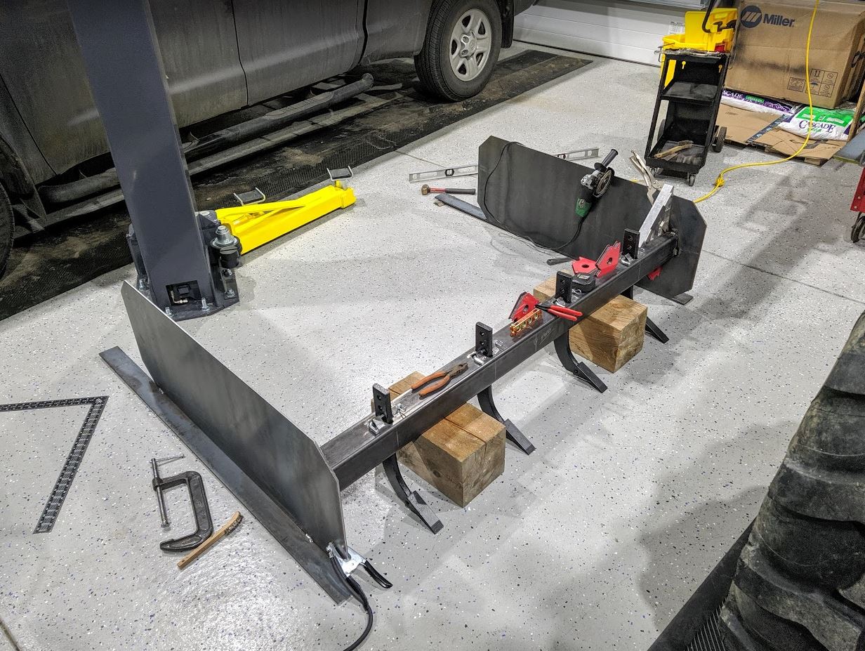

Here's the beginnings of a grader scraper modeled after EA's Land Shark. That thing is so awesome, when I saw the pics and vids I said to myself, "****, I need to build one of those!" - I could buy one, but where I am located in the sticks of Montana freight shipping is a hassle. But the biggest reason for building one is, I love building things, keeps my mind and hands active! Props go out to Everything Attachments for such an awesome design.
I have about an 1/8th of mile of dirt road I need to work, it's all flat and easy to work. Snow and winter get's it puddled up and it needs a re-doin a couple times a year, probably do some of the neighbors driveways too, I know they would appreciate it.

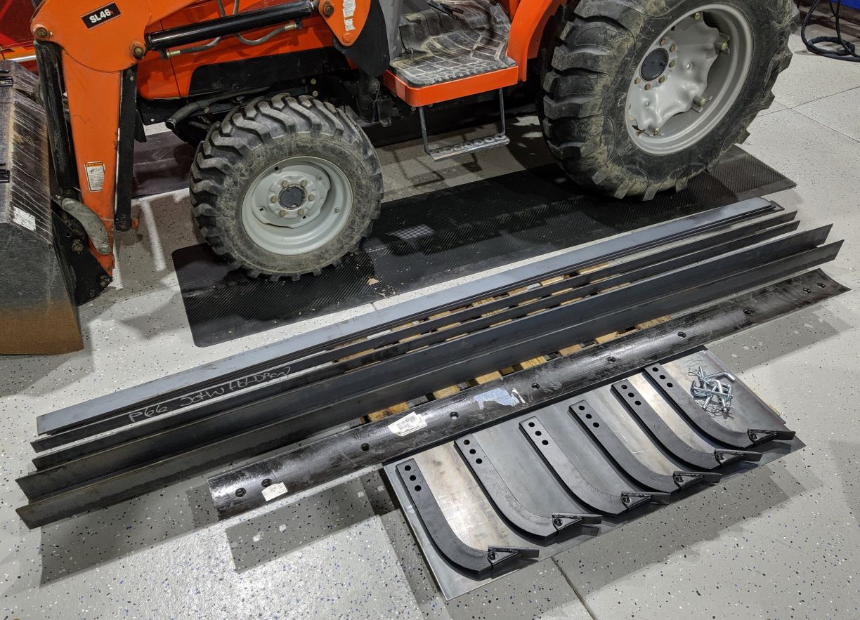

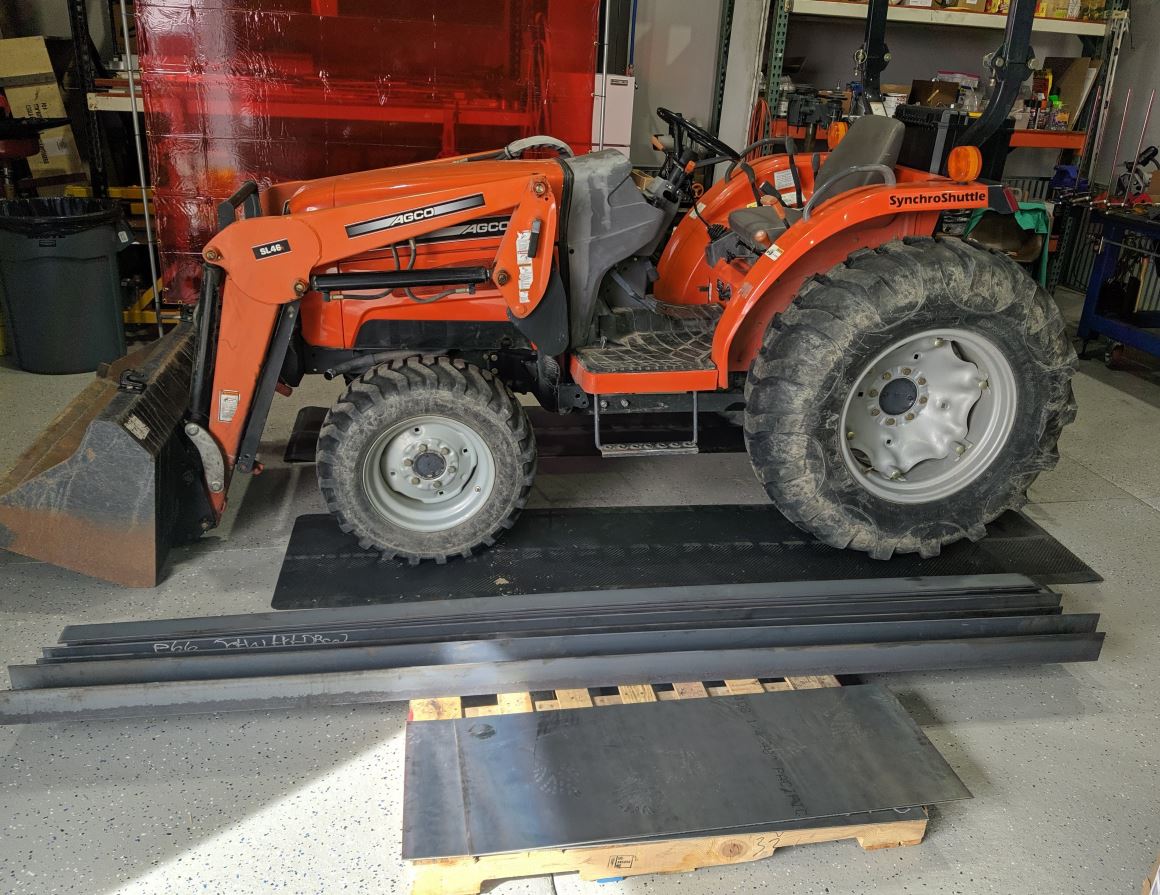

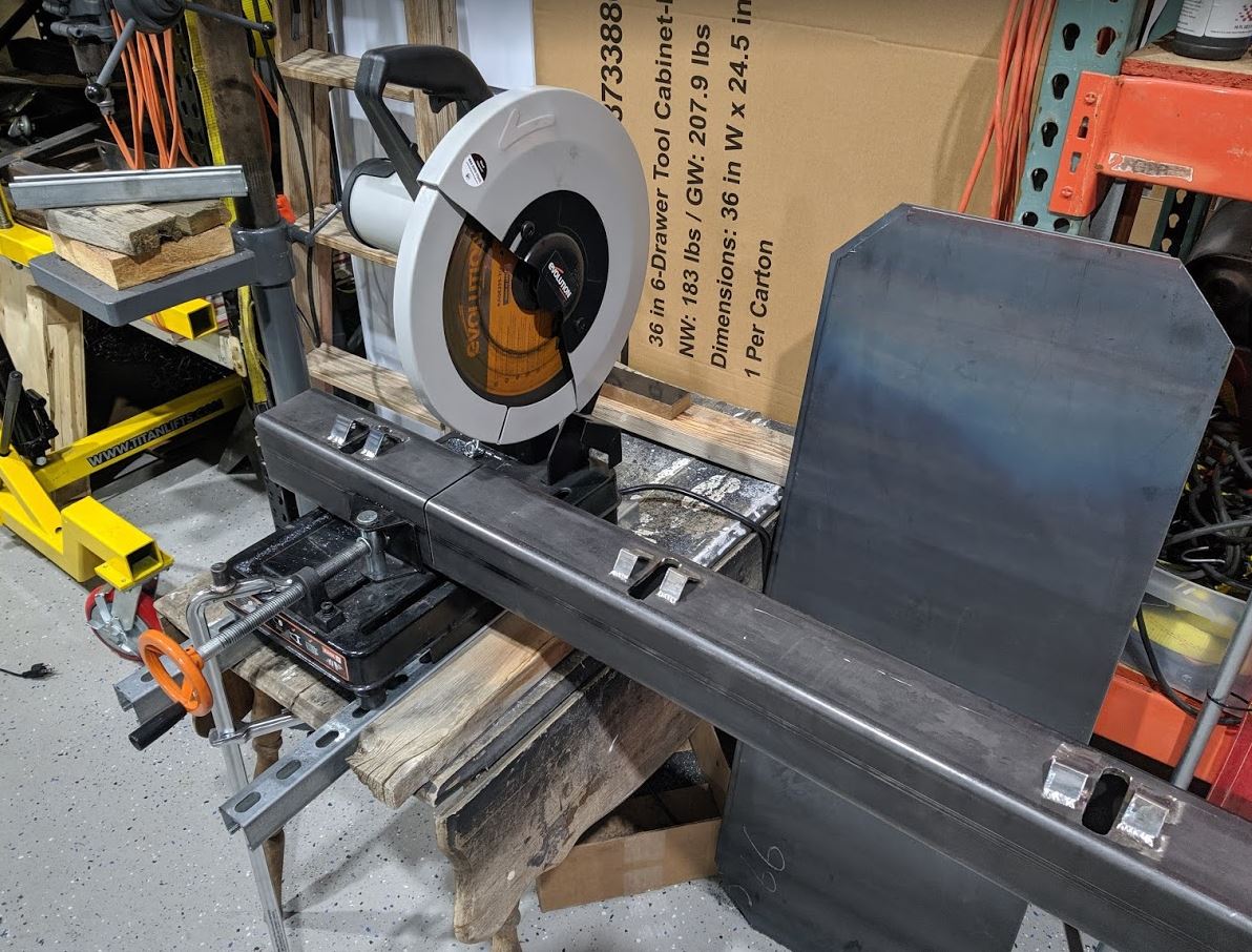

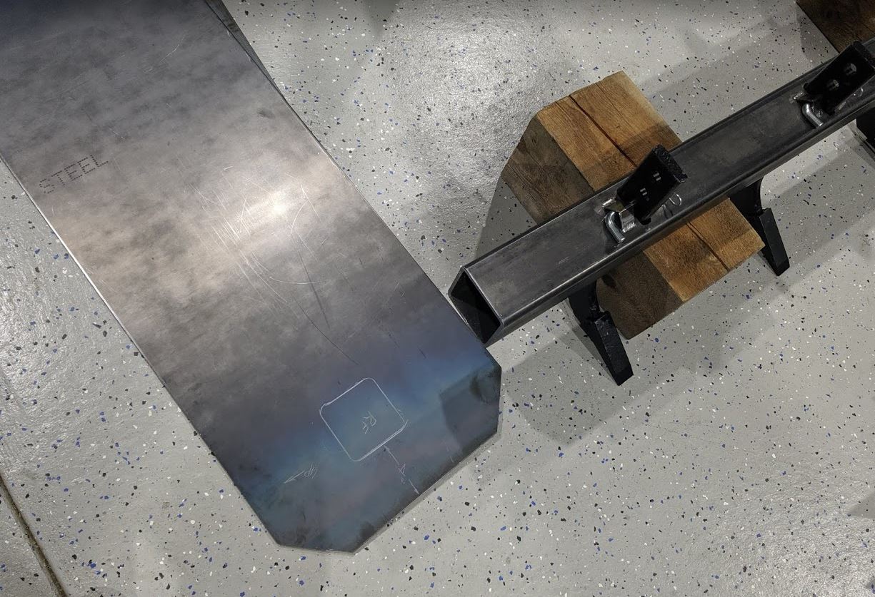

I had the side plates sheared at the steel place, also bought some angle and strap.

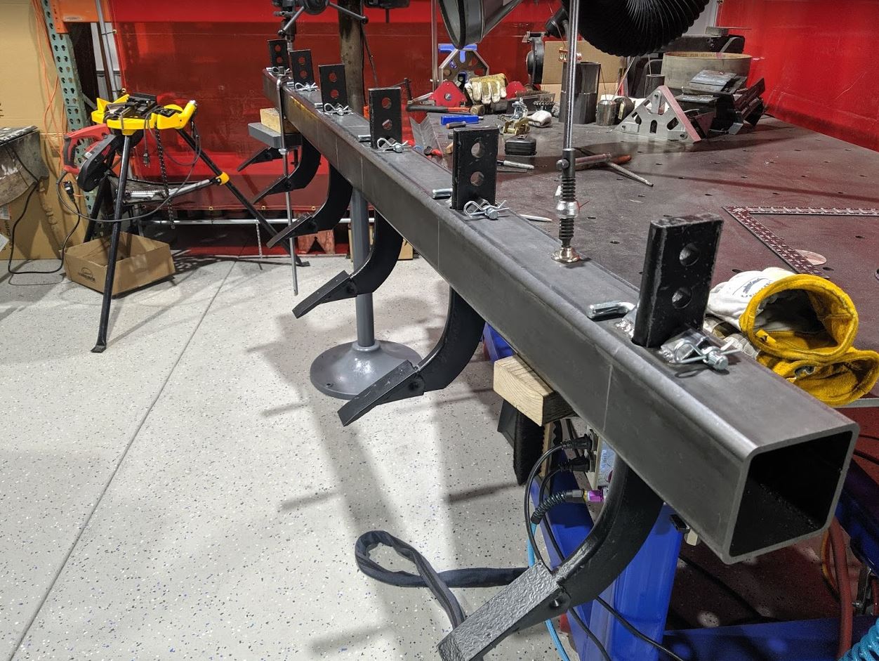

I bought an 8' cutting edge (plan is only one cutting edge - maybe add a second later) and some scarifiers with pins.

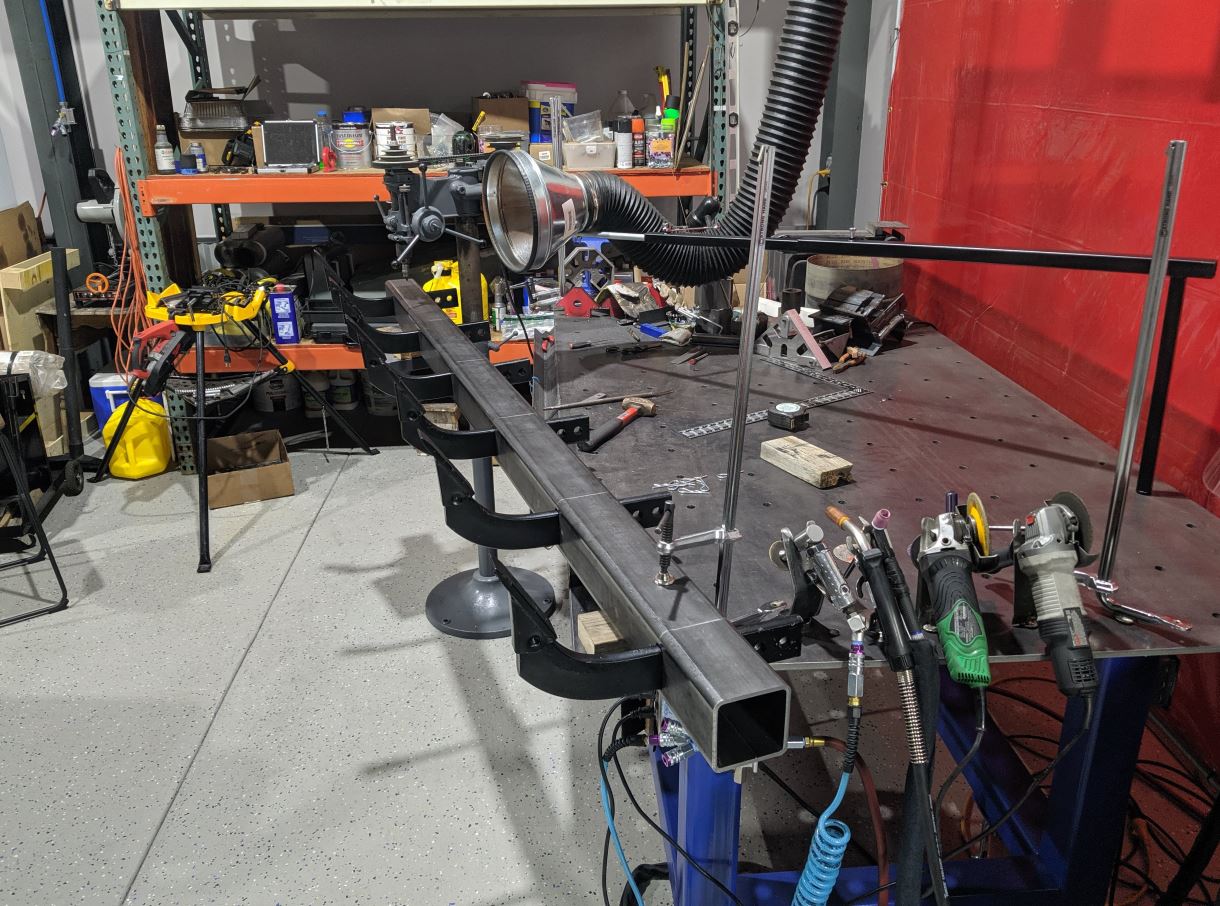

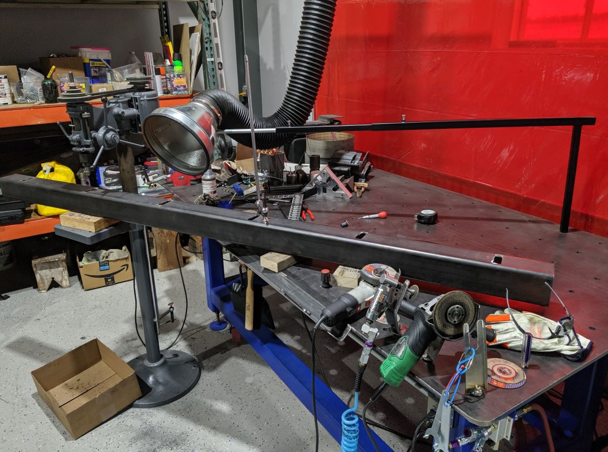

I had some left over 4" heavy duty box tube (this stuff is expensive) from a welding table I built last year.

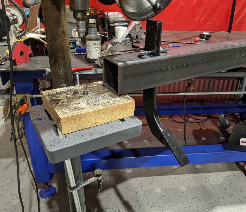

Walleren' the holes out is a chore, not too bad though. After the 12th one I got darn good at it, lol.

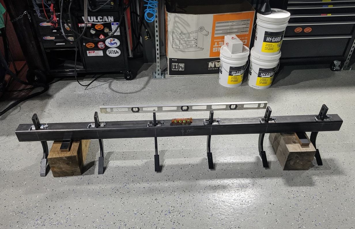

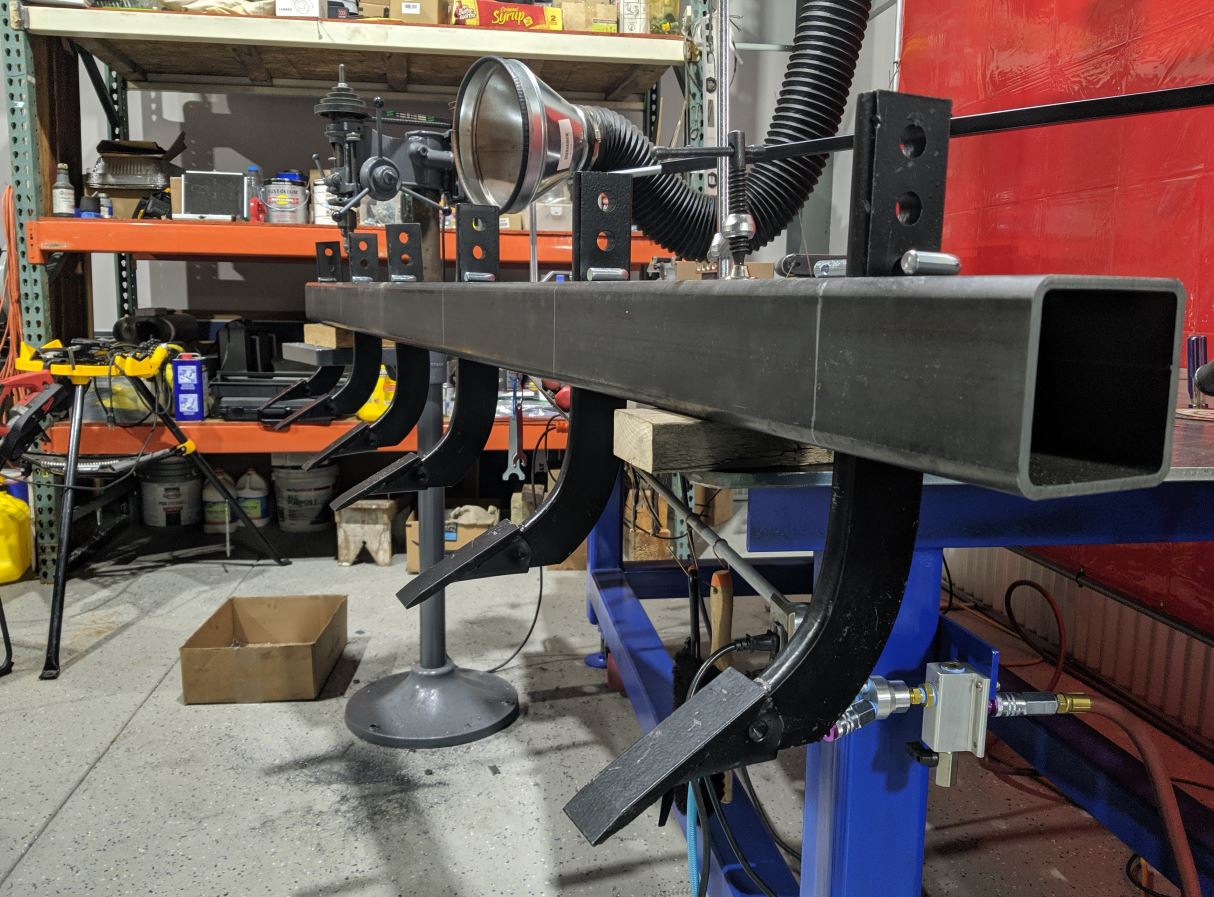

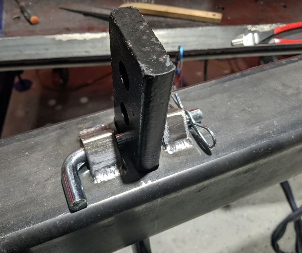

Tweaked the holes with some weld metal to make the tines even. Only one was off about a quarter inch.
Added pin clips

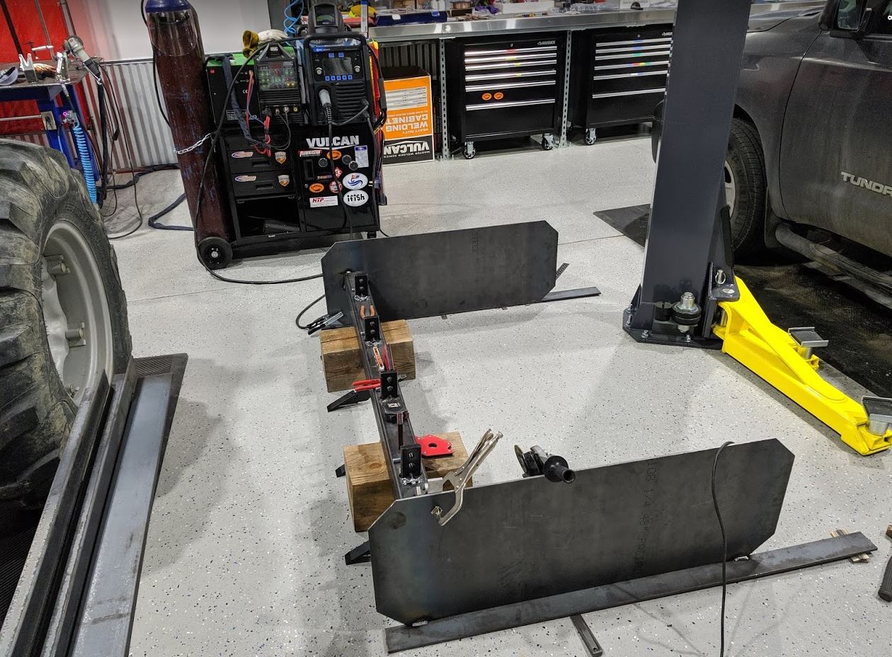

Setting on the ground it came to me, Dang, I'm going to need a bigger tractor! LOL - Oh well, go big or go home!

This is my DIY landplane,, and the tractor that pulls it,, it uses 7 foot cutting edges,,
I did hook it to my JD 4105 (41HP),, the 7 foot landplane was WAY too big for it,,,
   / Grader/Scraper Build #4
Gonna need a bigger tractor for eight ft. Built my land plane with two blades at six ft, My Massey 1742 will stop fwd motion if I let it fill up. I have a hydraulic gate on the back to limit material flowing out. Was playing out in a pasture building a dirt bike track in the summer.

Keep posting your progress / pictures. I am currently gathering the metal to build one also. I was not planning on the cutting teeth though. I just picked up two 8 ft cutting edges. I am only planning on making it 6 ft wide

Hmmm... maybe I will cut the ends off and make it 6 foot wide? My gut feel is that will be a better way to go with my Agco ST34. My road is flat with no grade.

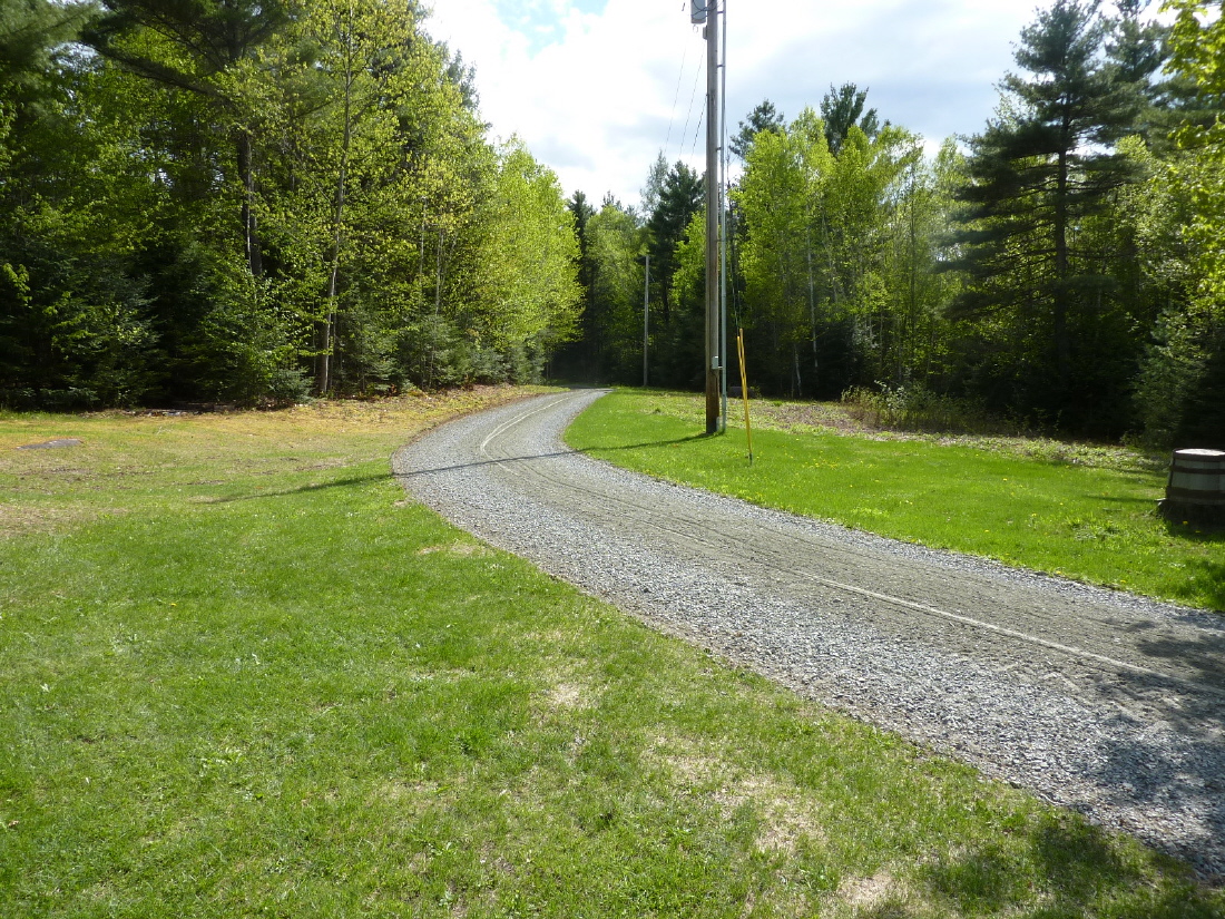

When I built mine, I purchased a couple of nos blades. One serrated and the other straight. Bad idea. The serrated one will pick up a rock and totally screw with the finish on the drive, leaving a gouge till I remove the culprit with a hammer. Have to keep an eye on it constantly. Back up cam would come in so handy.

Very nice work !! Keep the pics coming. Just for reference mine has two blades and weighs about 650 lbs. It is 5' wide and I pull it with a 30 hp 4WD L3010. When it is running near full it is all my tractor wants. With a single blade I could go wider. You will like the job it does .....
