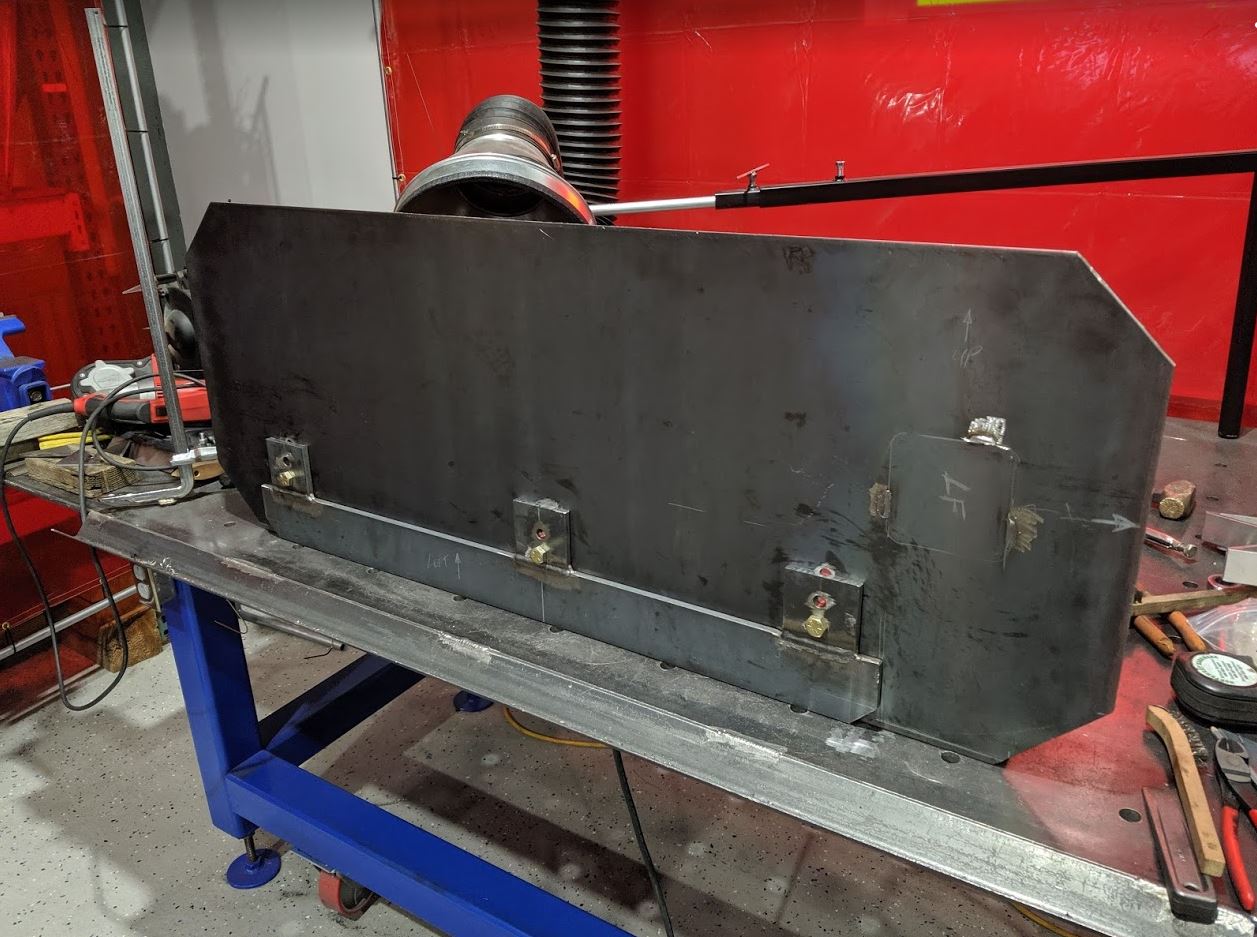

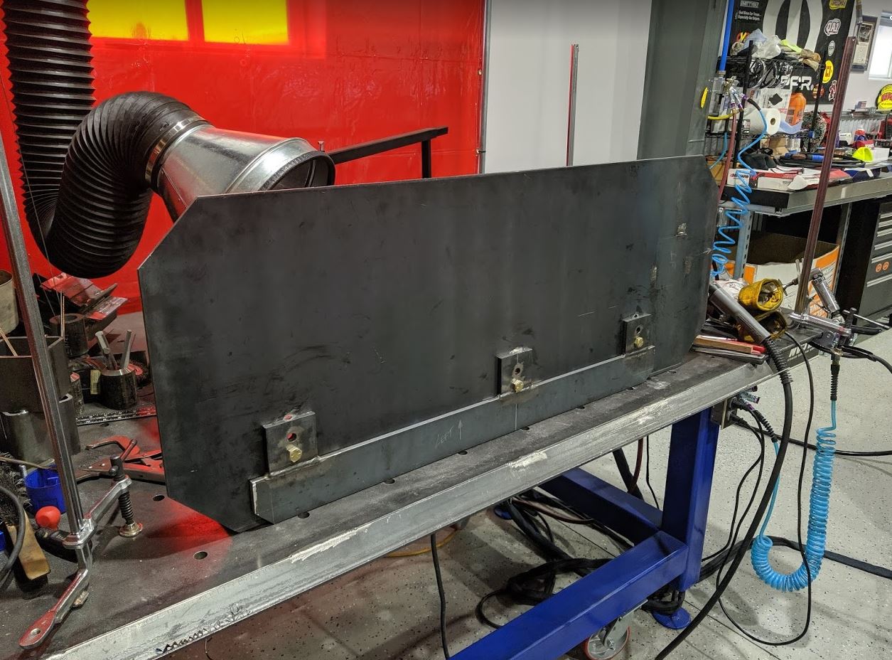

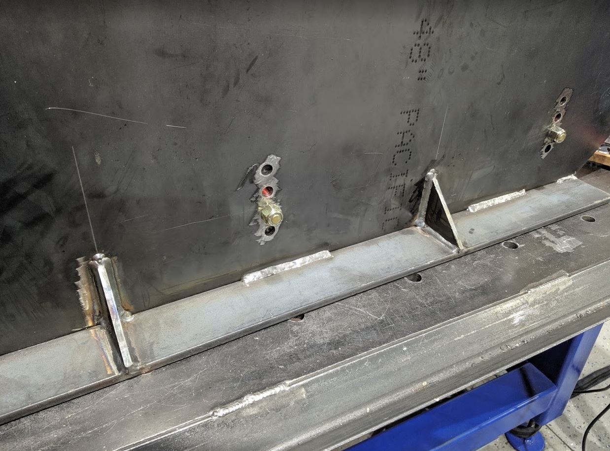

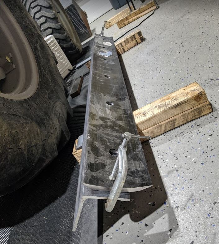

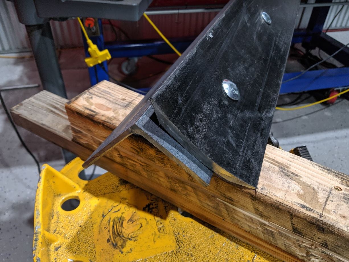

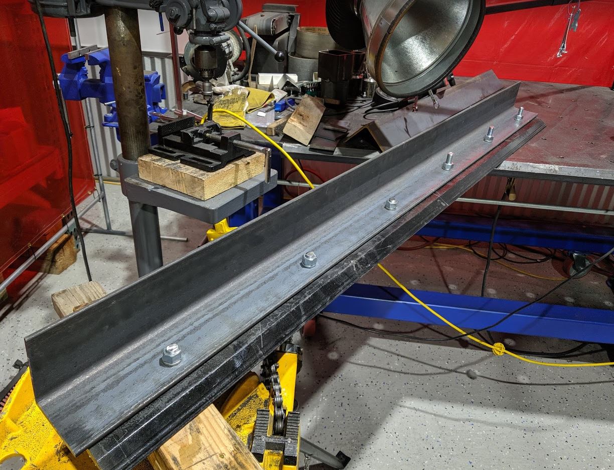

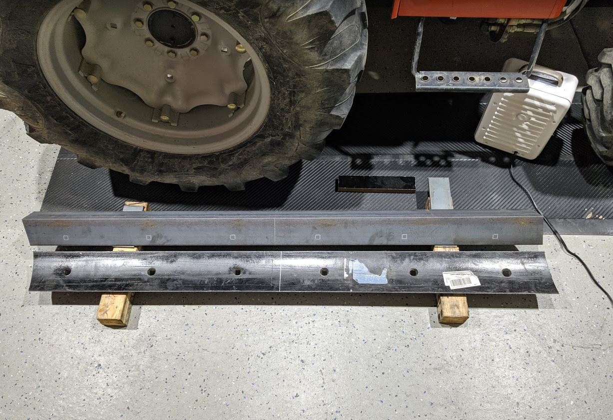

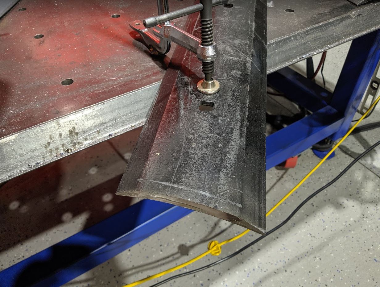

Decided to angle the front cutter blade and leave the rear (steel angle only) straight.
First thing is to cut the blade down to fit, used a thin disk on a 4 1/2" grinder, cuts right through pretty easy.

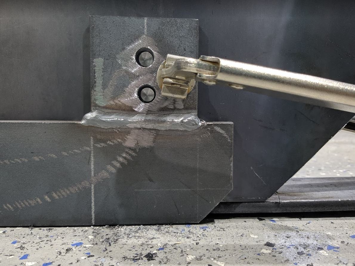

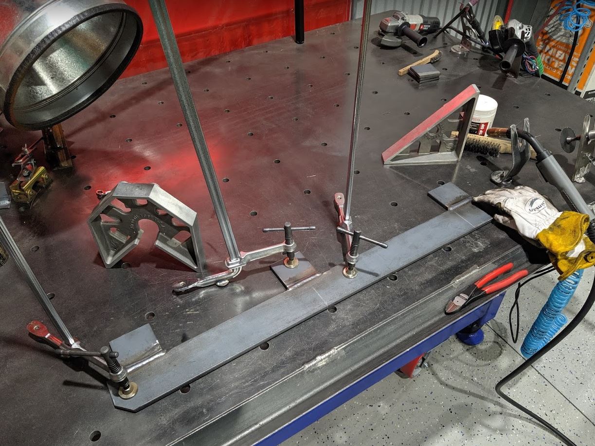

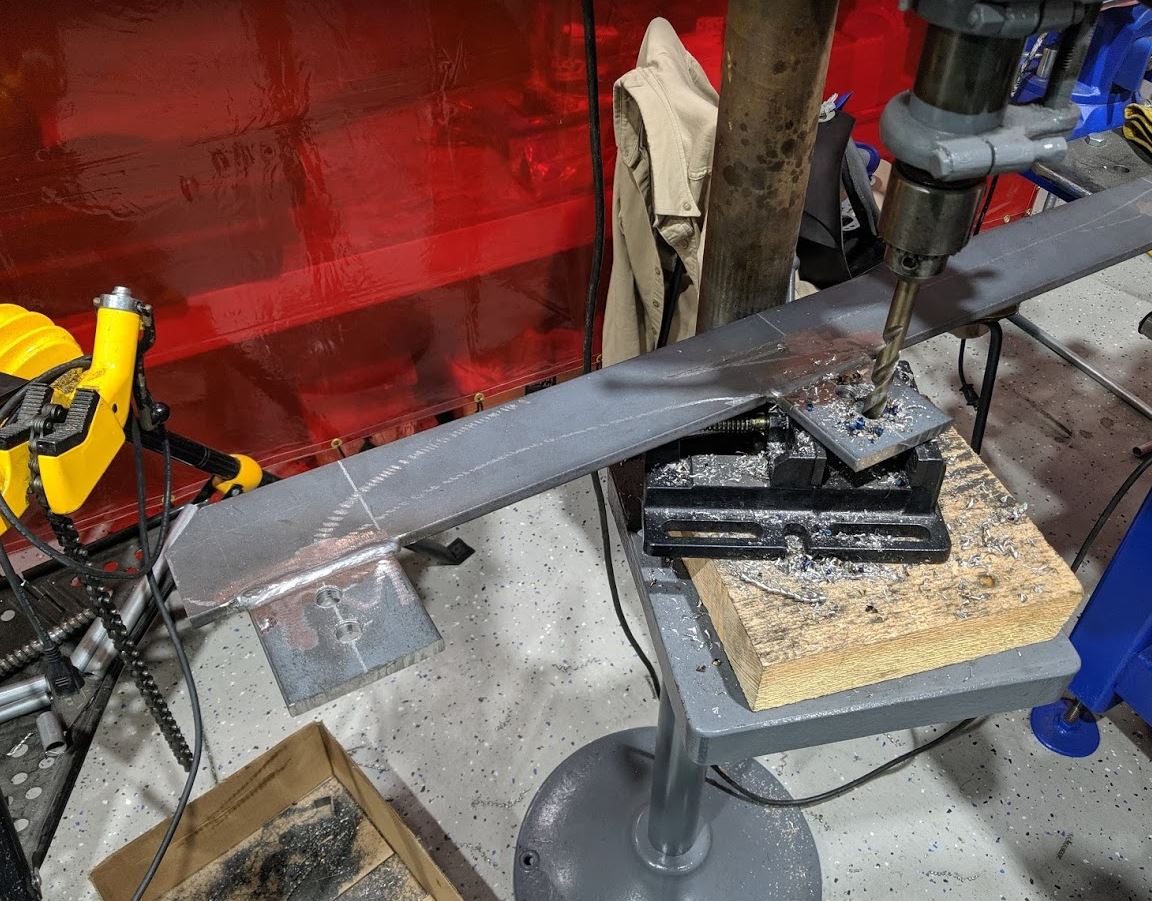

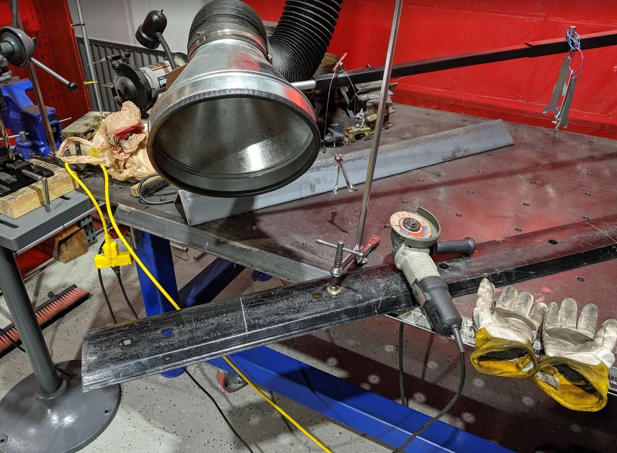

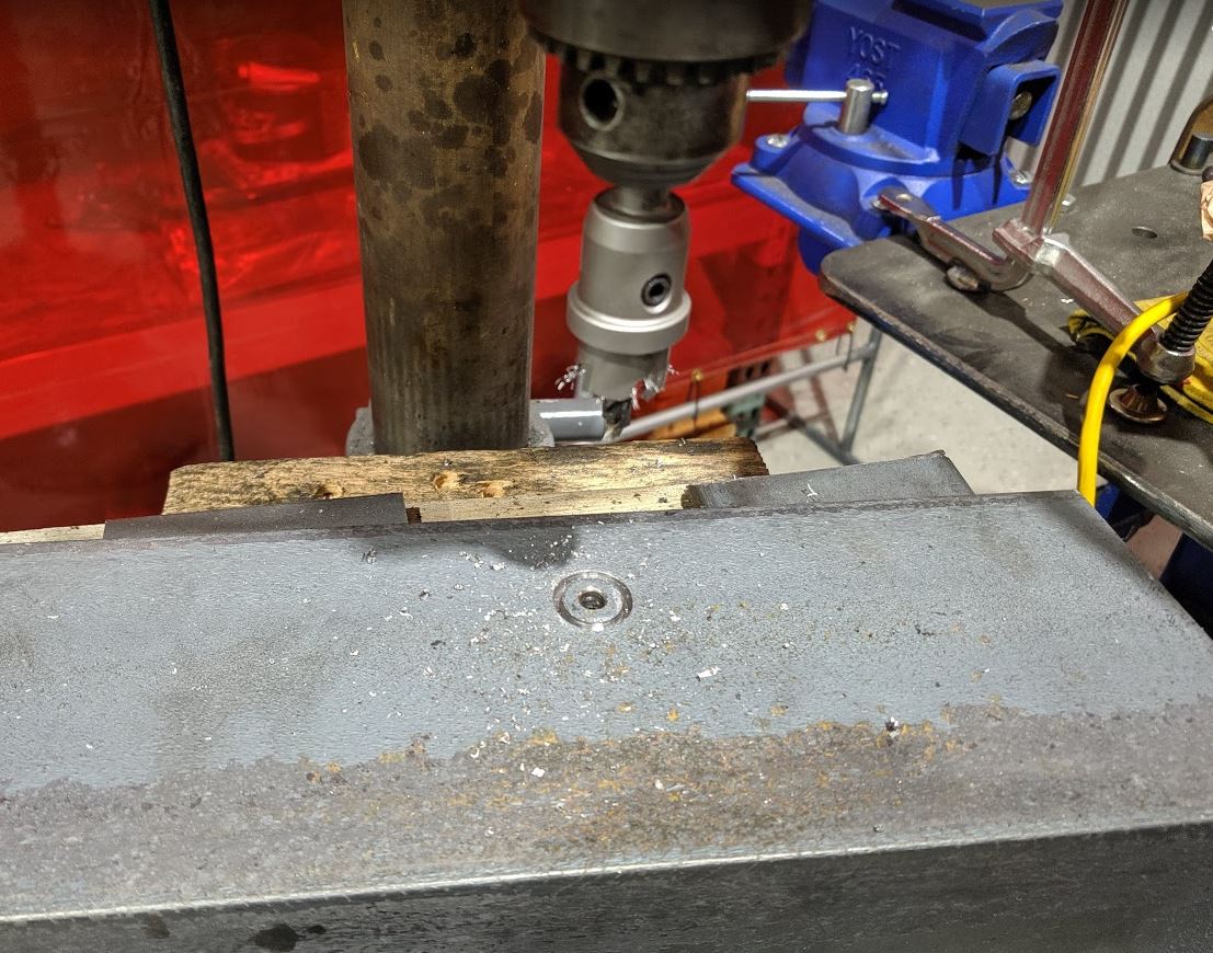

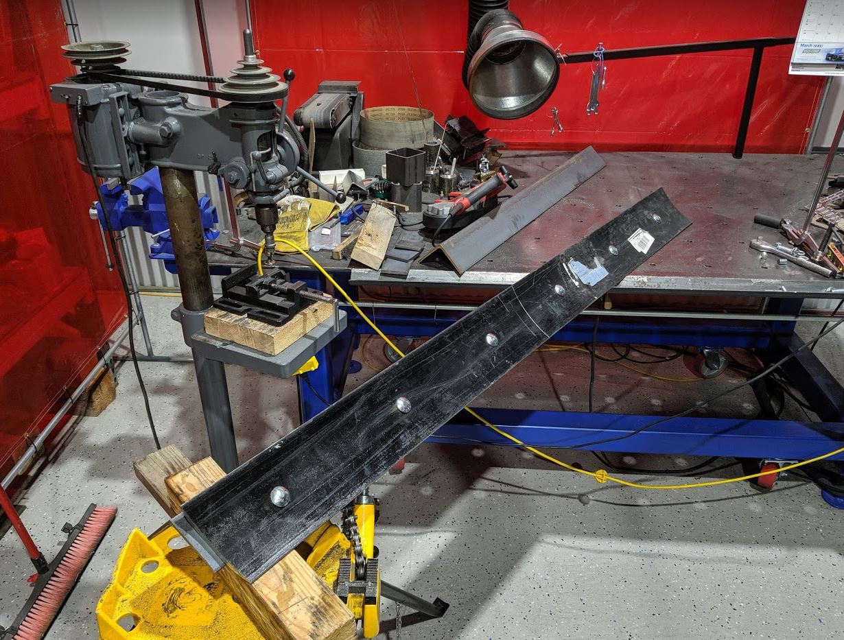

Next thing is to drill to mount the cutting blade, mocked it up with some C clamps and marked it.

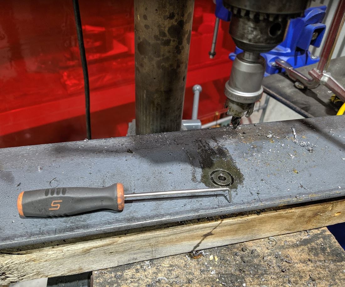

These little broach style carbide cutters work great, the only thing is you need to take your time, and stop and clean them out when they get full of cuttings.
I use a small 90 degree pick to clean the bit and the cut groove, you can tel when it needs cleaned because there is hardly any cutting happening when you are applying quite a bit of force on the drill press handle.

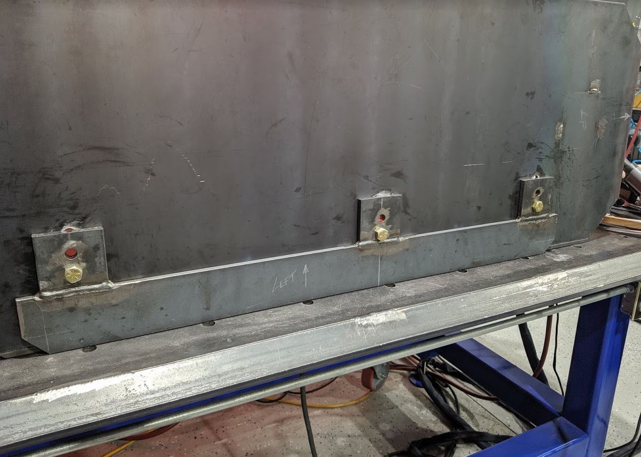

Got the blade mounted.
Had to cut the ends of the bolts off or they would of dragged under the cutter. No problem, easy fix.

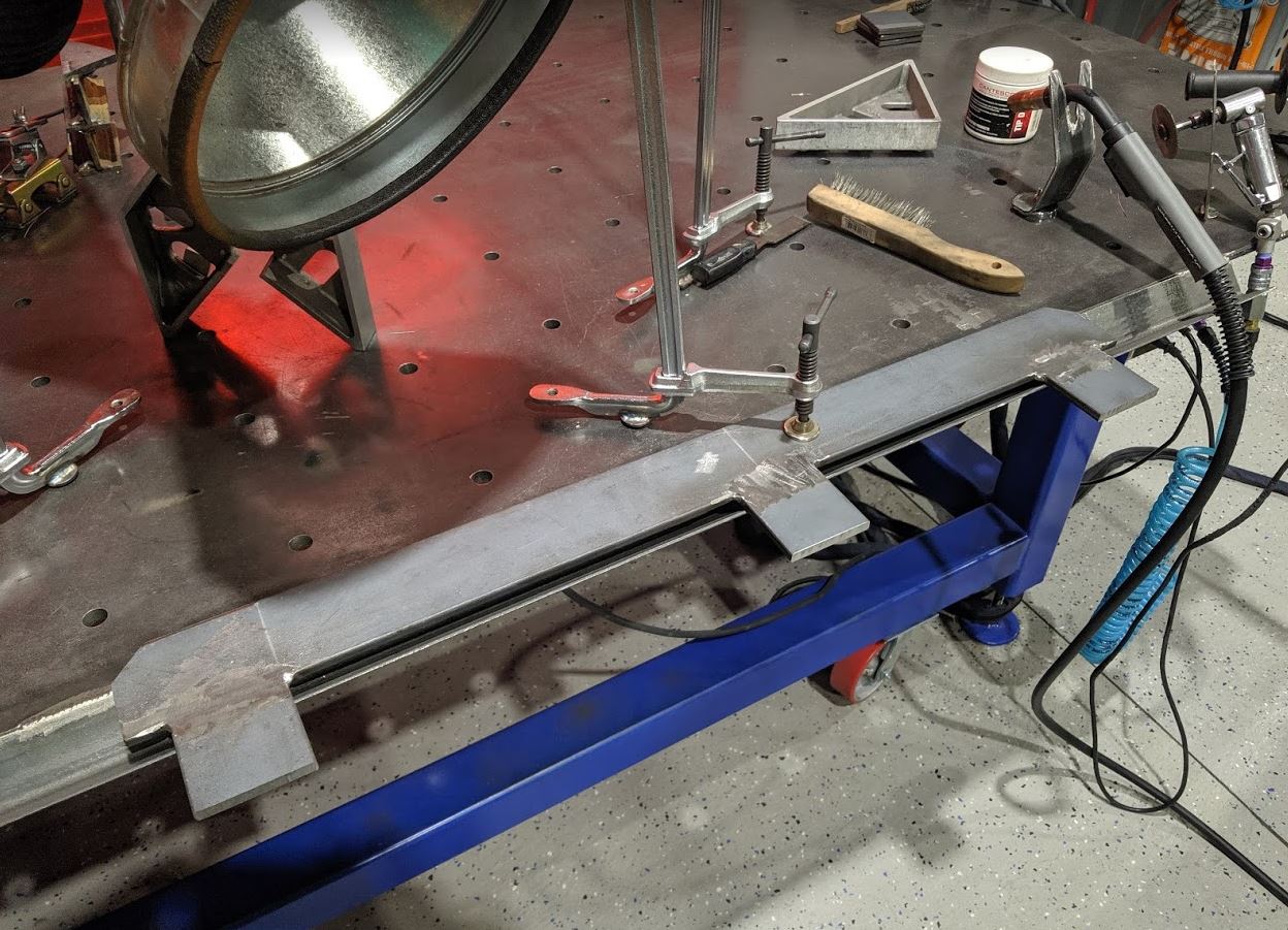

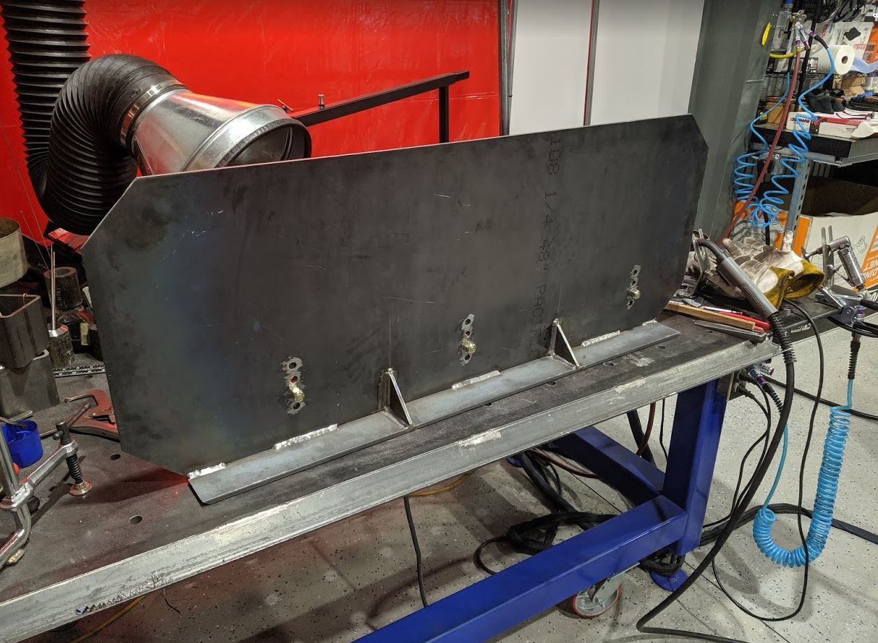

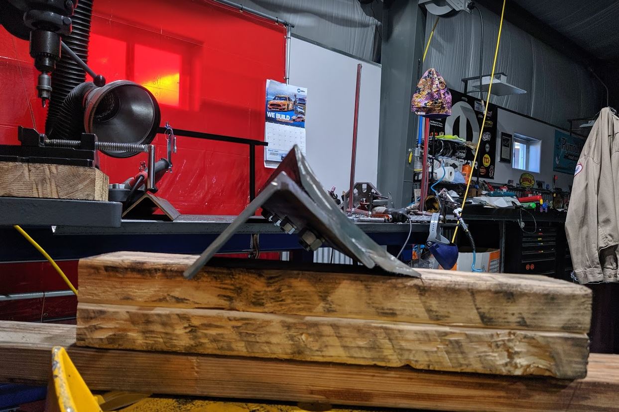

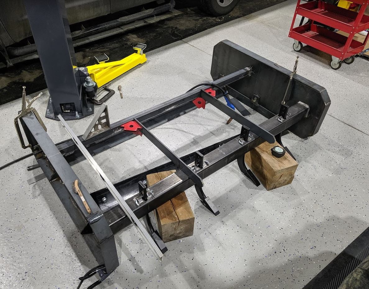

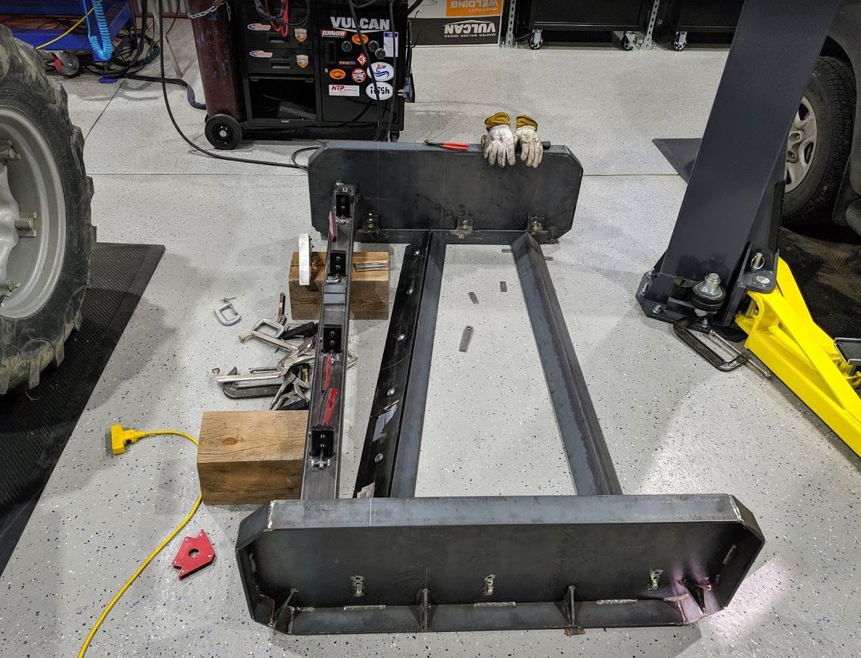

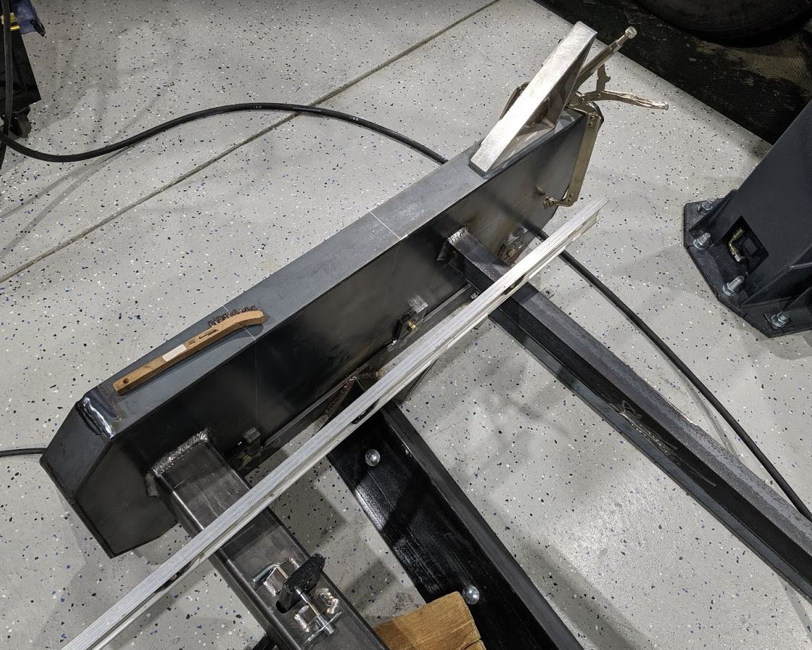

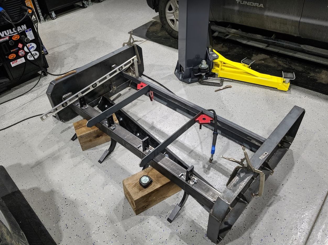

Here's what it looks like so far (not welded in yet)
I'll be able to add a rear cutter blade later easy.
I can also cut the angle out and change it also if need be.
Getting everything set just right before I put the welding to it. :thumbsup:

Looks like the same model Delta as mine. I made an idler pulley to slow it down for drilling in metal:
/ Grader/Scraper Build
#48
That looks just like it, great idea with the idler. I just might have to rig mine up the same. Thanks for the idea!

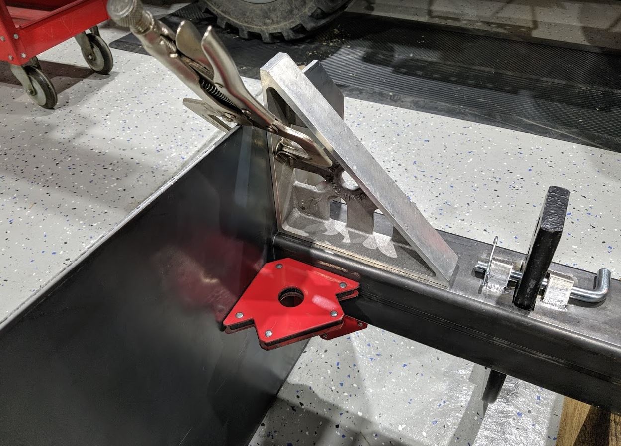

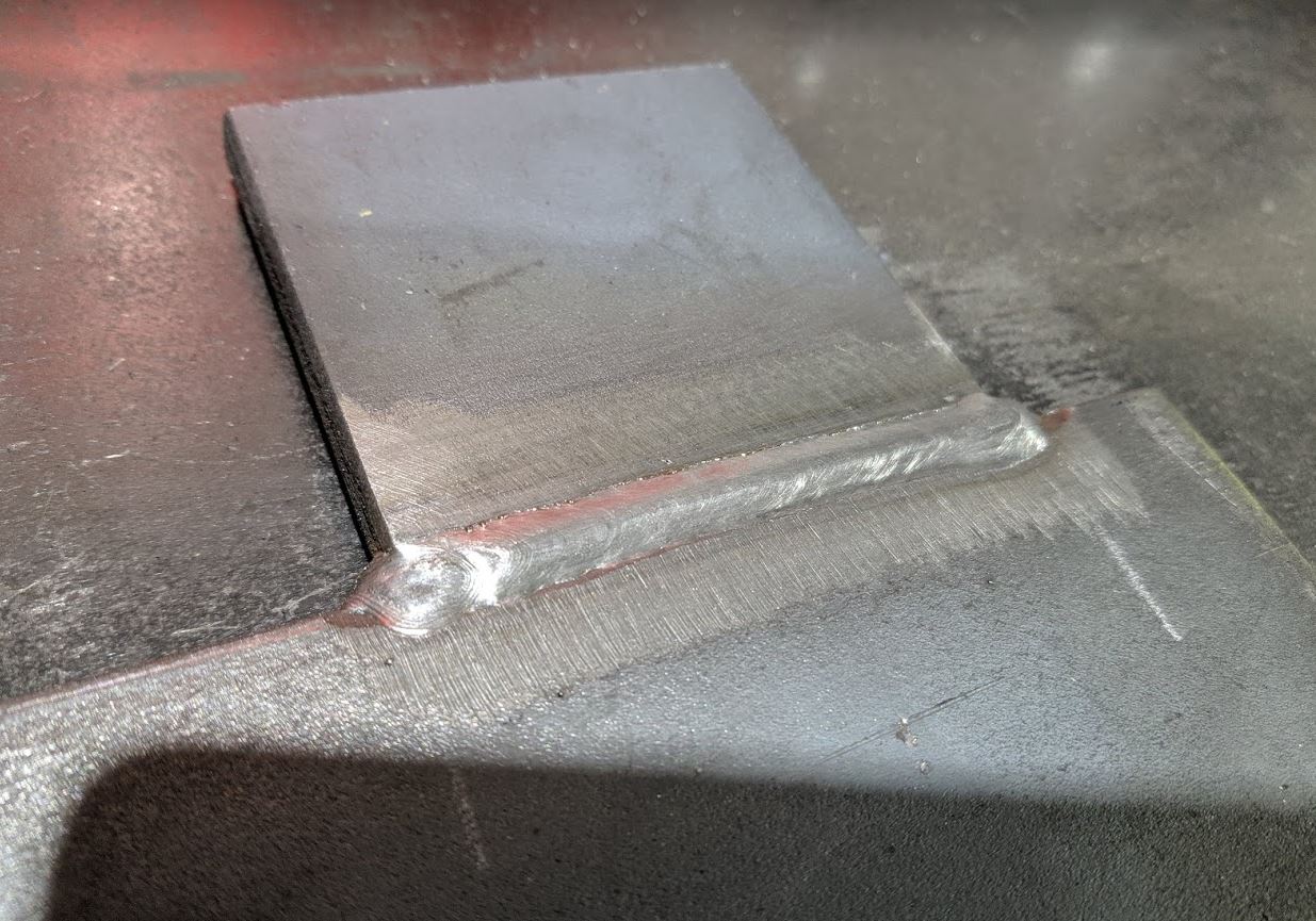

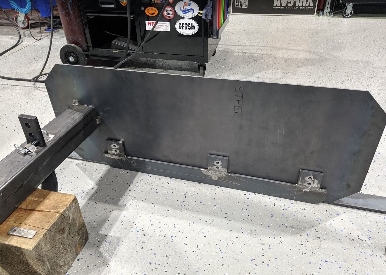

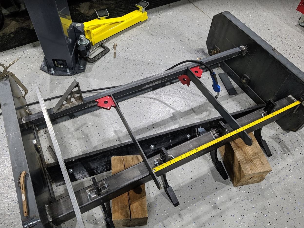

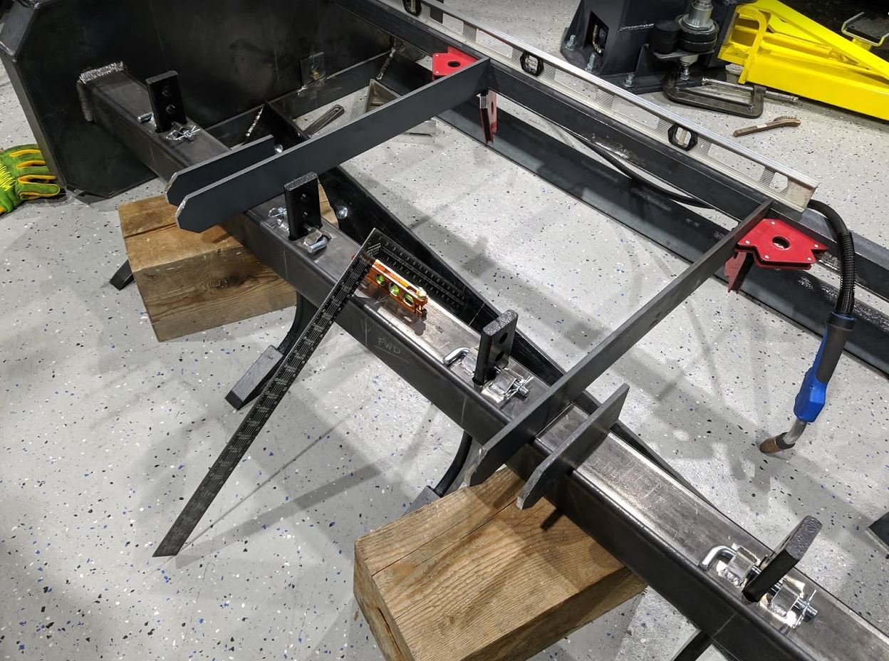

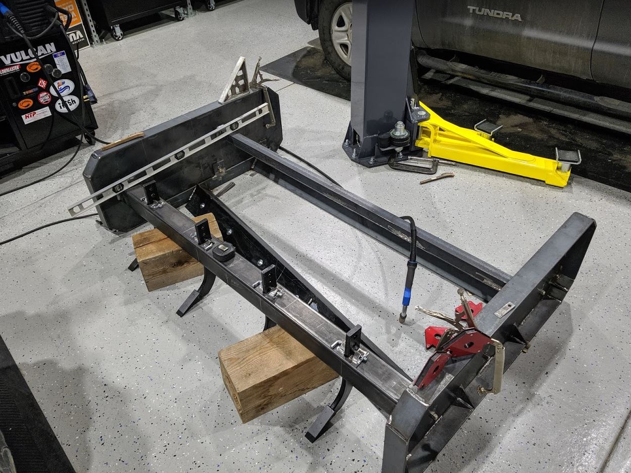

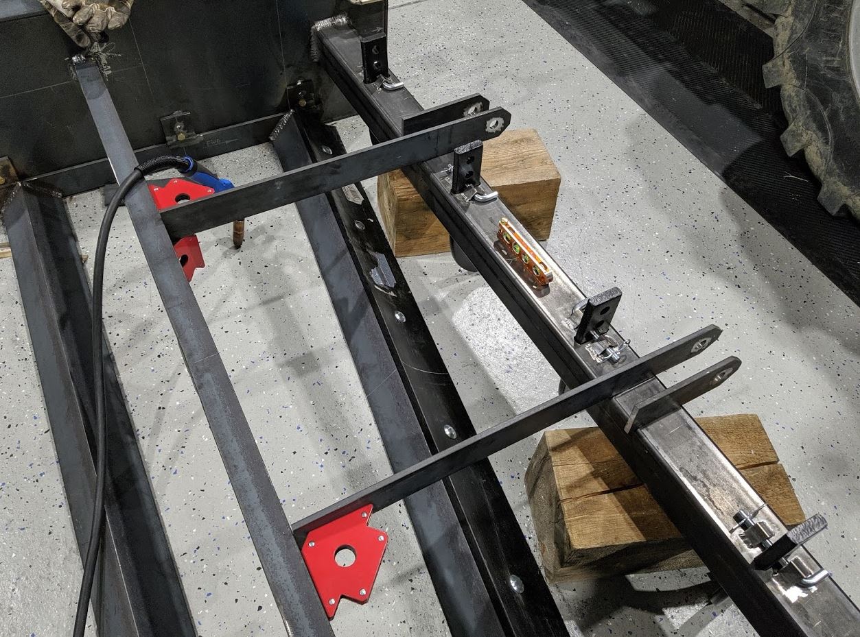

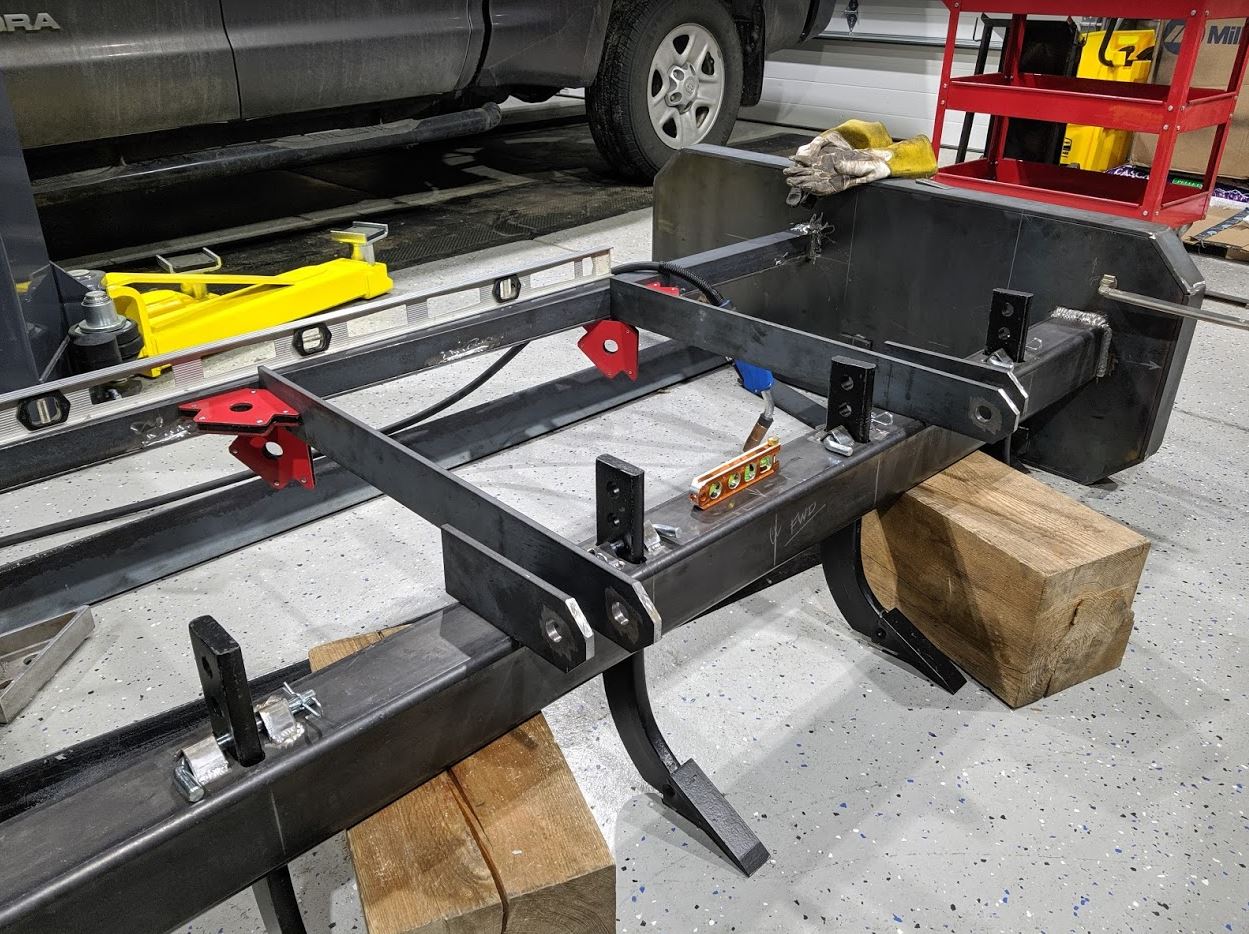

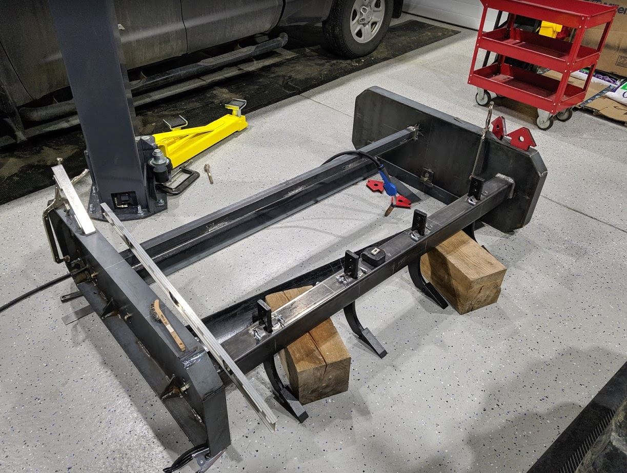

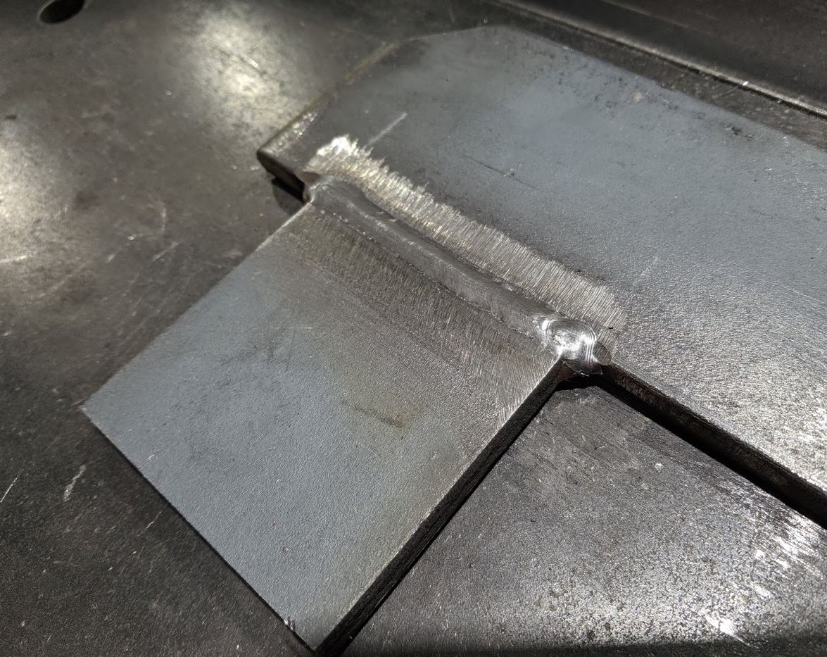

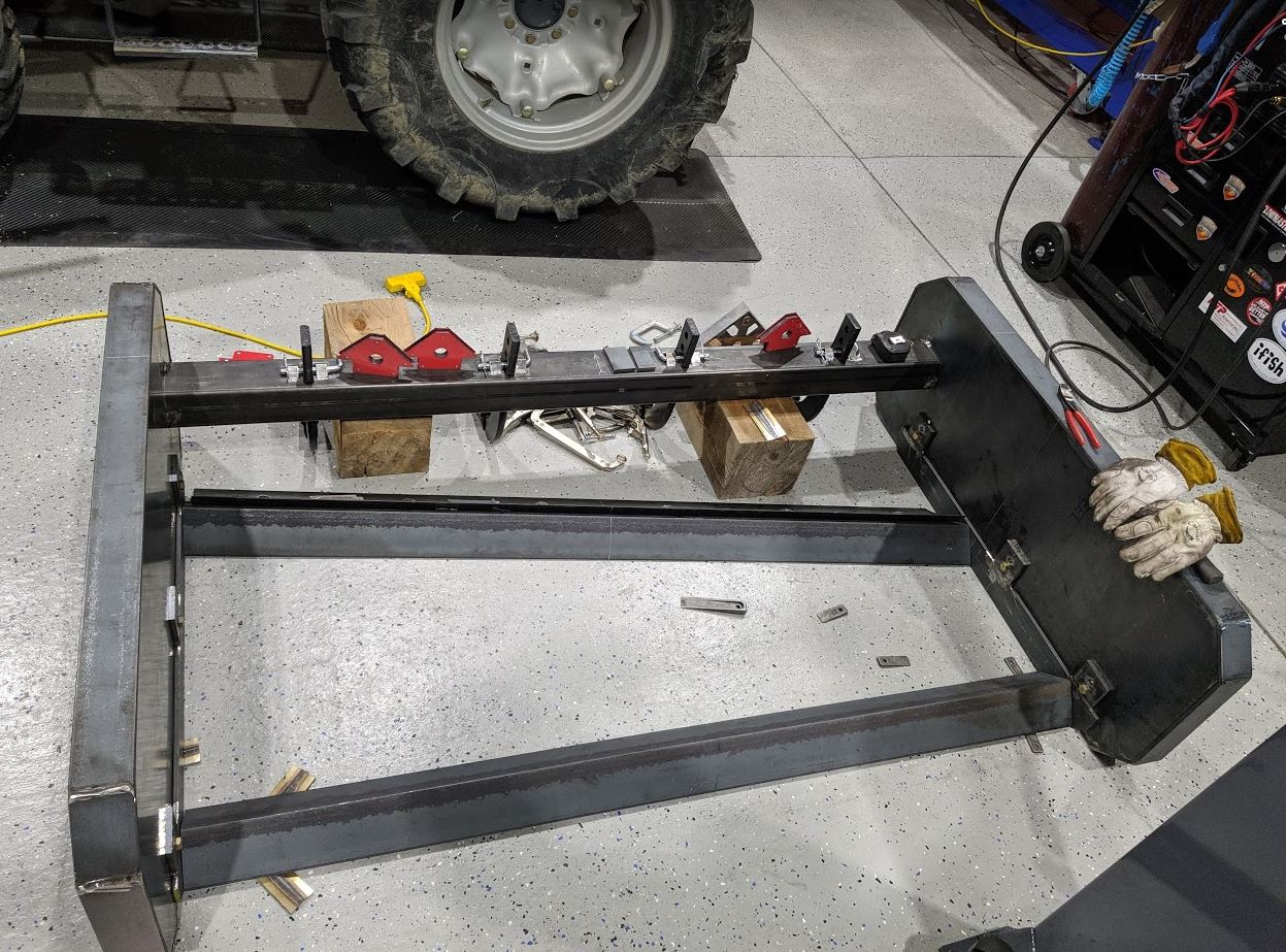

Added a rear cross brace and welded everything in place

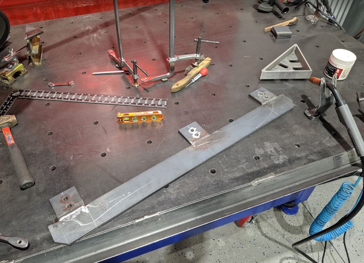

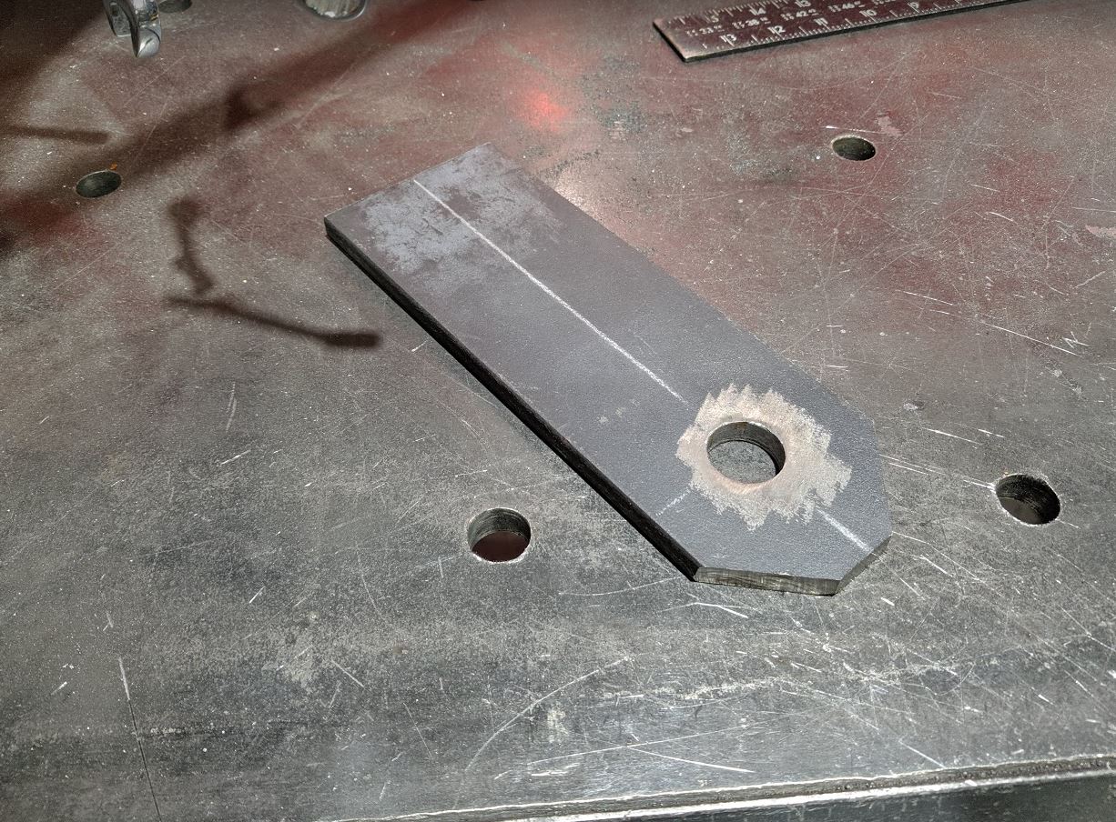

Cut, beveled, and mocked up the lower link points
Spaced them 26" apart for the inside dimension

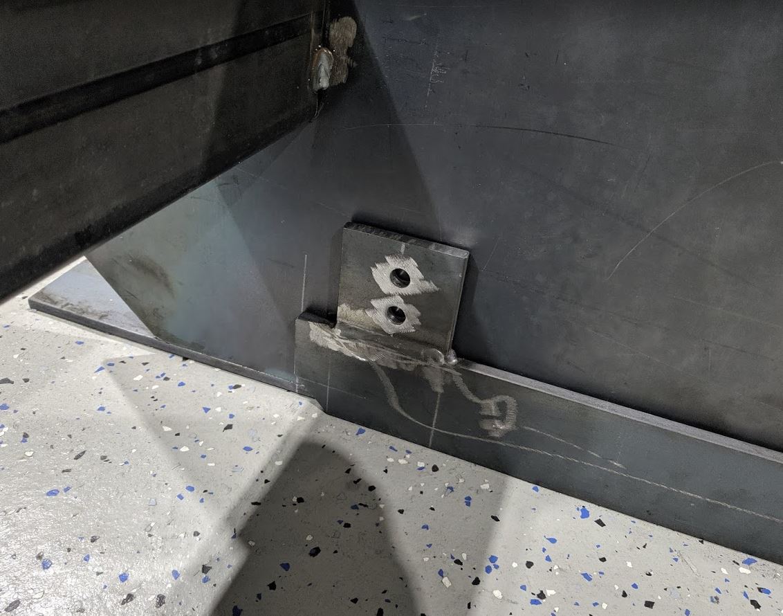

#50
Drilled lower link points and mocked up position - 2" between 7/8" pin holes :thumbsup:

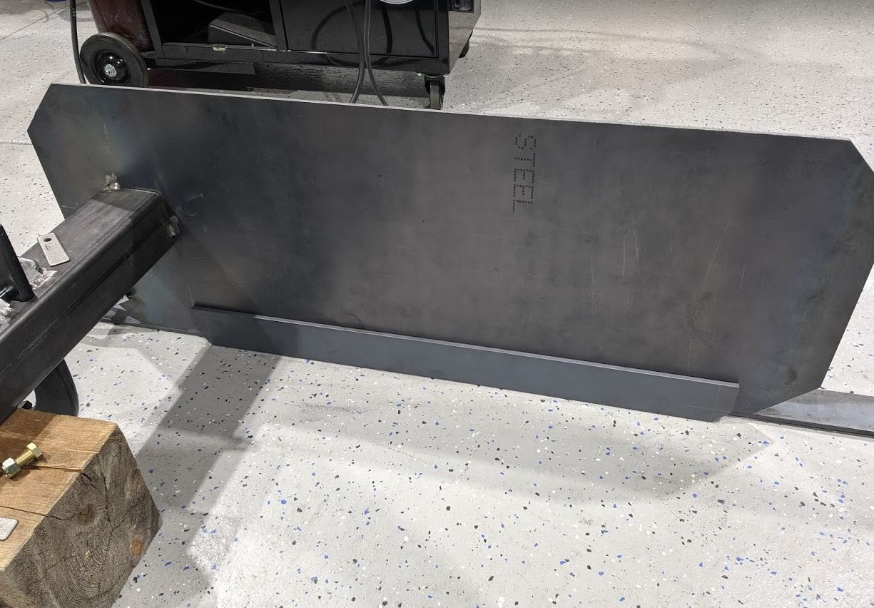

Looks like the leading edge of your blade is opposite from most. Just wondering.
/ Grader/Scraper Build #52
Maybe he is gonna use it in England,, where people drive on the opposite side of the road??
Many, (not me) believe the angle of the blade does nothing as far as moving material towards the center of the driveway.
If that is so, the direction of the angle is meaningless.
The angle is mostly there so that the blade will contact many "washboard ripples" , rather than riding up and down the ripples.
The build is looking great!! :thumbsup:
