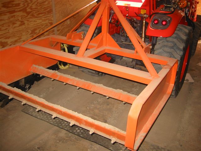

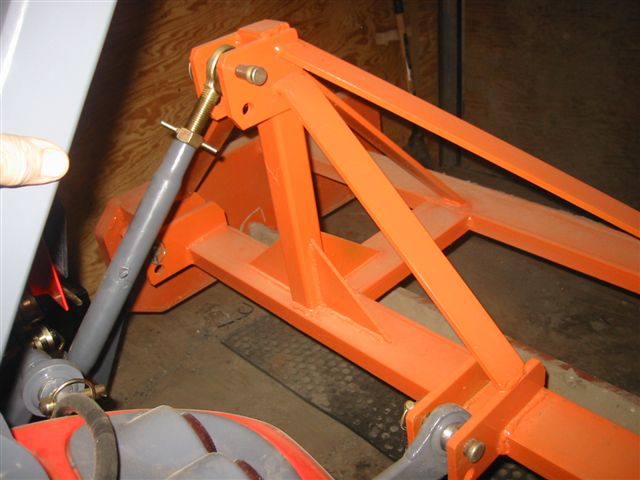

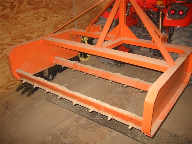

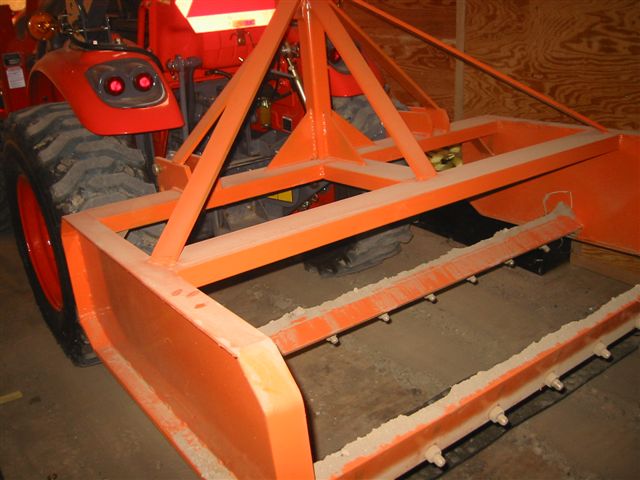

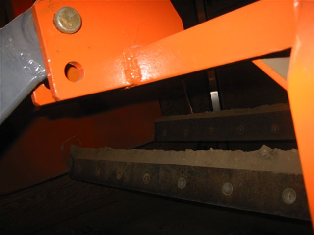

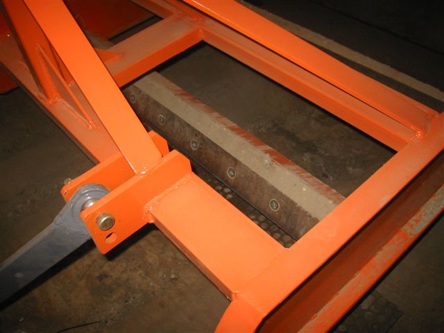

Well after reading all the information I have built a grader that works very well, the sides are 14 x 40 inches 3/8 plate, the edges are wrapped 2 x 3/8 flat and channel between sides, I used 4 x 1/2 flat to mount used grader blades on, the blades were worn out 7 footers from highways, once worn they scrap them, cutting them down to 49 inches and turning them over there is still life in them and the price was right, all other fabrication was scraps. Total cost well under $200.00 and 20 hours fabrication.

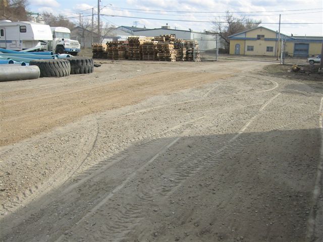

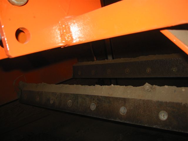

a few more pictures, one shot after using on the yard, it was orety rough, looking back I would have made the front blade angle less to facilitate it cutting easier, I may get the cutting torch out and burn a slot every couple inches sort of teeth. Next up is a tree planter, any ideas would be appreciated, for this grader I have notes used for construction if anyone wants them

Hi Brian, the weight is 350 to 400 pounds, the middle blade is 3/4 inch below the rails, set at 30 deg, the 4 x 1/2 has a 3 x 1/2 welded to form a angle, the front blade will take all the impacts, rear blade is level with rails. There is a aditional 2 x 3/8 tacked to the bottom, if it wears it can be easily replaced, my CK20 easily pulls it in third low and feel it could have been a foot wider with no issues, only thing I will do is torch some slots in the front blade about 2 inch apart, this will help the front blade bite however adding another 100 pounds may do the same, rocks in the ground are the issue but one idea is to add 6 adjustable teeth to cut in front of the blade maybe 6 inches from the front, this could be set about 3 or 4 inches down, it would loosen rocks and break hard ground.

Thanks for discussing the details. I'm building a grader and it's nice to know your thoughts. I am planning to notch the front blade like this \_/\_/\_/ and then follow with a straight blade, both set 3/4" deep.
