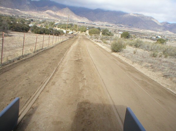

I maintain a little over two miles of common road and driveways that are on a very heavy clay and decomposed sandstone substrate. We have heavy winter rains in coastal northern CA, so maintaining proper drainage is important. For my situation my box blade is essential and the top & tilt makes it practical. I only use my landscape rake occasionally when I want the final finish to look especially good.

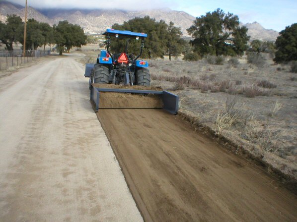

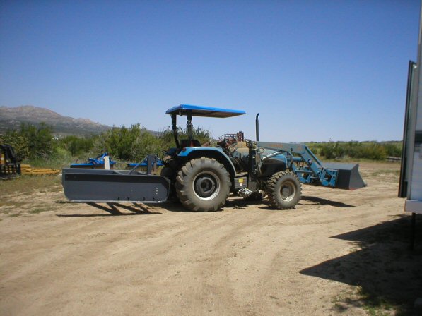

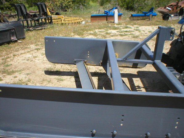

Do a search here, lots of opinions and info. The pictures are of what I use to maintain over 2 miles of roads.
Good luck with your search.
