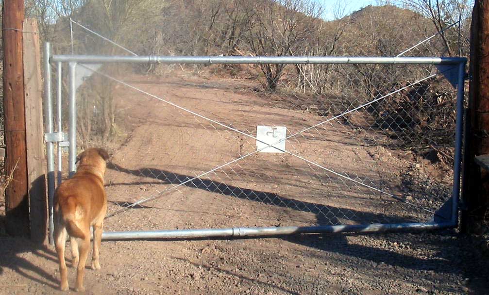

It sort of depends on the type of soil you have. In my part of the world, dry is dry and it just turns to powder if disturbed. So slightly damp is best.
Once graded stone is added and rolled in. More water and more rolling.
Picture is right after grading. Then gravel was spread, watered and rolled in.
