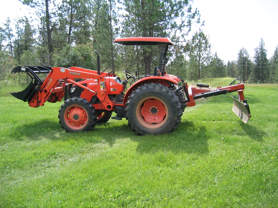

I have a mile long gravel driveway. It was constructed in 1982 and over the years it has become hard as concrete. Due to wind blown silt, volcanic ash, dust, etc. As currently set up - my Kubota M6040 weighs 10,100 pounds. I have Cat 2 implements for use on the driveway.
My 820# LPGS would be totally useless without its scarifiers. LPGS = land plane grading scraper.
To fix a pothole - LPGS with scarifiers set FULL down. Grind it up then level/smooth it out. Pack it down with the tractor.
If you can make minor repairs with hand tools - your driveway isn't really that hard - yet.
My Rhino rear blade - pictured - weighs 1100#. If I can get it started - IE... break ground - it will do a fair job of grading. Otherwise - I rely on the LPGS w/scarifiers to get a driveway problem corrected.
