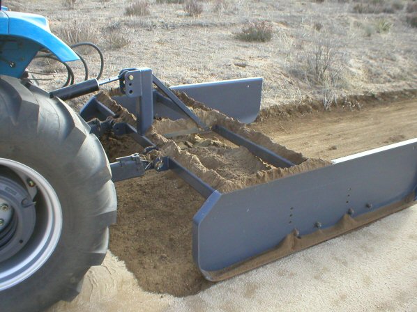

You will be best off with the 7 footer. You can always pick it up if it is too much at the time for whatever your conditions might be at the time. Weight is your friend when it comes to grading. You may want to look around some first before you buy. There are a lot of LPGB (land plane grader blades) out there to look at. Prices vary a lot, but you usually get what you pay for. I personally run a 7 footer that weighs in at 1400lbs, but my tractor is a bit bigger.
