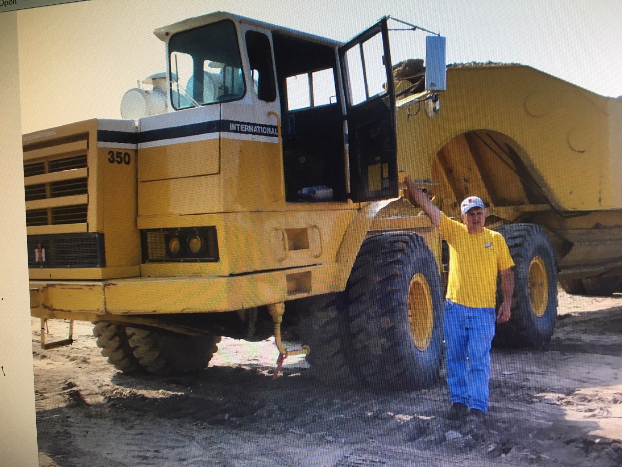

Todays pics show the parts for both tailgates now cut out, bent and welded in place. Also I made the support brackets to hang the tailgates. Today is the first day I attached both boxes to the frames and wheel assemblies. I bent and drilled some brackets and used 5/16" pins for the pivot points. I still have to build some lift cylinders for displaying the boxes in the raised position. That is a pic of me next to the old IH 350 PayHauler. I was in Grand Haven , Michigan and got to run some old machines for a afternoon. Next week I will get going on bending the frame for that truck model. That will just have a dump box on the back.

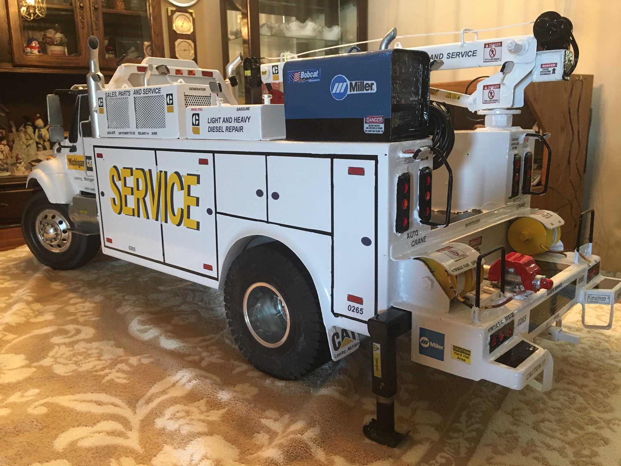

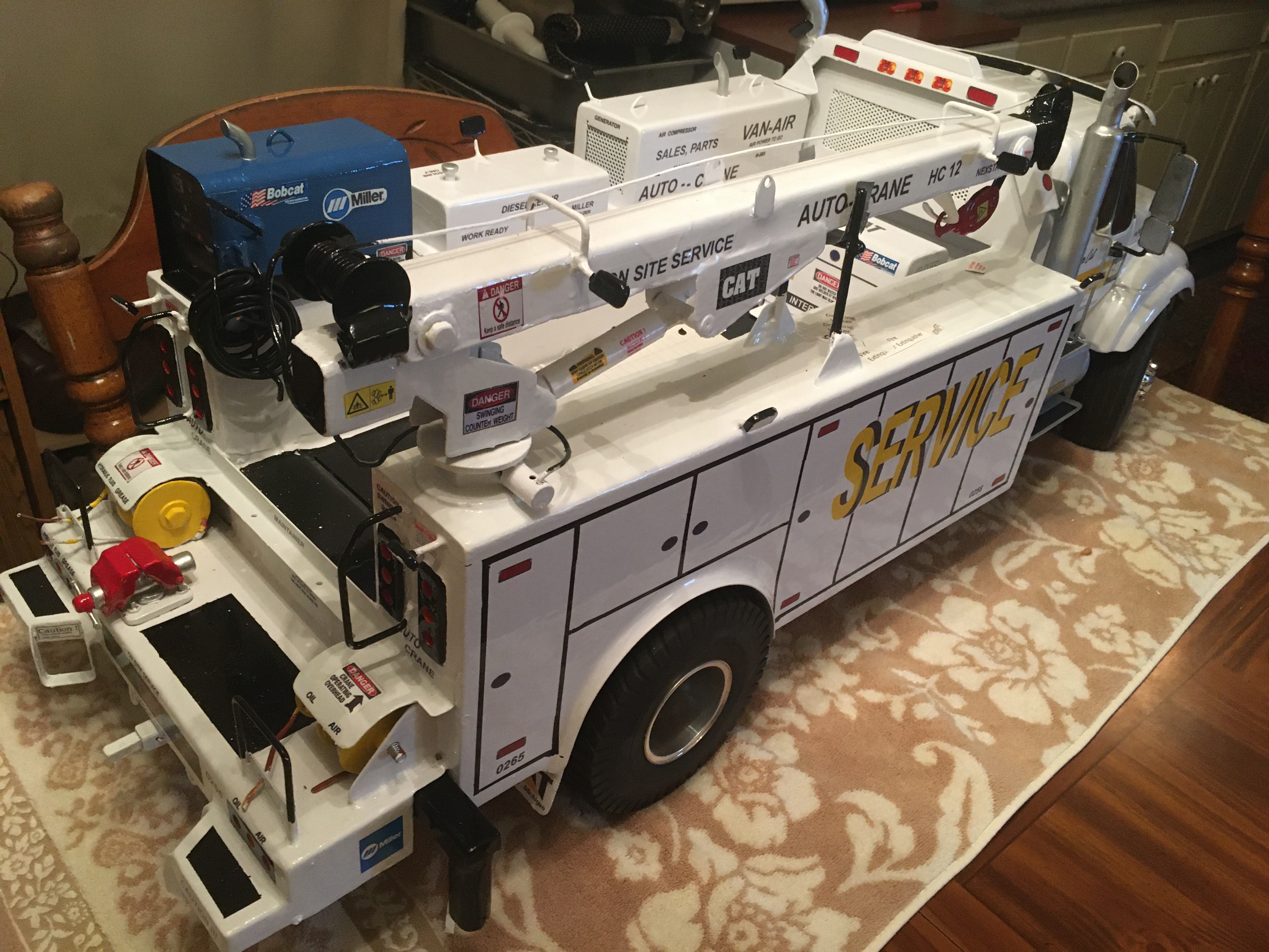

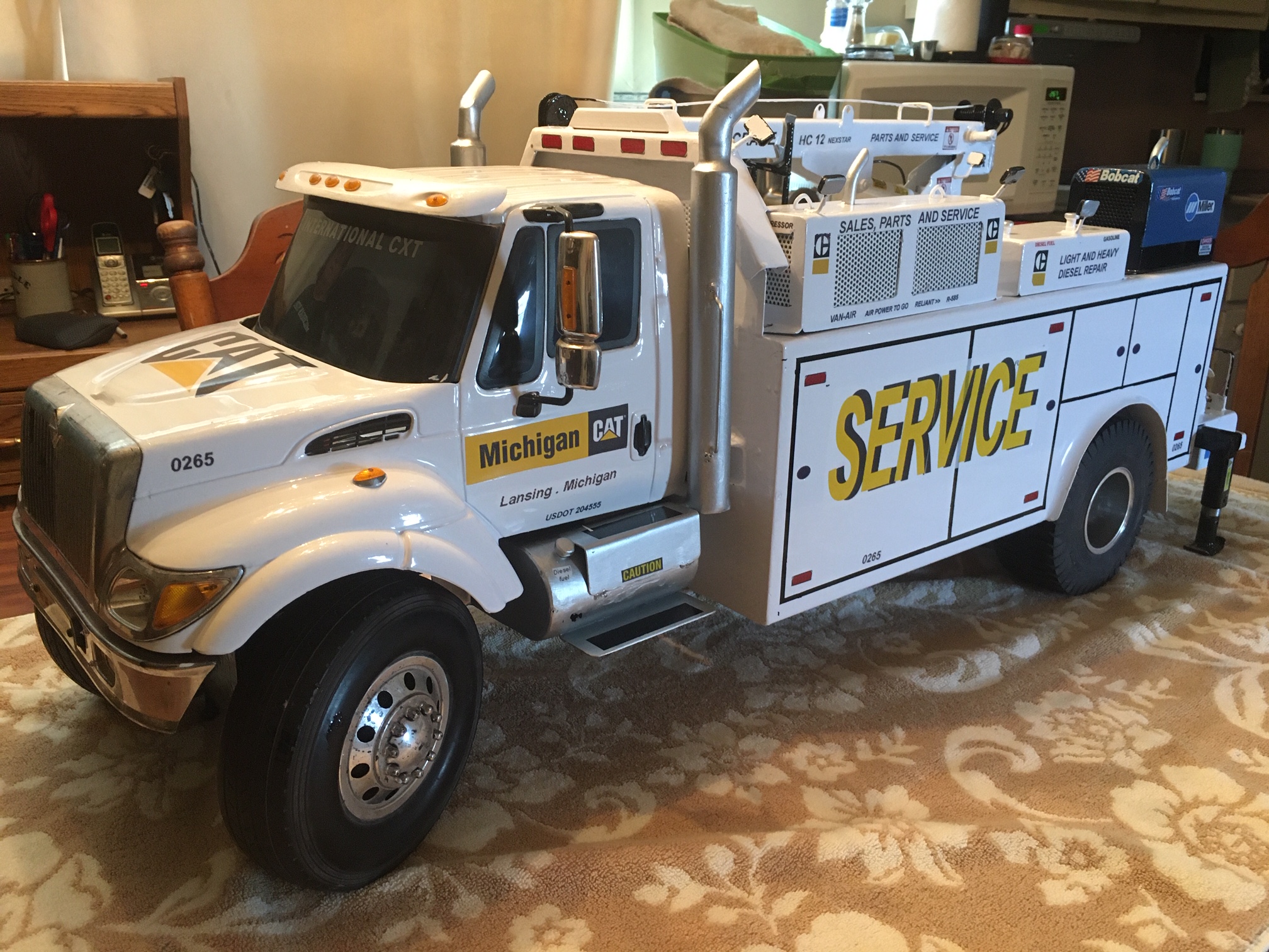

Been enjoying time in the shop and here are three progress pics of the service truck model I am fabricating . Very pleased how it is looking . Got a few more things to fabricate and add .CAT NEW 1.JPGCAT NEW 2.JPGCAT NEW 3.JPG

I thought the same thing as I was posting previously. The only giveaway is the phone and coffee mug of pencils in the background.
   / grain truck , service truck projects #19
That looks just like the real thing.
Aaron Z
I thought it WAS the real thing until I saw the microwave in the background ! Great job Waldon52 !
   / grain truck , service truck projects #20
Been enjoying time in the shop and here are three progress pics of the service truck model I am fabricating . Very pleased how it is looking . Got a few more things to fabricate and add .View attachment 641630View attachment 641631View attachment 641632
That is truly amazing! I cannot express how really impressed I am. Could you please post some more detailed pics, including maybe another person in the picture to get a real perspective? I'm guessing it's about a 1/4 model?
